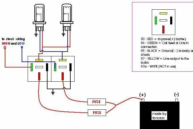

    Hi all.
    I want to fit some spot lights to my 2017 Tiger Sport and need a switched live.
    Does anyone know where I could get a wiring diagram or have easy suggestion where to connect up to under the seat ideally.
    thanks in advance

    Are you talking about auxiliary main beam or daytime running lights?
    Either way, but particularly if you intend conventional beams, you could splice into the headlight feed to actuate a relay while feeding the additional lights on heavyish cable from the battery. It maximises brightness.
    https://m.wikihow.com/Install-Spotlights-on-Your-Vehicle
    Using the headlight feed obviates the need for a separate switch.

    Does this help?
    If you need to isolate them fit a separate switch on the auxiliary light Earth.

    it is for a set of Denali spotlights where I have a full decent wiring loom; in terms of the relay, is this an existing relay as there are a couple under the seat and I am new to bike wiring :)
