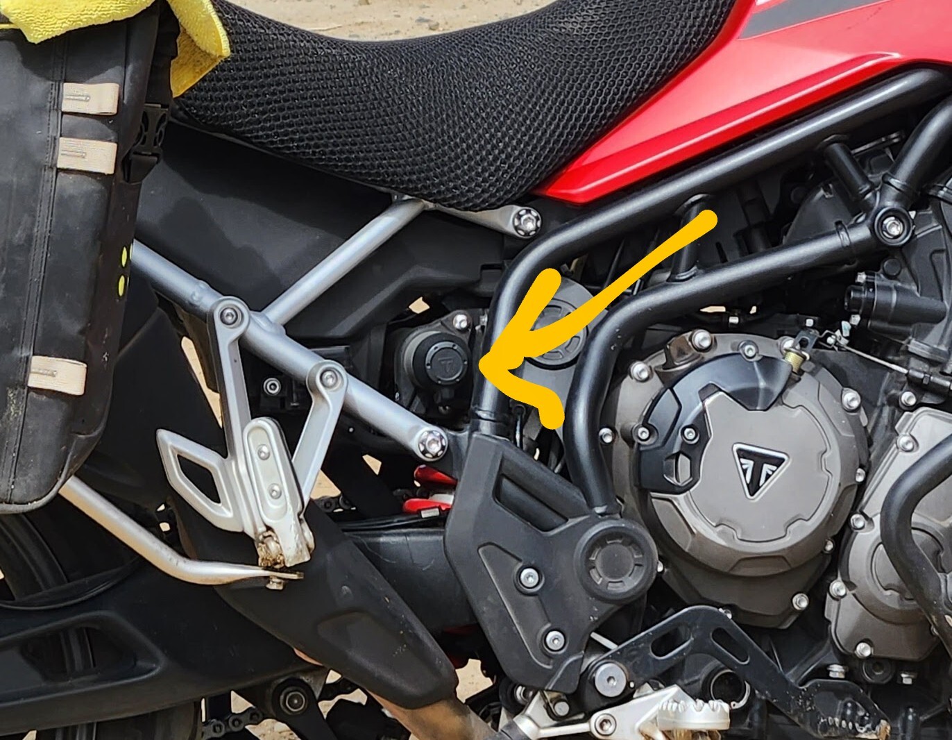

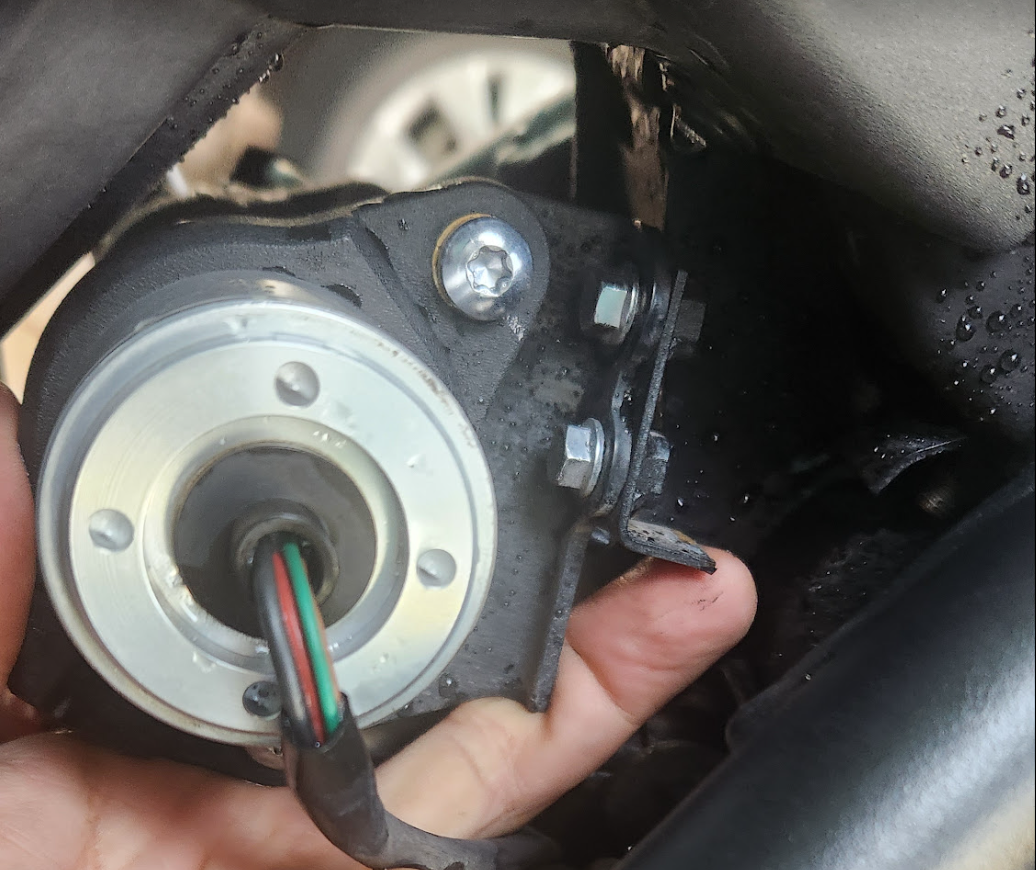

    I was washing the bike when I noticed the motor for the rear suspension in an unusual position
    the motor is kind of heavy to be hanging from the flimsy clamp, it broke both sides from these 2 positions
    the bracket is soldered to the chasis ...
    and my bike is out of warranty
    so ... time to get creative , good thing the location is fairly accesible
    some of the broken ends are starting to rust and I've been complaining at each service about an odd clanking noise in the rear suspension, this might be it

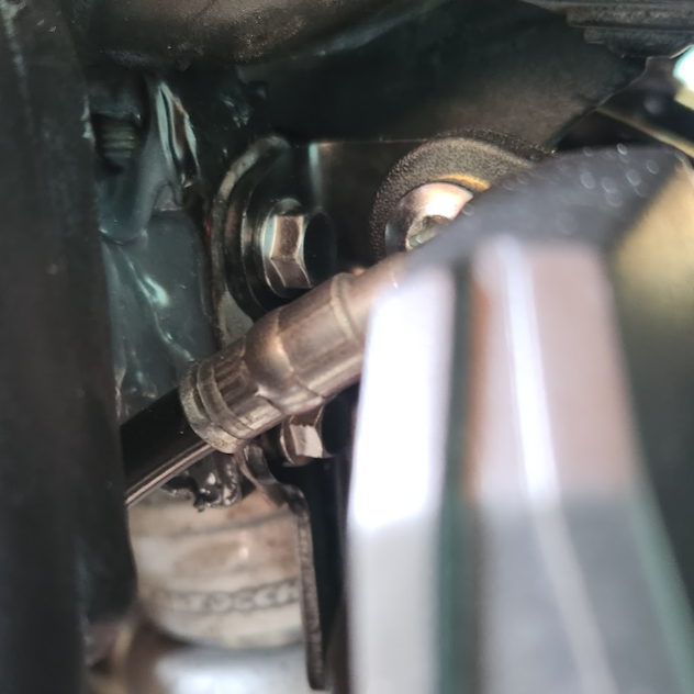

    back in place
    will it hold ? time will tell
    threading the bolts in such cramped space tested my patience

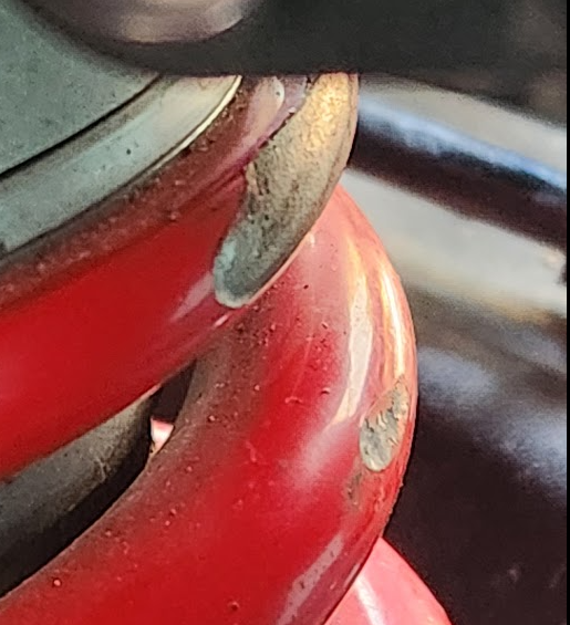

    I do not know since when this ws hanging loose
    the rear spring is a bit scratched
    Used zip ties to hold the motor while screwing things together, there is the area that the motor banged against the spring
    I did a test ride and everything is working , preload, etc

    this cover got lost , will see if it can be order

    I was able to order the spare cap, lead time 6 weeks :confused:
    I spoke with the main mechanic he mentioned those caps are often lost and recommended using some silicon when the new one arrives
    About my fix he did not seem to optimistic it will last, and mentioned that in order to weld the support back in place half of the bike has to be dissassembled
