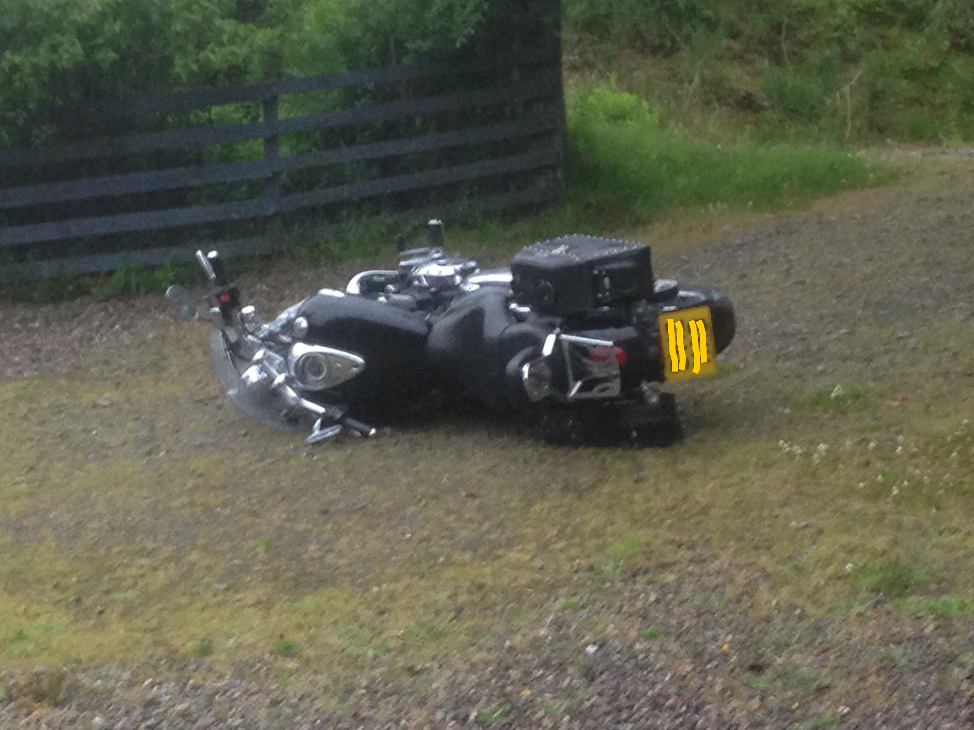

    She may look like she is having a rest after a ride out but due to the gradient on the track she went over as I was reversing her toward the garage. Joy.
    Busted indicator lens & bent gear shifter. Minor scratches on screen & tank.
    All the fluid levels seem to be fine but is there anything else I need to be aware of before I take her back out? Thinking being on her side is not good for such a big bike.

    Get yourself some engine bars - stops it falling horizontally. Check bars and securing bolts, then anything obvious.

    Serious thoughts about engine bars. Trying to lift her whilst flat on the ground and the gradient against you was fun - channeled the angry green superhero (then asked the wife for help).

    You will find them invaluable not only protection but also to pick up.
  5. MrOrange
    Mainly fluid levels need checking. If you left it on its side long enough, you might get some oil in the bores, but do no harm, bit of smoke on start up.
    Brake fluid reservoirs can leak, just clean up any leaks, make a mess of paint if it has leaked.

    No permanent damage, just a slow topple with the crunch of breaking indicator lens. All the fluids were fine, no leakages. I have noticed tho that since then, when I fire up the ignition it starts to rain ..... do Triumphs have some form of climate control and the fall damaged it?
