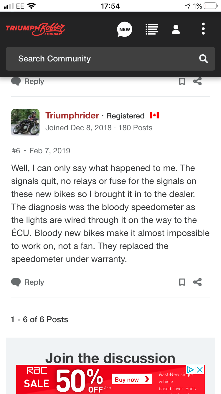

    54B50E70-4A77-45AF-9DCE-EFE923FCA3ED.png According to this post there is no relay, the ECU controls the indicators?

    Could be bad news Hal?, ref attached photo
