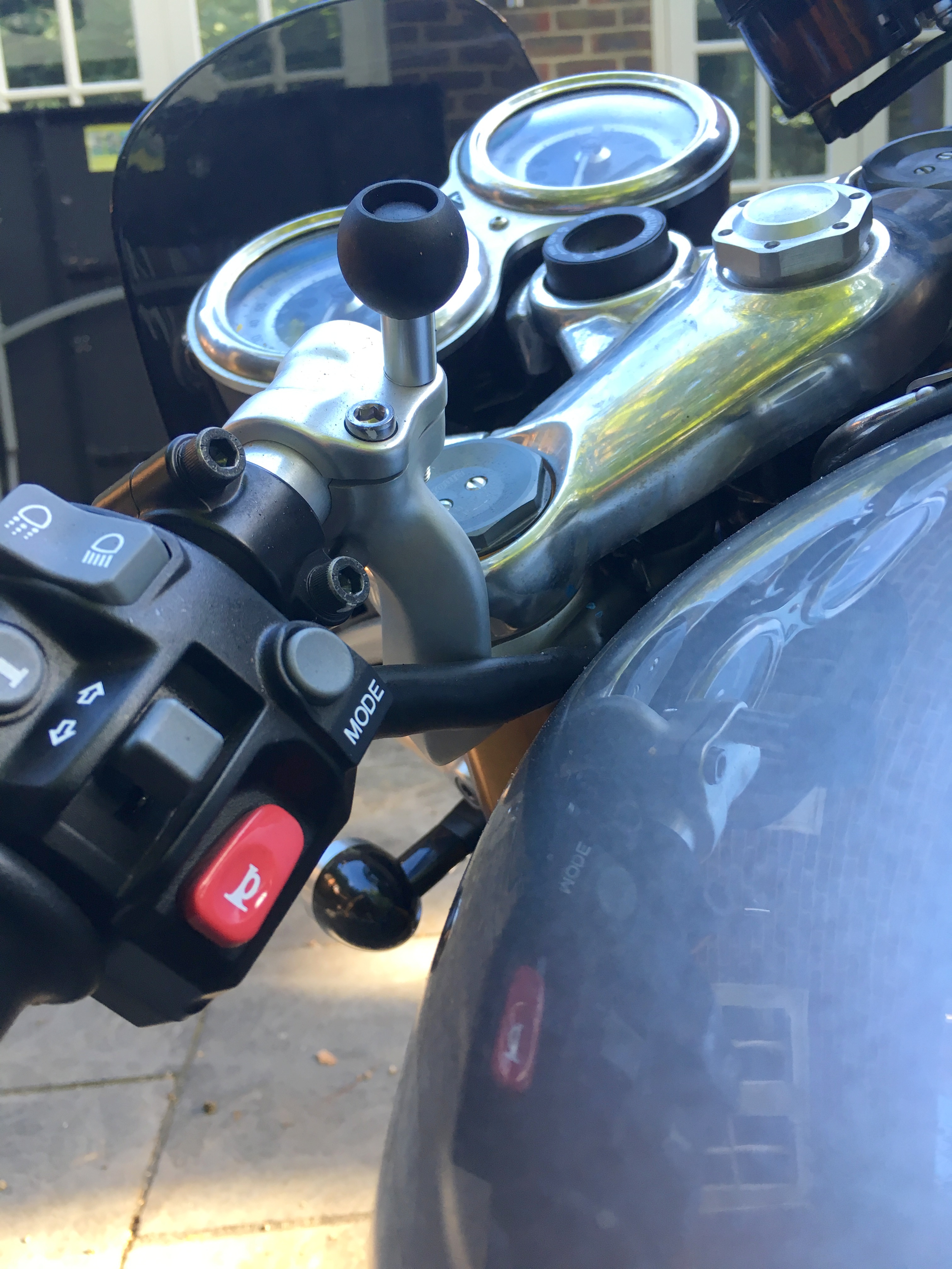

    Looks like you've customised your stem nut, is that for a satnav? and which nut is it please?
    ta
    Gilesy

    Hi Giles - actually that's just a generic pic of a thruxton I found on the web - although I do have an attachment for GPS - see attached images. You need a RAM bolt attachment. It's very easy - just replaces one of the bolts on the handlebars (and it comes with the correct bolt - you need pick the M6 option). See here:
    https://www.amazon.co.uk/gp/product/B00ET28G2Y/ref=oh_aui_detailpage_o04_s00?ie=UTF8&psc=1
    Then you just need a case to fit on depending on which phone you have. I have an iphone 6 so got this
    https://www.amazon.co.uk/gp/product/B00ZP7OX6K/ref=oh_aui_detailpage_o03_s00?ie=UTF8&psc=1
    You just unscrew the case when you don't need it - takes a matter of seconds. And if you want to charge the phone on the go, just run a lead over the tank beneath seat to the USB charger
