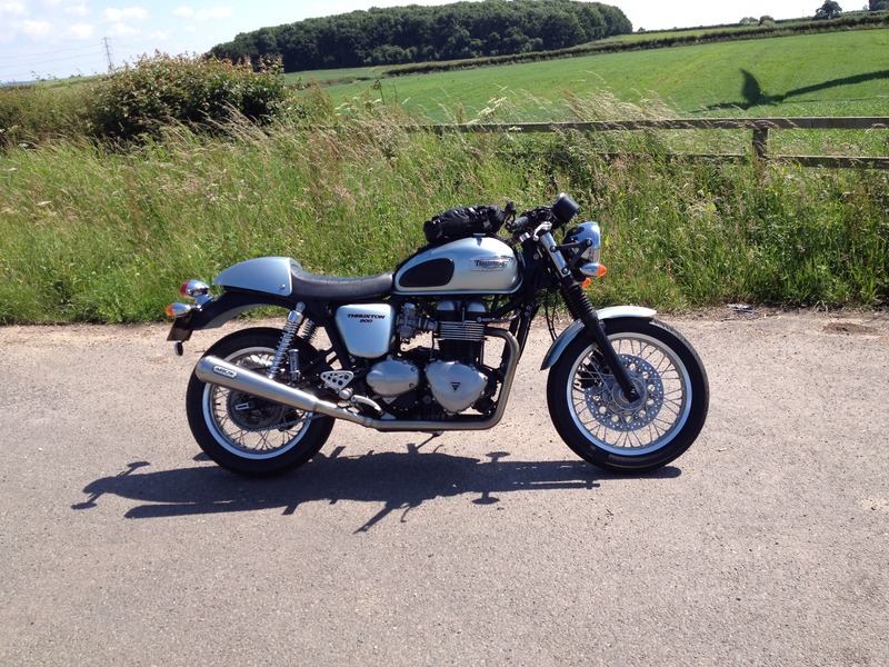

    Finally got things sorted. Took off the original bar end mirrors and fitted a much smaller version with a convex lens sourced new from eBay for £20.
    This is what I found when I removed the originals. There is an interference collar which makes the fit very snug.
    http://s161.photobucket.com/user/d15nel/media/Thruxton/IMG_0836_zps9rafddgh.jpg.html][​IMG][/URL]

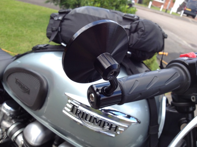

    The new mirror comprises a bar end weight and then the mirror stem can be inserted either into the end or onto the top. I chose the top position.
    http://s161.photobucket.com/user/d15nel/media/Thruxton/IMG_0830_zpsb3gcc5gl.jpg.html][​IMG][/URL]
    The set up is a bit fiddly as you have to position each component before attaching and adjusting the next part which involves a bit of trial and error to set the best adjustment. I was fortunate that I didn't need the expanding inserts as the Thruxton bars have a fixed threaded insert which the M6 bolt of the new kit fitted into. I did pack out the internal with a short section of hosepipe to add a bit of 'filler' and reduce the chance of any vibration.
    A short test run confirmed that all was OK and I'm very pleased with the new look.
