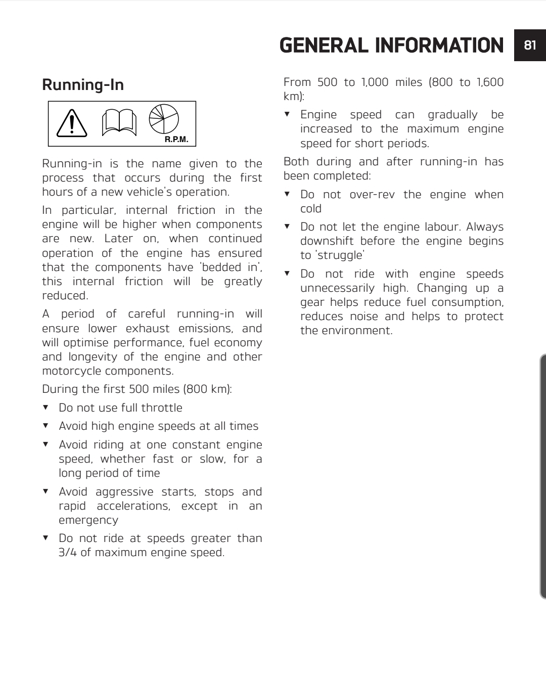

    Avoid constant throttle, work the engine so it gives the rings chance to bed in.
    Avoid excessive rpm but also avoid labouring the engine in too high a gear.
    There are no magic numbers really, just mechanical sympathy and a good dose of common sense.

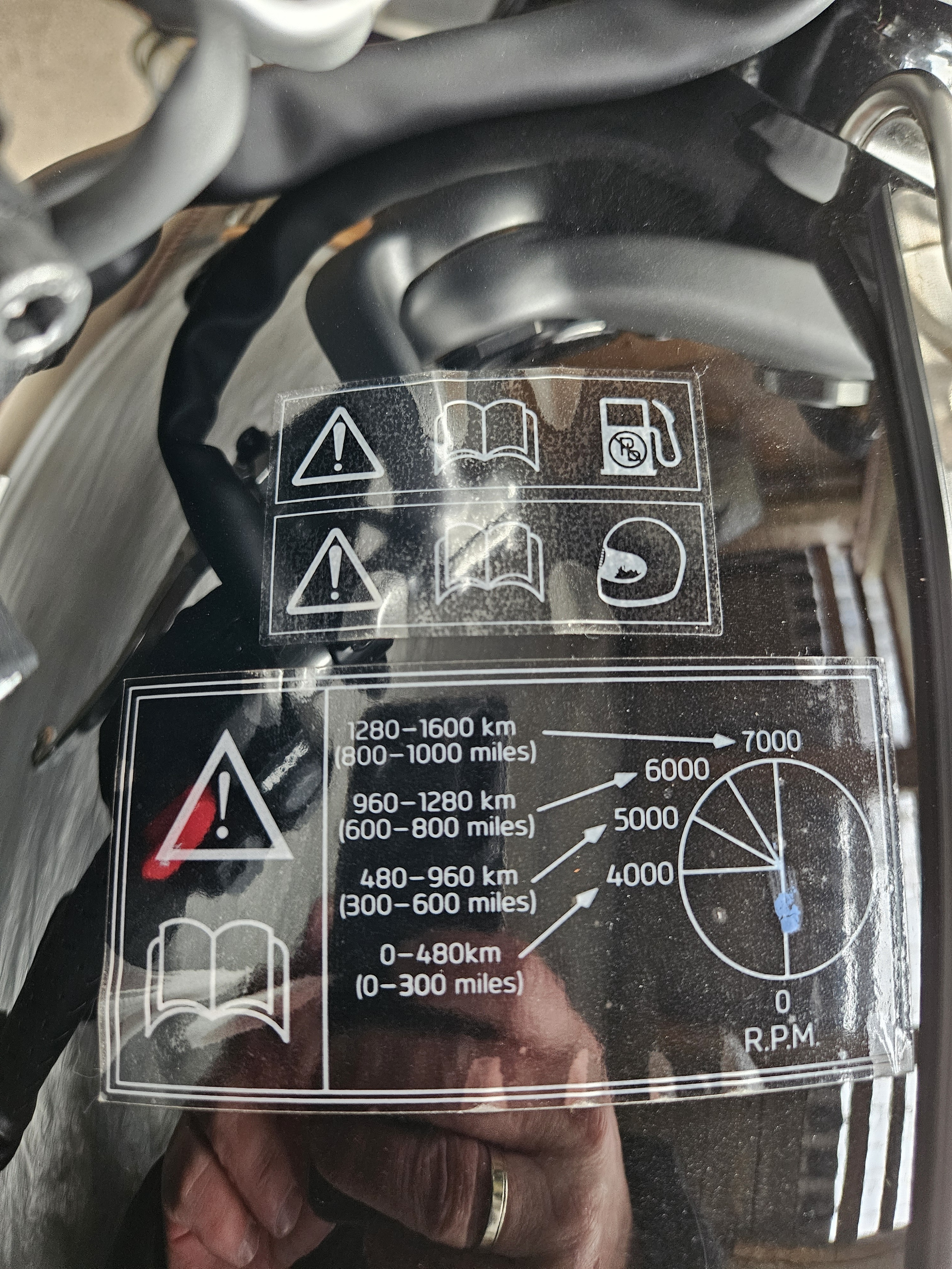

    It was on the sticker on my tank when I got the bike from new. As Eldon said use common sense, don't baby it but don't rev the nuts off it either. I had a Thruxton 1200 before the Speed Twin and the motor seemed to really settle down after about 5,000 miles.

    There's nothing mechanically special about a Thruxton RS, it's just a bike with an engine. Don't labour it in high gears and don't treat it like a baby. The guidance in the user manual is just that, don't be afraid to go over 4k briefly for an overtake etc.

    Thanks again you were right there is a sticker on the tank
  12. P.T.
    P.T. New Member
    May 4, 2021
    20
    Norway
