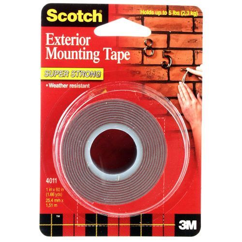

  15. OsteKuste
    Oct 22, 2017
    2,197
    943
    Tennessee, United States
    I used this 3M double sided tape. It’s the same stuff used to mount body trim on auto exteriors. The tape is a dark grey with a removable red backing. It was a bit fiddly but I first cut sections to go all the way around the pad, then trimmed them down very close to the edge of the pad with a razor knife. Cleaned the tank of any residue including wax, and mine have not moved a bit.
