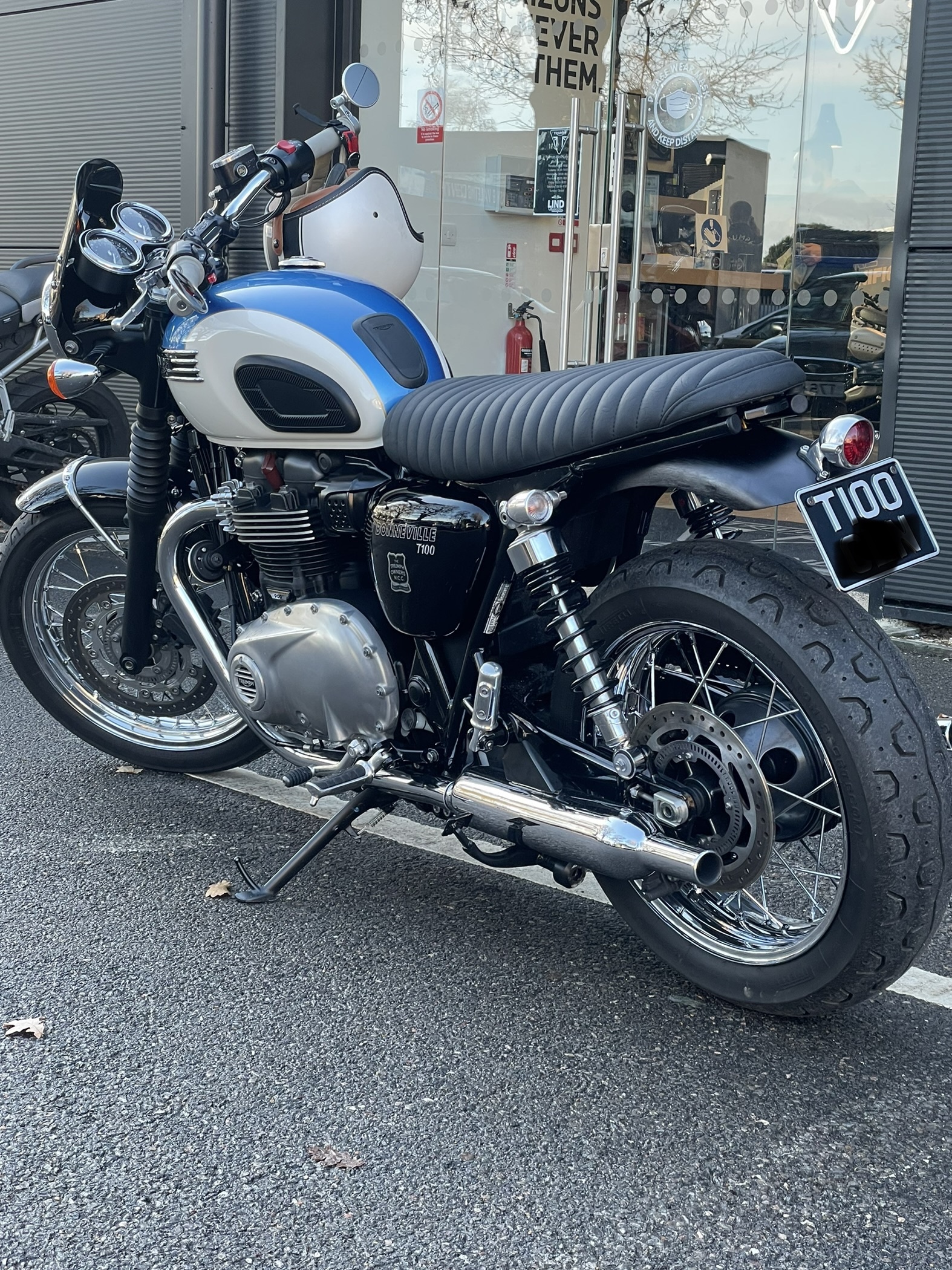

    Motone will have everything you need. Lights included, plug and play no splicing needed. I did my rear recently using all their parts. I removed my grab rail for a cleaner look but the stock grab rail would not fit my set up as it would hit the rear light I added from Motone. However if I had wanted to keep a grab rail then they also stock one called the love rail that would have been compatible with my set up. Highly recommend you look at their website under T120 LC , you will find everything you need 14C5C076-ACC8-4871-9DF9-C5915C651FA2.jpeg

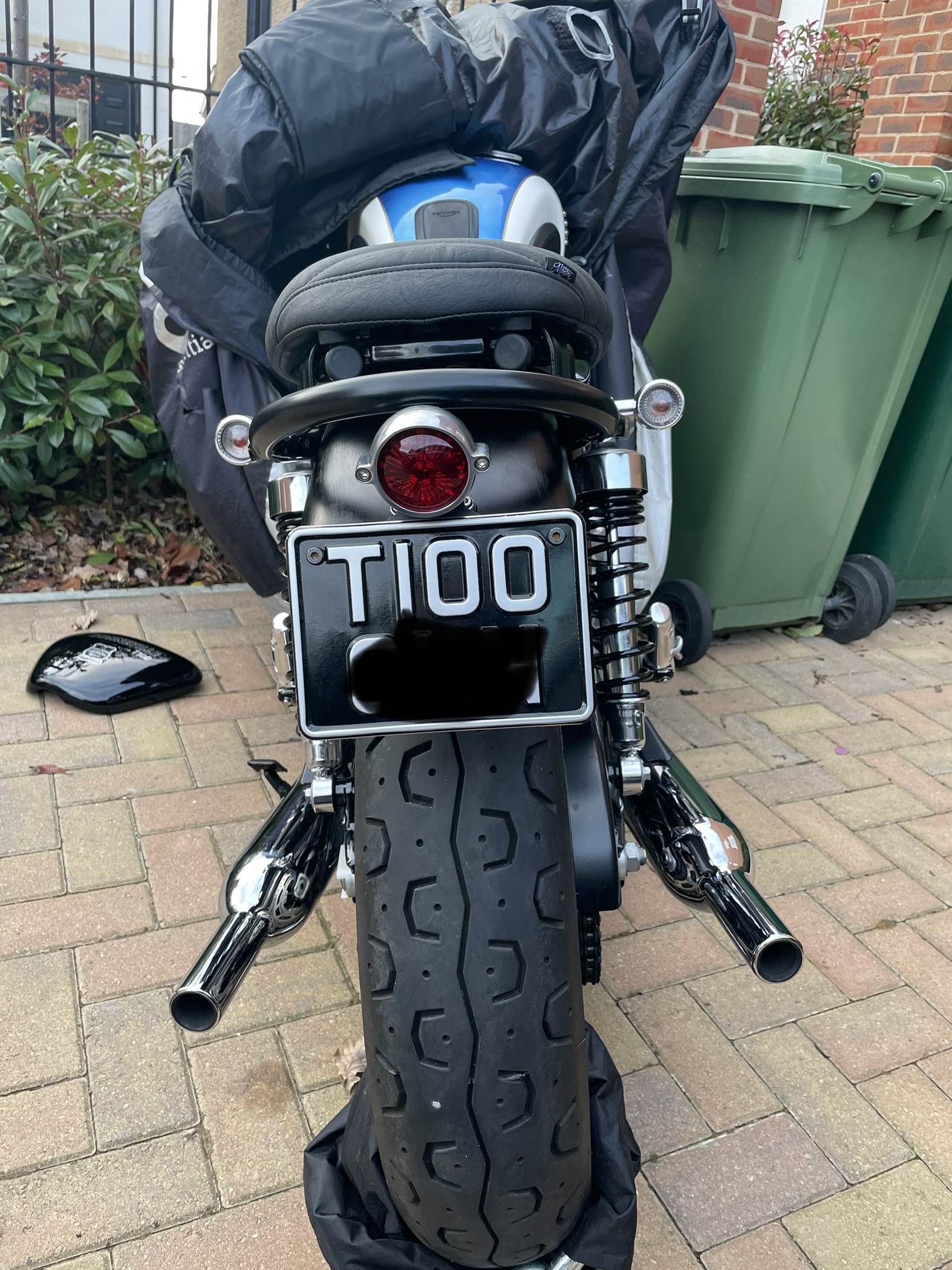

    I found they respond via instagram quite quickly. Only today I asked them a question as I was fitting some headlight brackets and they got back to me immediately.
    If you did place your indicators like I have done on the rear shocks the grab rail will clear but will be tight on the rear light I purchased. I actually have a photo that I took when installed and left the stock grab rail on. Motone also do other indicators brackets that fit under the seat and are further forward than placing them on the rear shocks

    I'll try Instagram then - Real nice bike by the way - I like your set-up - and really helpful to see the pics of the grab rail etc - I was hoping that if I went for the Long Reach (rather than bobbed) option on the fender, it would allow more room for the rear light to clear. Thanks again, much appreciated.

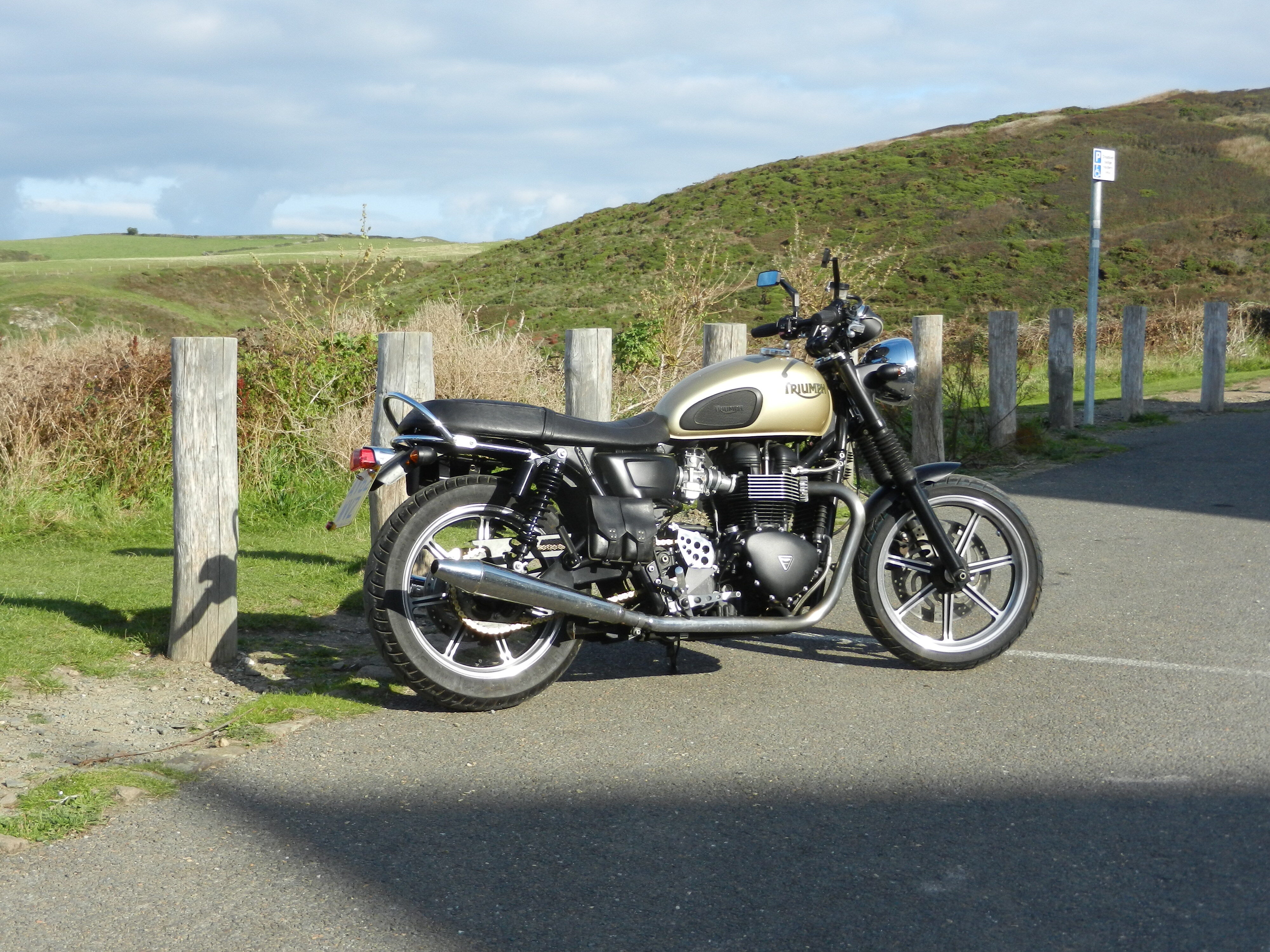

  9. Essexboy
    Essexboy Active Member
    Apr 16, 2017
    195
