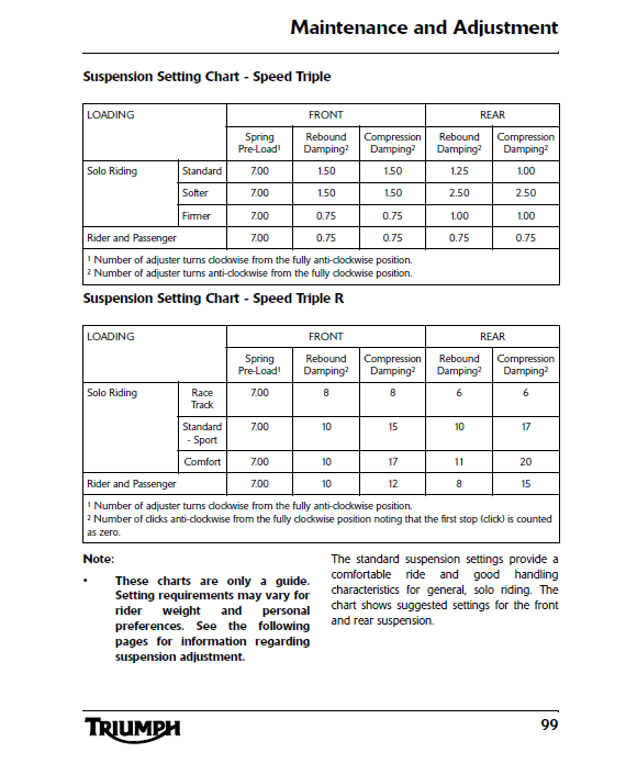

    May be it's a misprint.
    This is what is in the manual for the 2015 SpeedII.
    We should be able to download the owners manual off the Triumph web site but just tried and it's not playing for me at the moment. :mad:
    I think suspension for the R is supposed to be unchanged on the new model (but that's not to say there are minor tweaks they think no one would notice)

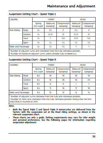

    Forgot I'd downloaded the 2016 manual a few months back, and yep says what you say.
    Also noticed some of the pictures are of the previous model......:rolleyes:
    I wonder if the downloads are unavailable 'cos they're out for corrections.

    Hmm those settings are completely different to my hand book, I think the suspension is the same unit on 2015 & 2016 model
