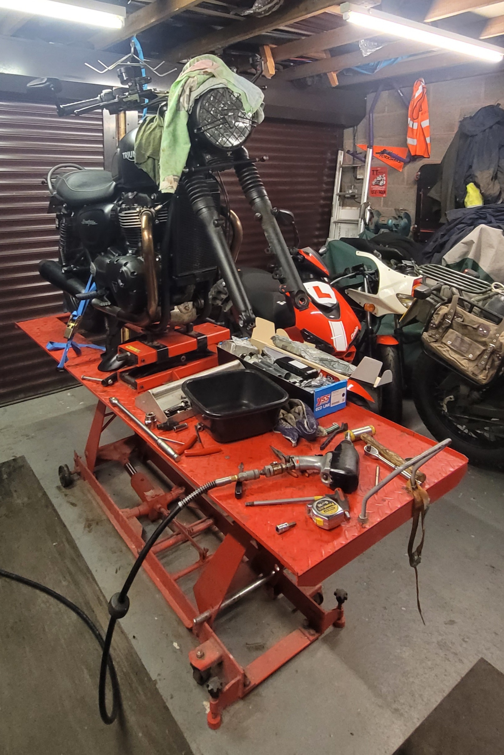

  16. Eldon
    Eldon Elite Member
    5,977
    Do you think the brake upgrade will achieve much?
    This is my ST today undergoing YSS fork internals upgrade including emulators.
  17. beerkat
    beerkat Senior Member
    Aug 14, 2019
    858
    Cheshire UK
    Yes I do. From day 1 I felt that the Street Twin brakes were underpowered. One twin-pot caliper trying to haul down 300kgs (bike + rider) from 100+mph doesn't sound good on paper and in my opinion doesn't work well enough on the road. My 3 Jap bikes all weigh significantly less and have more than twice the stopping power. Up to a point I've got used to it and ride accordingly, but there are occasions when rapid braking is required and the Street Twin could be better. I've tried the pad swop and maybe that made a slight improvement but a 4-pot caliper on a floating disc has got to make a bigger improvement.
    Strange how Triumph came to the same conclusion in 2021 and made exactly that upgrade.
