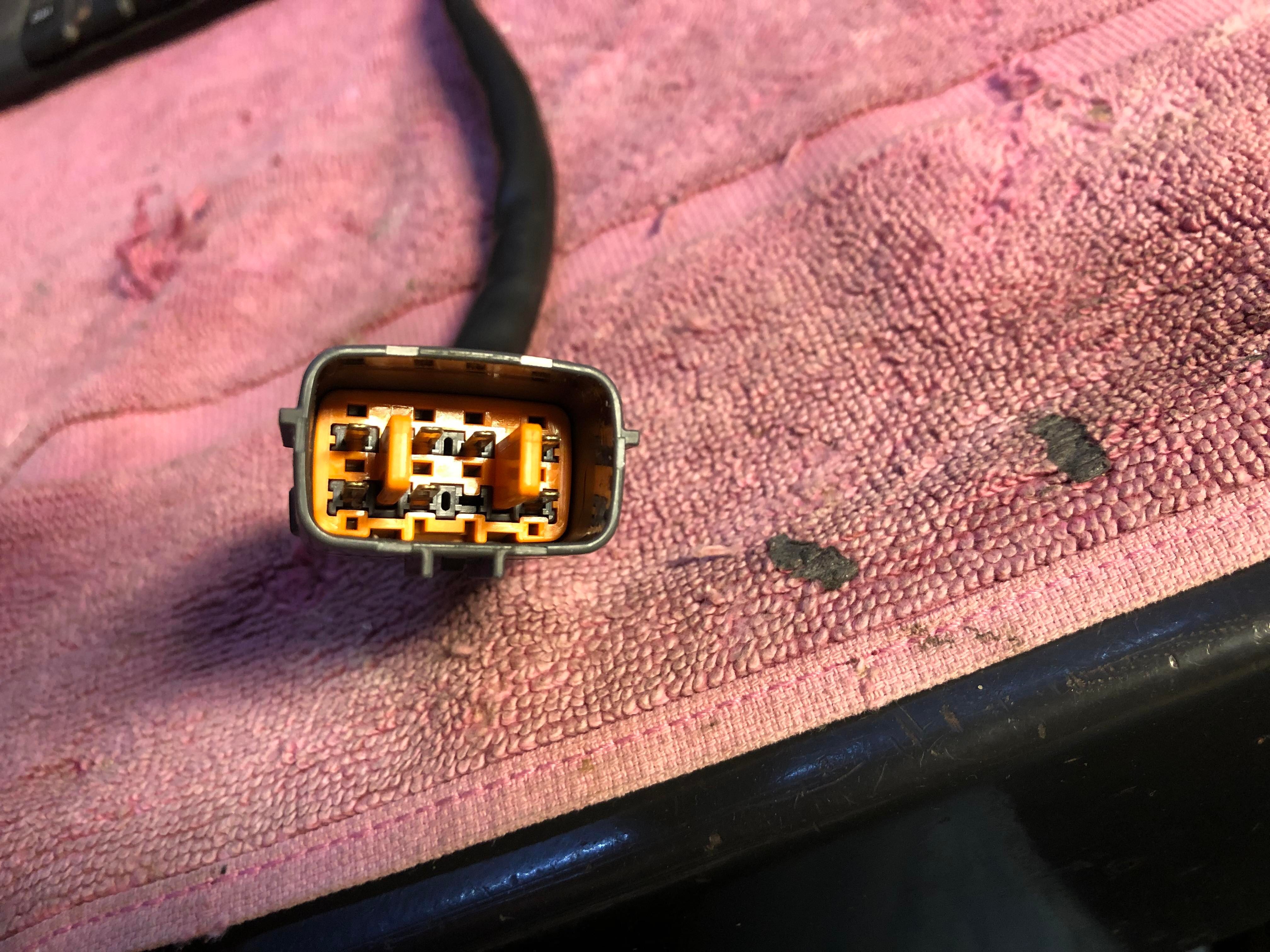

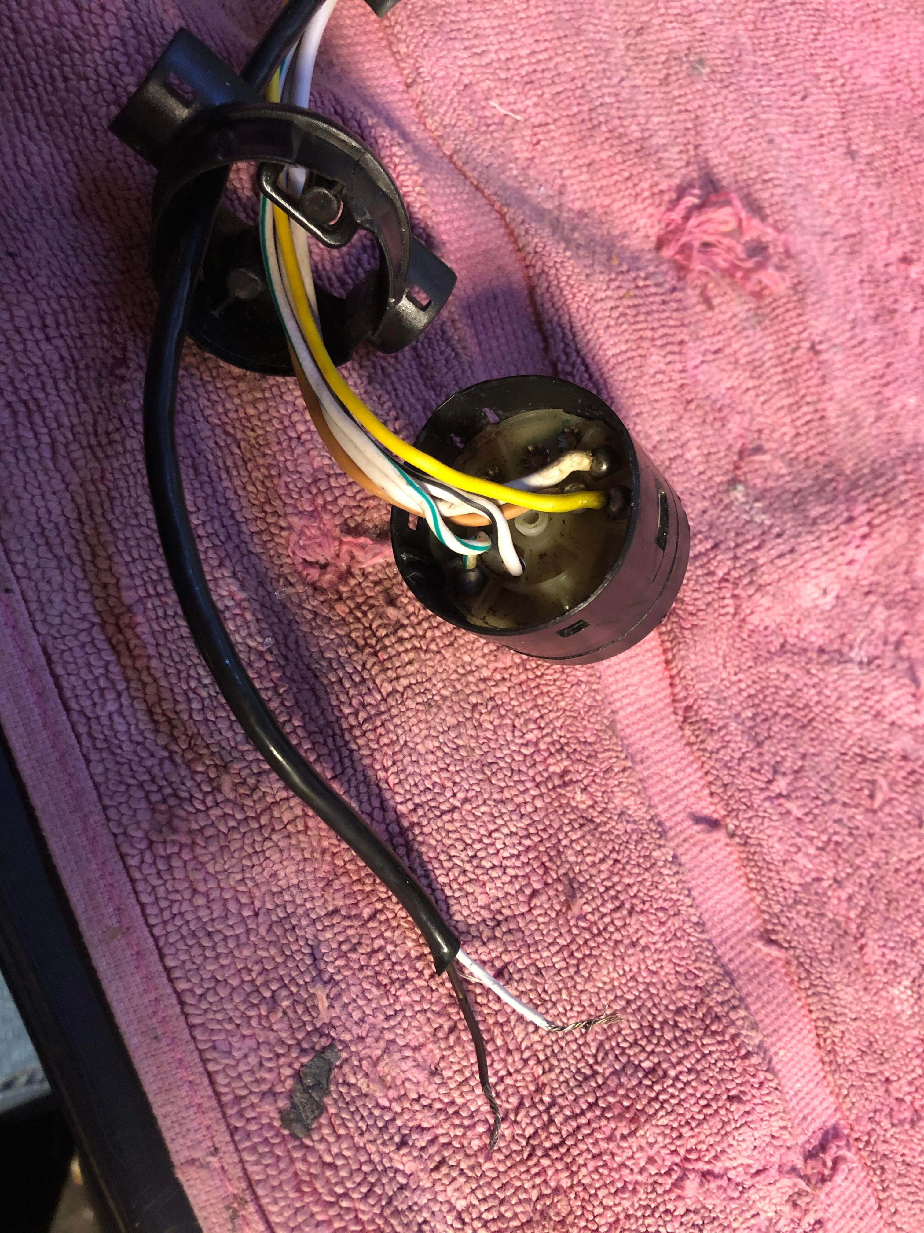

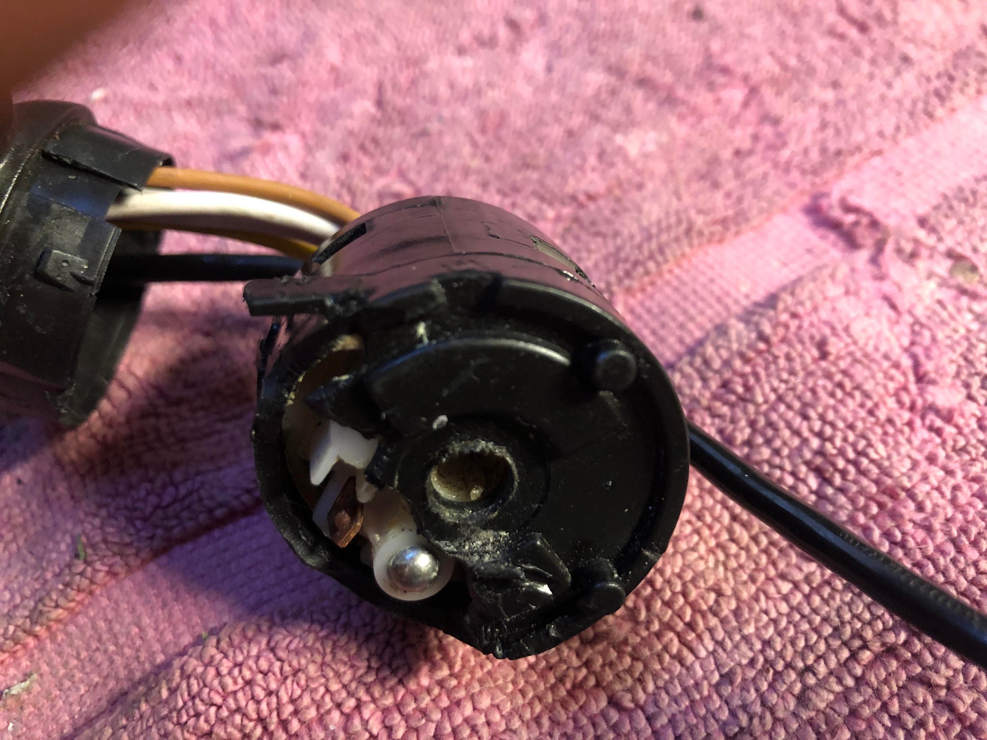

    Hey all,,Thanks for accepting me into the forum,,Ok here goes first post,,I had a 2018 Triumph street triple 765 RS stolen off me 5 weeks after I bought it and got payd by insurance,,They recovered the bike recently and I had the option to buy it back which I did,,But the ecu and fuel pump was missing (have since replaced) and the ignition barrel is a bit busted,,Now Ive plugged everything in and all I get are headlights and tail lights,,no power anywhere else,,no dash either,,the barrel is only the bottom part which can be turned with a screwdriver and has 2 wires hanging to nowhere,,white and brown skinny ones,,I cant find any info as to where they would go,,now I dont have a key anymore as I didnt think Id need to keep it,,so tell me do i need a whole new ignition with key,,what else would i be looking at getting,,Any help would be much appreciated,,I just wanna ride it again,

    If possible, pics always help if you have them?
  3. Rexdrumer
    Rexdrumer New Member
    Dec 29, 2021
    2
    Gold Coast Australia
    Couple of pics of the ignition barrel
  4. Rexdrumer
    Dec 29, 2021
    2
    ignition
