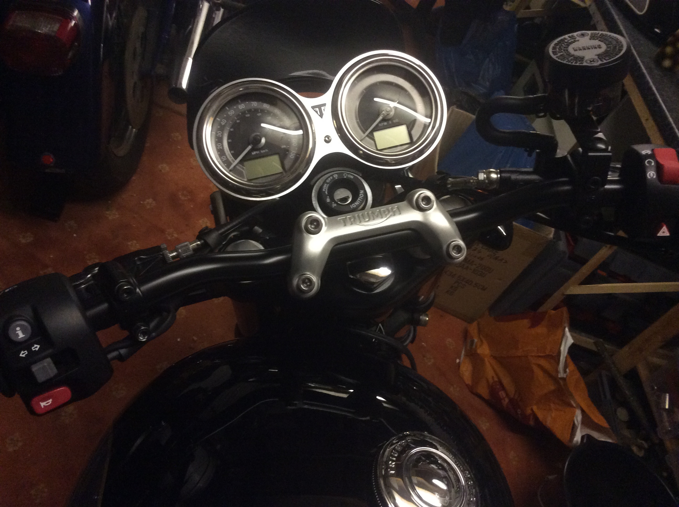

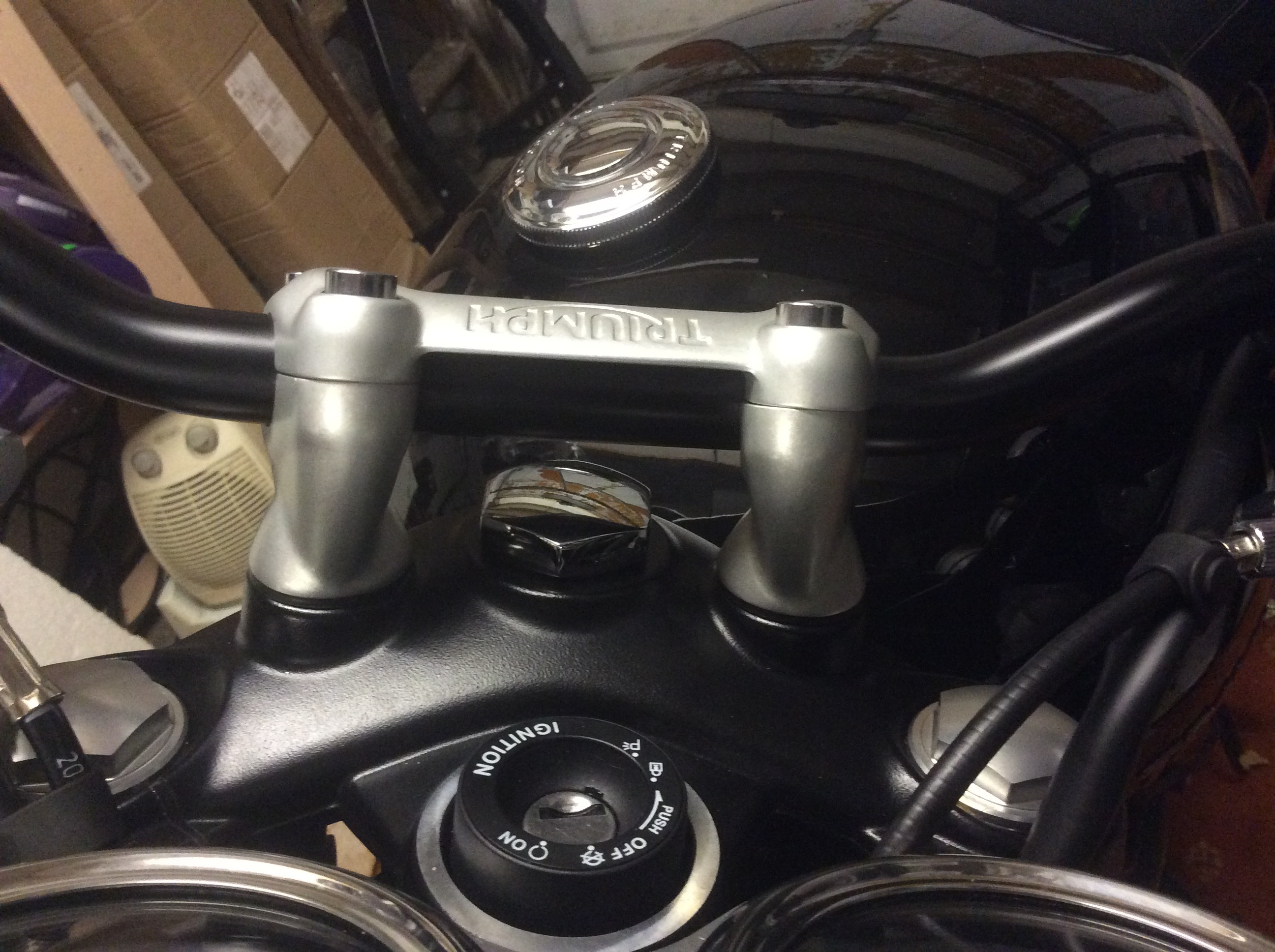

    I’m not sure to be honest, I bought the bike from new and they fitted the bars for me. Would you like me to take a pic for you to look at? You would probably have a better idea than me.

  7. Dave61
    Dave61 New Member
    Sep 4, 2017
    16
    England
    D48C9B5F-ECDD-4BEA-9AEE-B16E1B4A2154.jpeg 90028776-0B34-45C7-8F38-0F83E025ED77.jpeg 9708F287-719A-4387-9C6D-84F6DDB2CD93.jpeg
  8. Celticages
    Celticages Well-Known Member
    Oct 9, 2017
    75
    New Hampshire, USA
    This looks fantastic! I know it's what I want to do now. Can I ask approx. how much they charged you to do that? I believe those are the 7/8" risers to go with the Street Twin bars.

    There was a deal on which was about £500 of extras. I had the bars fitted, Street Twin seat, grab rail and a deal on ‘bike track’ Also it looks as if I posted the same pic twice, so will try again.

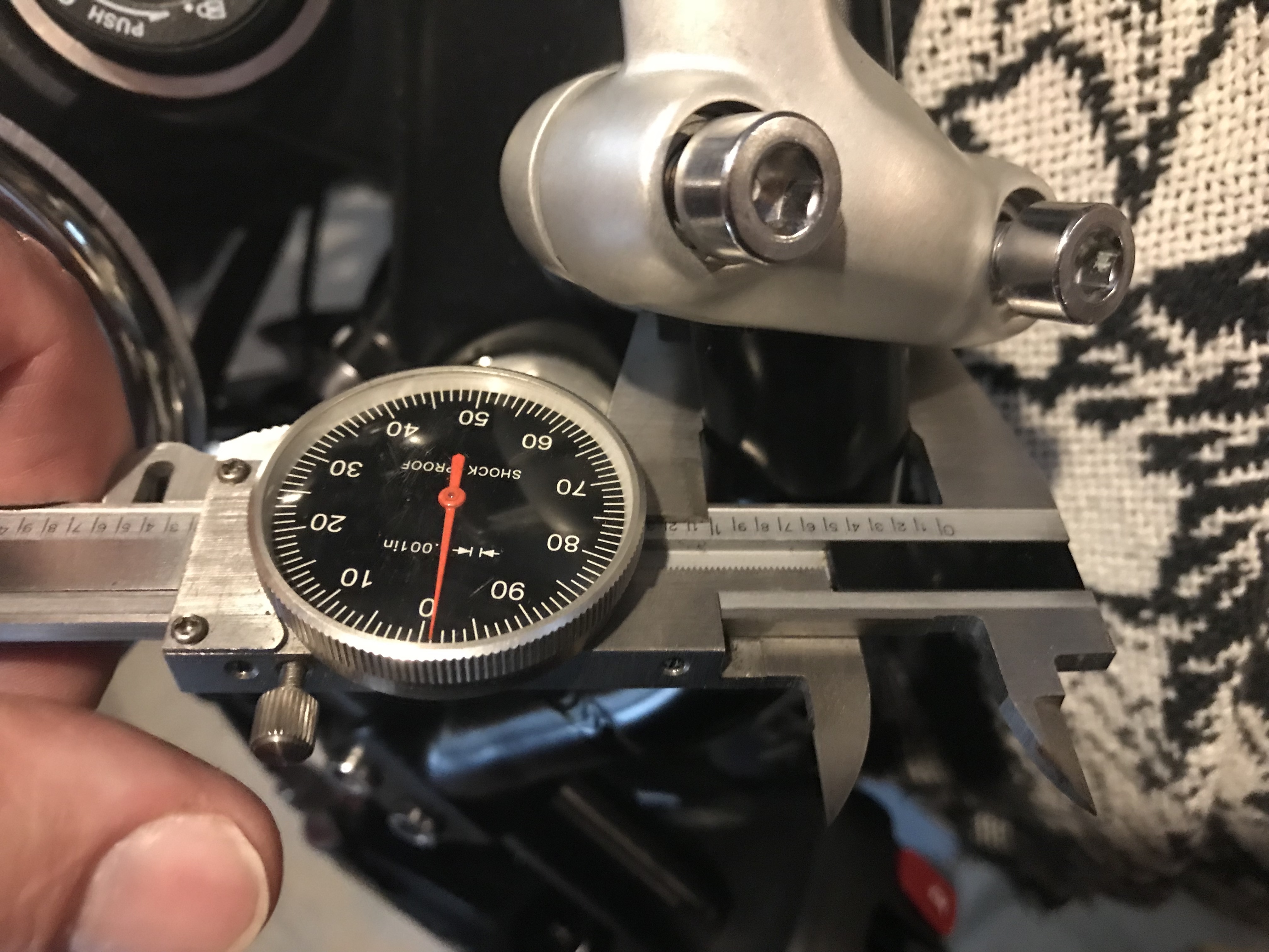

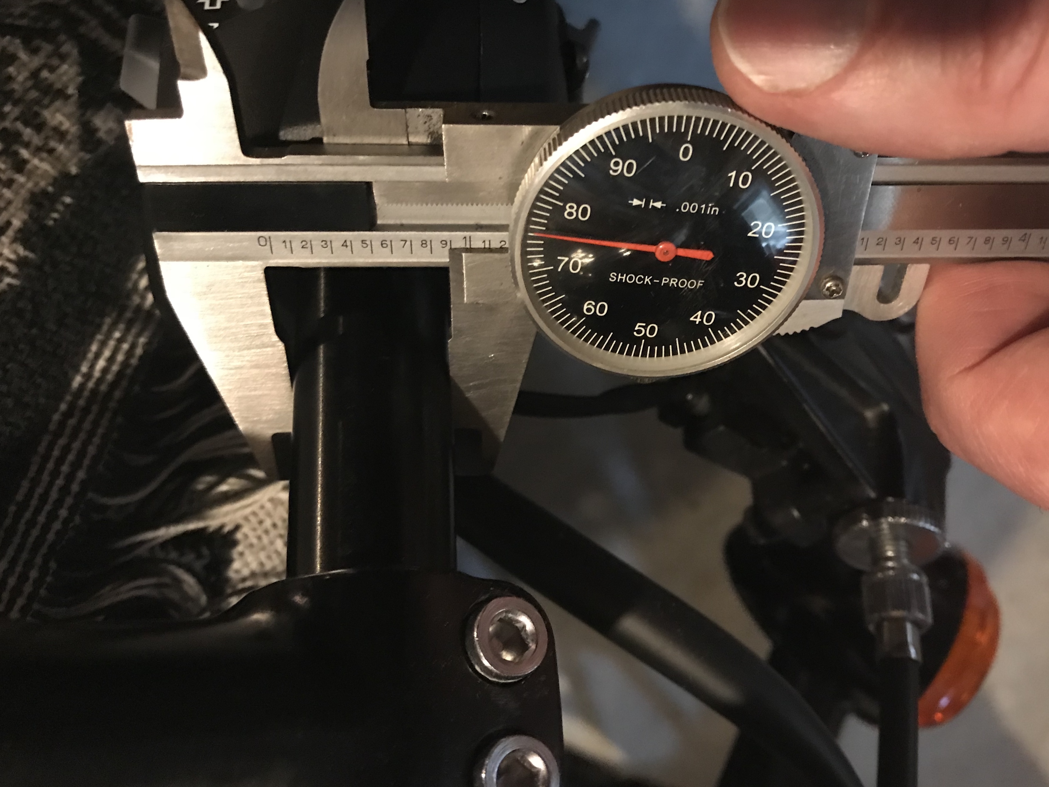

    Snag!! Of course. The definitive answer regarding handlebar changes is this. The riser clamps and original clubman bars are 1" diameter in the center. However, the ends where the switchgear, etc. go are 7/8". Go figure! So the 1" Biltwell bars I bought are useless and back for sale on Ebay. This is why the 7/8" bars from the Street Twin fit the switchgear from the Street Cup. I would imagine then that the dealer, when doing the bar swap, also use the risers from the Street Twin along with the bars. Sigh
