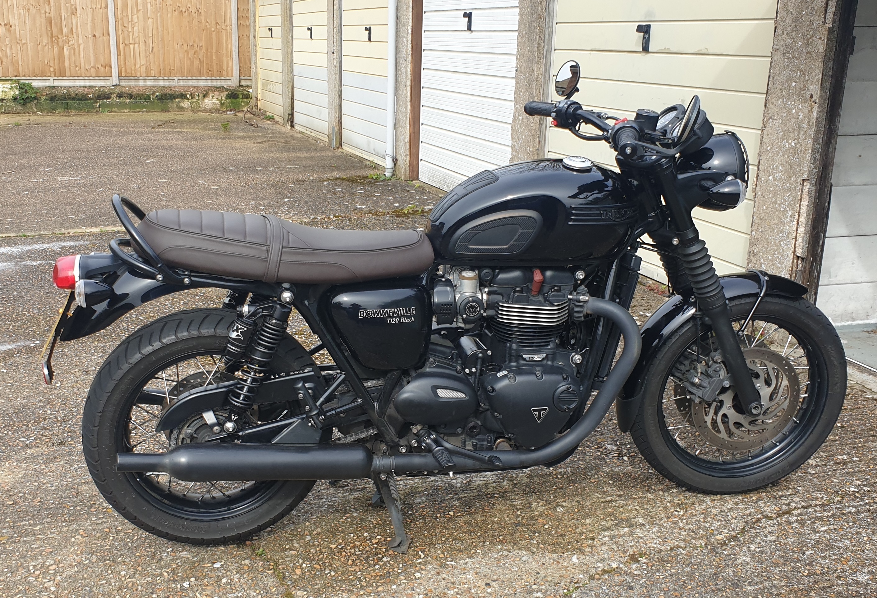

    Welcome to the family. Do hit the upload a file button bottom right and show the inmates your bike. Joe

    Here is my little beast.
