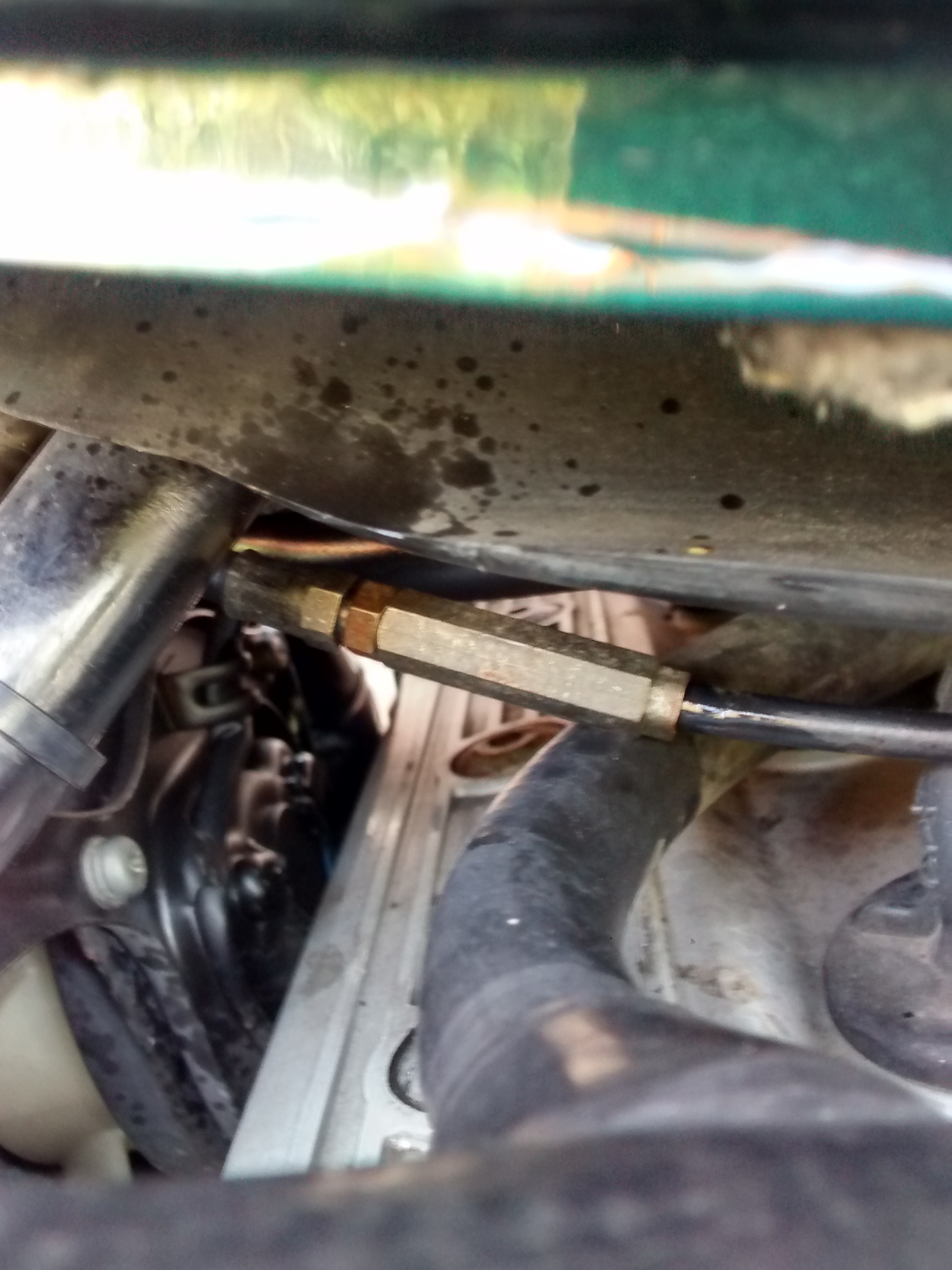

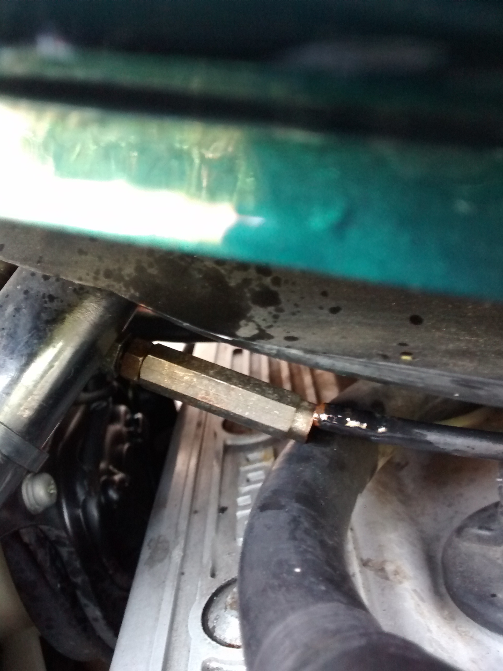

    Took the Trident on the DGR on Sunday and it behaved very well. However, on the way back the bike started revving up to 2500rpm when stopping at junctions or when left in neutral. I jiggled the throttle cable thinking that was caught and after a while it seemed to settle down but it wasn't quite right.
    Came to start it today and the choke lever would not budge.
    Turns out the bottom section of the choke cable had been pulled out of line from where it sits in the adjuster and caught itself on the edge of it, possibly because the cable had moved slightly out of position.
    I moved it all back to where it wasn't caught so that the choke operated on and off properly and it seems OK but will keep an eye on it.
    Pics explain it better - bottom one shows how it was and top how it should be. (overspray is WD40).

    As it is popping out of the adjuster, the most probable solution would be to extend/tighten the adjuster so there is not enough slack for it to pop out.
  3. steve lovatt
    9,218
    Cheers mate, yes I did adjust it to take up the little bit of slack but the whole cable had moved over and off the top of the cylinder head so more slack had been created. Back in the correct position now over the top of the head.
  4. steve lovatt
    9,218
    Turns out that the cable had broken anyway - it's meant to be fixed at this point so it wasn't a matter of poor adjustment.
    Had to buy a new one in the end - choke operation much smoother and idle more consistent so worth the pain of getting the tank off!
