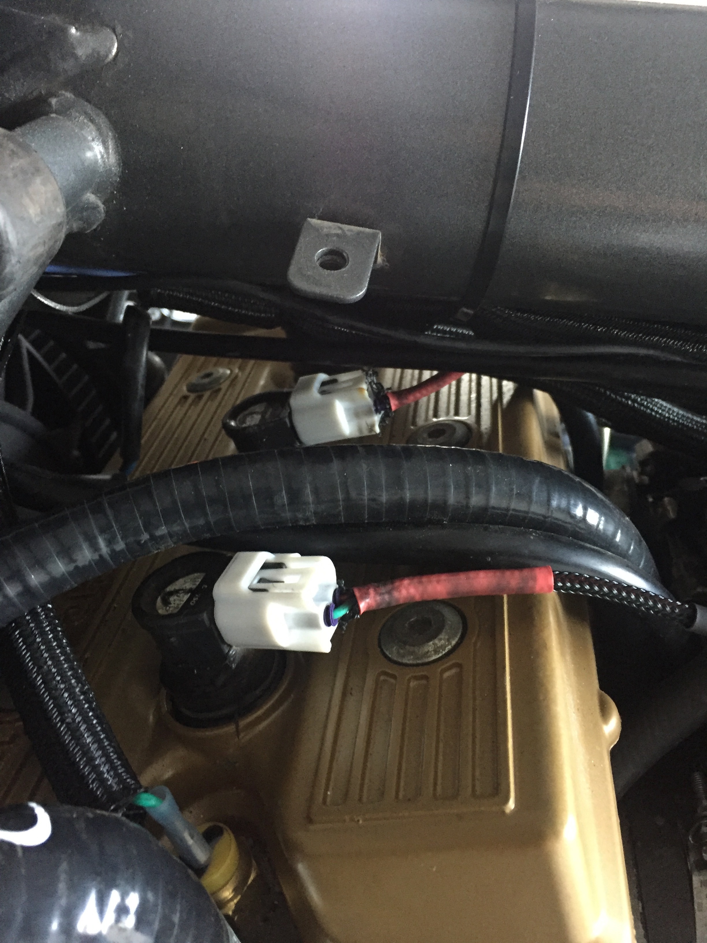

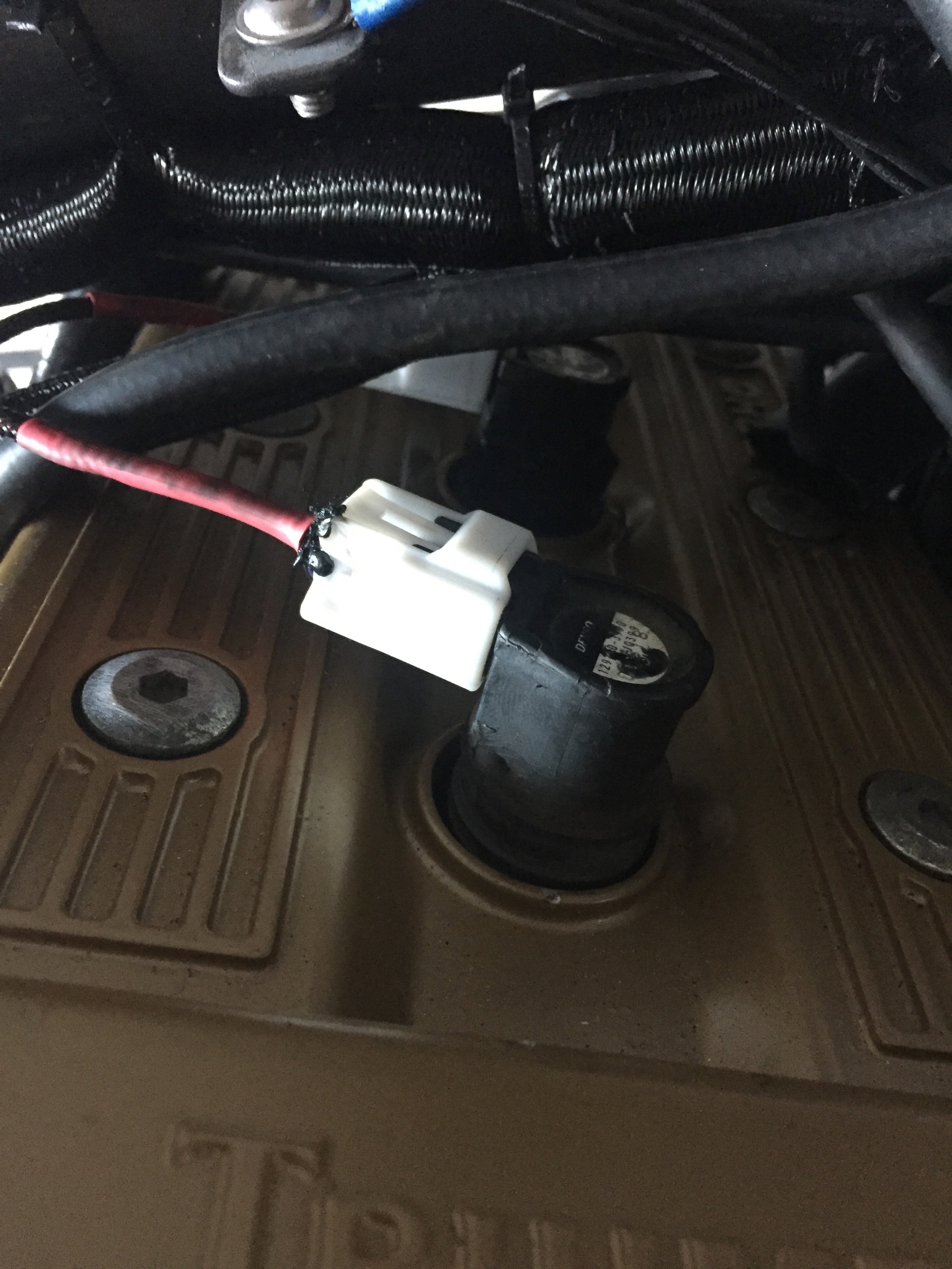

    OK Kiddies,...after all the forum surfing and all the articles and all the experts on the internet (some of them truly are experts and a fabulous resource for a mortal such as myself) I have come to the conclusion that the TT600 stick coils are just fine. There are many T300 bikes out there with several thousand miles on TT600 coils with no issues.
    I did it, my rubber grommets have not arrived yet but I fitted what I had to get the wiring out the way and it was very easy and very cheap. I have a total of 45 euro tied up in conversion to stick coils and the bike runs great on the table, I cant get any street time til I swap my jets (another story for another day) that should arrive tomorrow .
