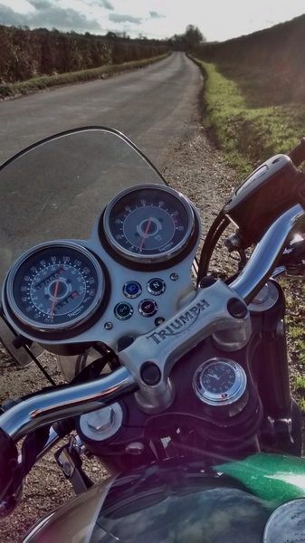

    Have one on the Bonnie - looks good and is very useful as I sometimes use the bike for work appointments.

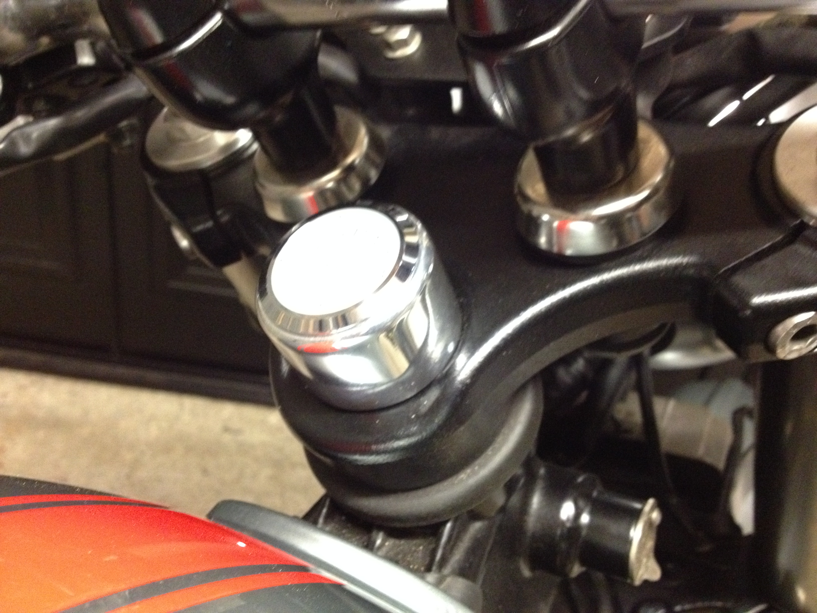

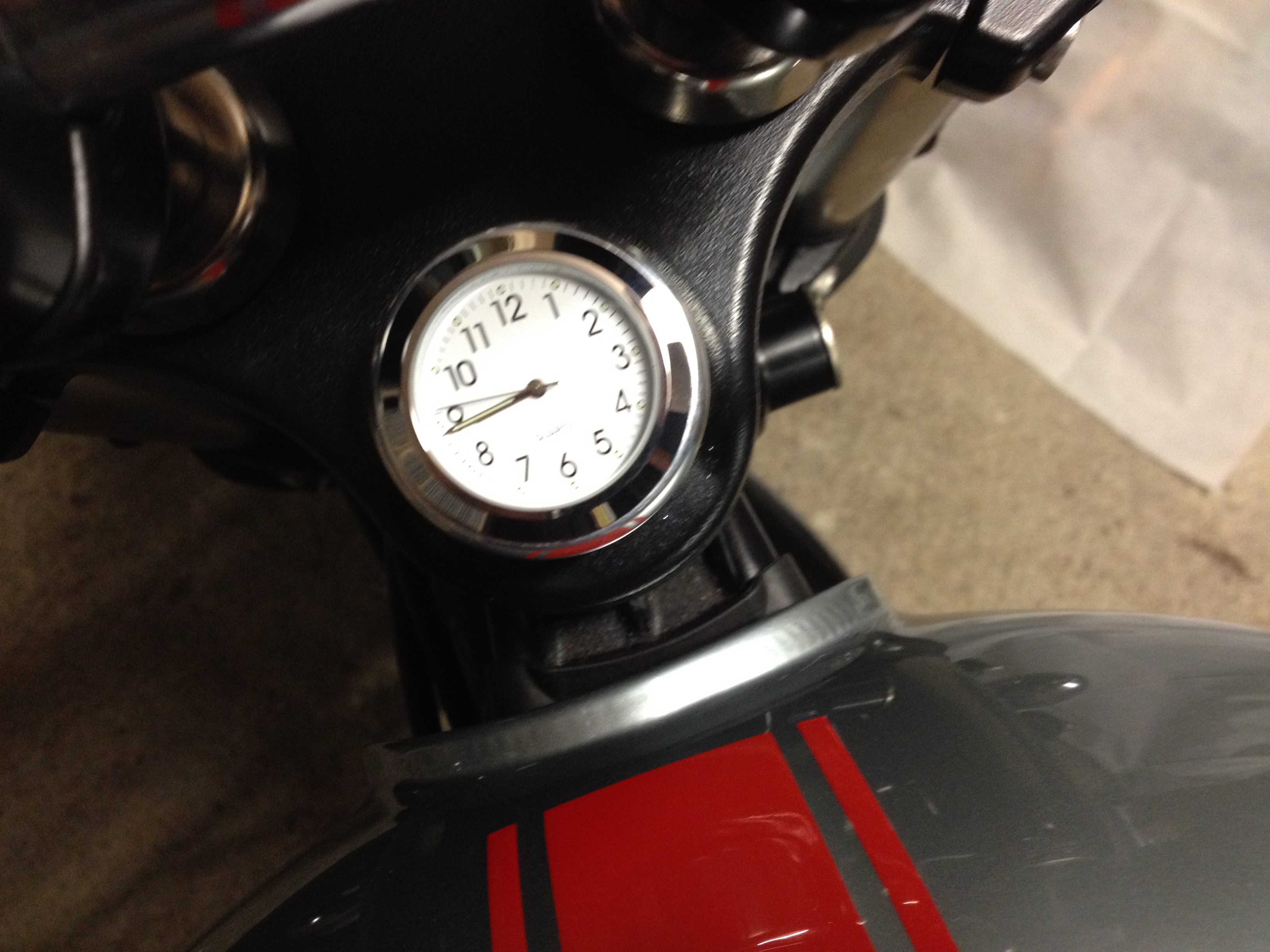

    After weighing up the pros and cons eventually went with one from ebay. Link here:
    http://www.ebay.co.uk/itm/261312232302?_trksid=p2059210.m2749.l2649&ssPageName=STRK:MEBIDX:IT
    When fitting the housing it was a little tight on the corners of the stem nut so after marking the contact points I eased the clearance slightly by filing a small groove at each position. Fits snugly now and the concealed grub screw completes the security. The clock face pushes in with a rubber gasket so you can accurately align the final position after the housing is in place.
    You need to specify the clock colour you require when ordering and they also supply thermometers if needed.
    Couple of pics attached.
