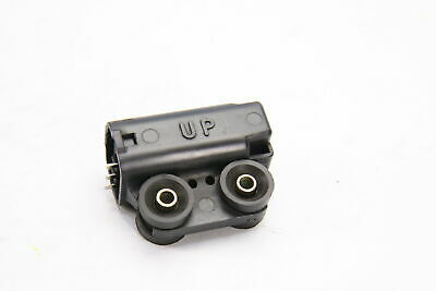

    There is a tilt sensor on bikes BUT i'm not sure where that might be!?
    Not even sure if you have one but good luck!
  3. Helmut Visor
    6,205
    Apparently in front of the airbox and looks like this.

    Thanks, I’ve seen this whilst looking on line, lifted the tank but can’t see it so not sure if it’s fitted to the GT
