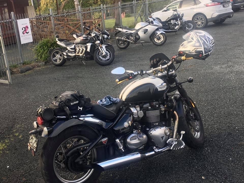

  4. Dartplayer
    7,195
    Hi Stefan, I did 43k km in 5 years on my 2018 Speedmaster using 1 or 2 Krega 20l drypacks for touring.
    You could get the set and mount behind you and they act as a comfy backrest. I didn’t have to take fuel, as we have Petrol every 300km at max, so that would be the only question for your travels. The 16litre tank was economical and even better with higher octane if wanting to go further.
    I added a Corbin seat to get 300km without stopping, but found 200km was fine on a new standard or comfort seat replacement.

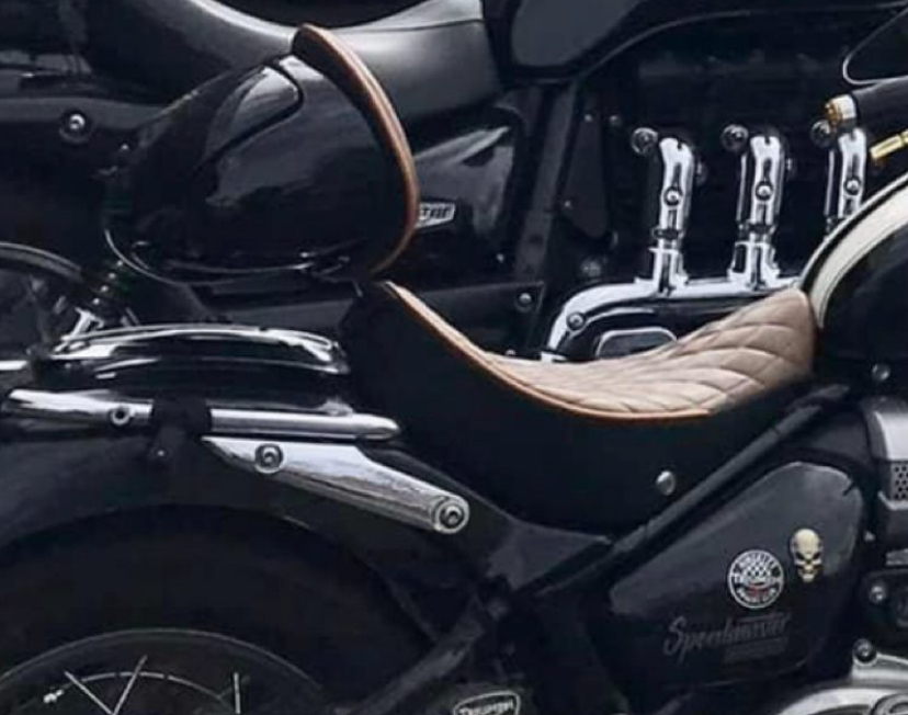

  11. Dartplayer
    7,195
    Me too Stefan, I use on my Thunderbird Storm now. Being 6’3” you would benefit from a Corbin, as they sat me down and right back for more leg room. Not sure of freight, but reach out if you buy a Speedy as I still have mine for sale.

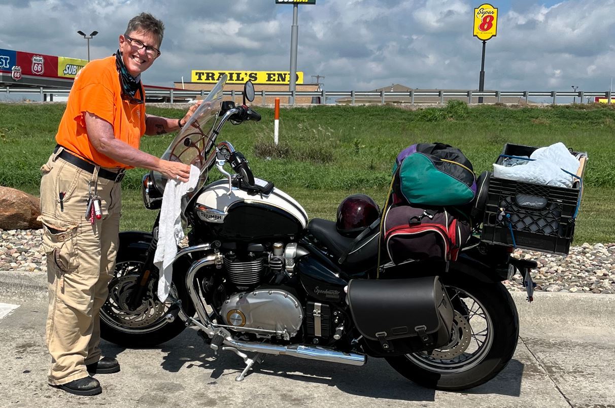

  14. Chrisfla1
    Chrisfla1 New Member
    May 29, 2023
    19
    Florida
    Hi, Stefan! I'm a 5'5" 65-year old woman, but a veteran (>40 yrs.) motorcyclist and a serious long-distance rider. Last summer I traded in my 2007 HD Ultra Classic (pretty heavy at 850 lbs. without gear, that I had ridden from Florida to California and back) for my 2020 Speedmaster. BTW, when I first sat on the Speedmaster it was love at first sit! I love the stock seat! Anyway, it had a few mods when I got it (with 3K miles) and I did a few more. It had the mini-apes and the waxed cloth side-bags (add-ons from Triumph), and I added the highway bars that meet at the bottom of the radiator (also from Triumph), the Triumph passenger backrest and pad, and the rack behind the pad. In addition, I'd saved my Harley Kuriakin (sp?) pegs and put them on the highway bars, and, best of all (because I couldn't ride without it), I added a full-fairing-style Slipstreamer windshield that has plastic lowers that protect my knees. That was a godsend! This past August, after I'd had it for 6 weeks, I rode it from Florida to the last four US states I needed to complete riding in "the lower 48," a bucket list item for my old age (they were ND, ID, WA, and OR). That was about a 6400 mile ride that (since I took my time), I finished in three weeks. The motorcycle needed nothing on the trip but a new back tire. I was cautious, so I only rode 110 or so miles before I stopped for gas (I planned the route and gas stops the night before with Google maps). No problems whatsoever, and I loved loved loved the cruise control! I did find that the gas mileage dropped precipitiously when I rode over 70mph (the highway speed limit in some western states is 80), so I didn't speed much. The other thing I love about this bike is, the more I thrash it, the more it loves me! So take your long-distance trips without hesitation. If this old woman can do it, I know you can too!

  16. Chrisfla1
    May 29, 2023
    19
    Florida
    I did the trip alone, but a nice lady at a convenience store took this pic. Turns out I took more clothes than I needed. Since I was only riding 6-7 hour (300-350 mile) days, I threw my clothes in the hotel washers/dryers whenever I needed clean clothes. My 17" laptop was in a knapsack in a plastic bag in the milk crate tied on the rack. Those (too-small) Triumph side bags certainly were stuffed full! That's how I did it.
