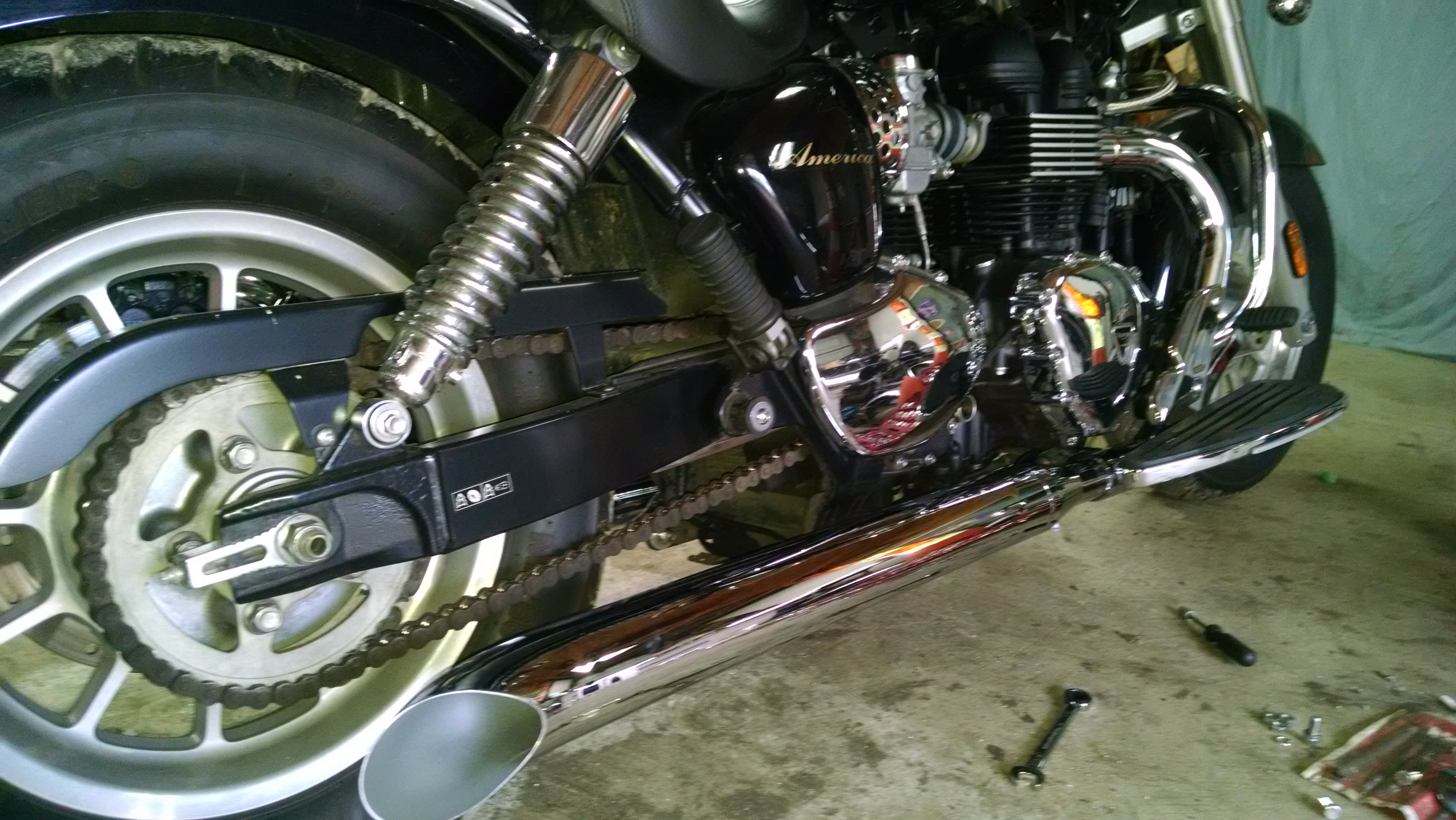

    There are kits, you plug the air pump tubes next to the plugs and most suggest leaving the pump instead of adding a resistor then the bike thinks nothing has changed except you remove a lot of garbage under the tank. I then added a set of long turn out slip ons, great sound and no pop. Motor was remaped new with speed master off-road pipes.
