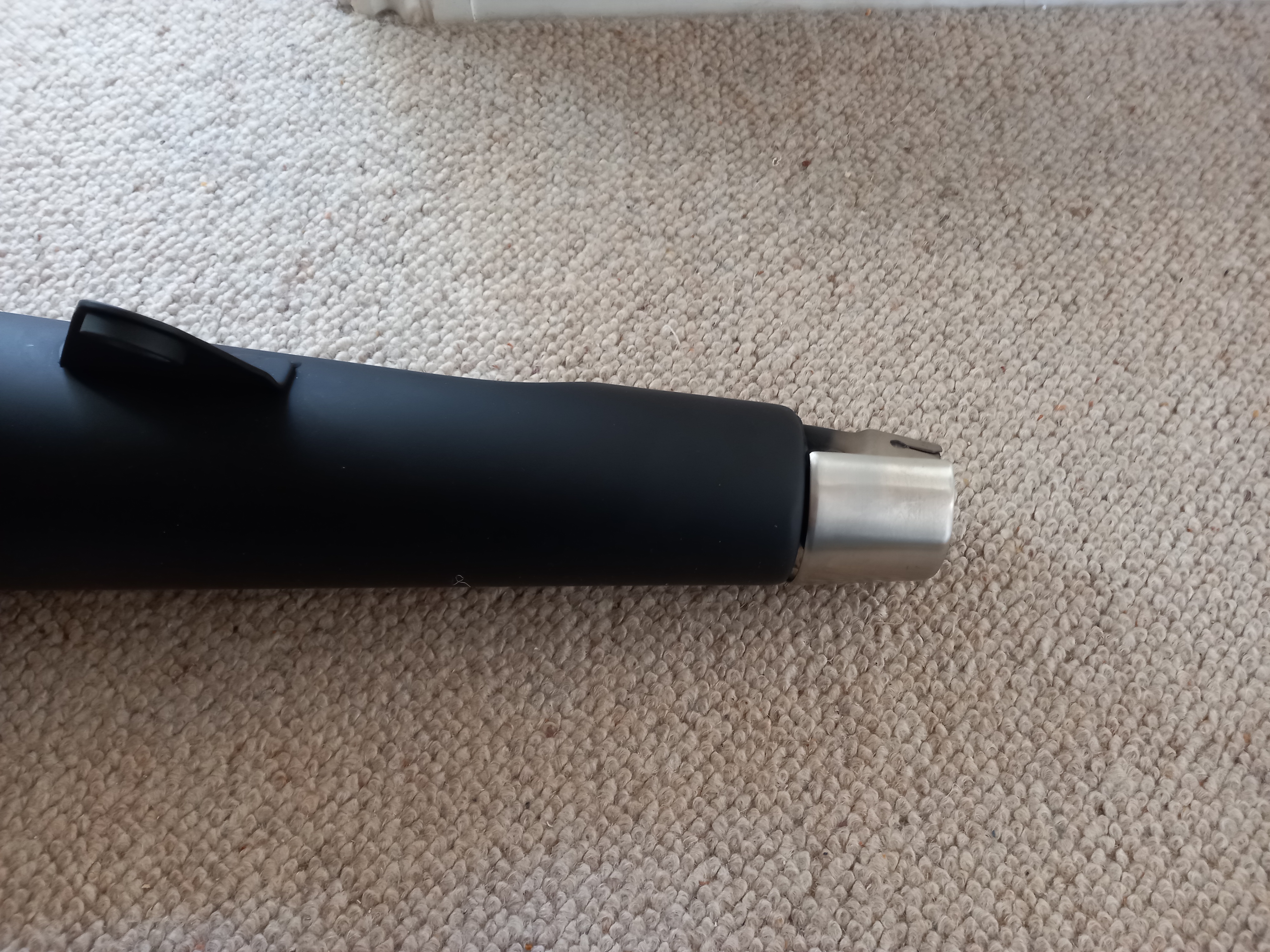

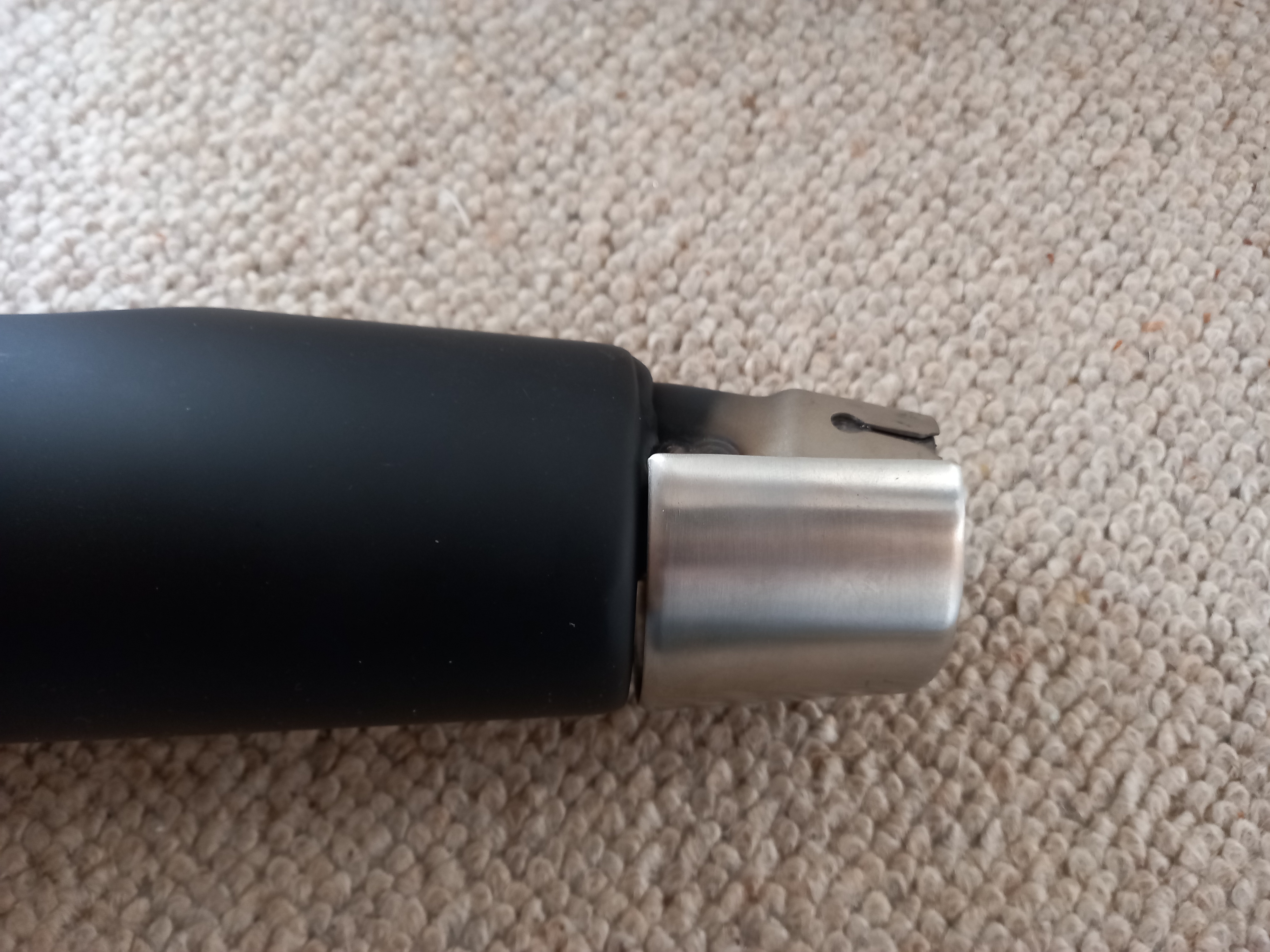

  3. darkman
    7,625
    Here are some pic's and measurements off my standard silencers that i replaced on my ST 1200, mounting hole to end of inlet approx 28cm and 38mm internal pipe, the second pic clearly shows the kink/bend from above as both silencers point outwards when fitted.

    Thanks Yorkshireman and Darkman, really helpful.
    I've just measured the distance you suggested on my silencers and very surprised to find that on the Street Cup its only 20cm, that's a bigger difference than it looks :(. The parts finder on the World Of Triumph website lists the same clamp (silencer to header) for both bikes so pipe diameter is probably the same. Street Cup has a similar kink at the inlet to its silencers but the angle is probably going to be different given the difference in size.
    Oh well back to the drawing board; glad I didn't buy the bargain unused pair I found on eBay.
