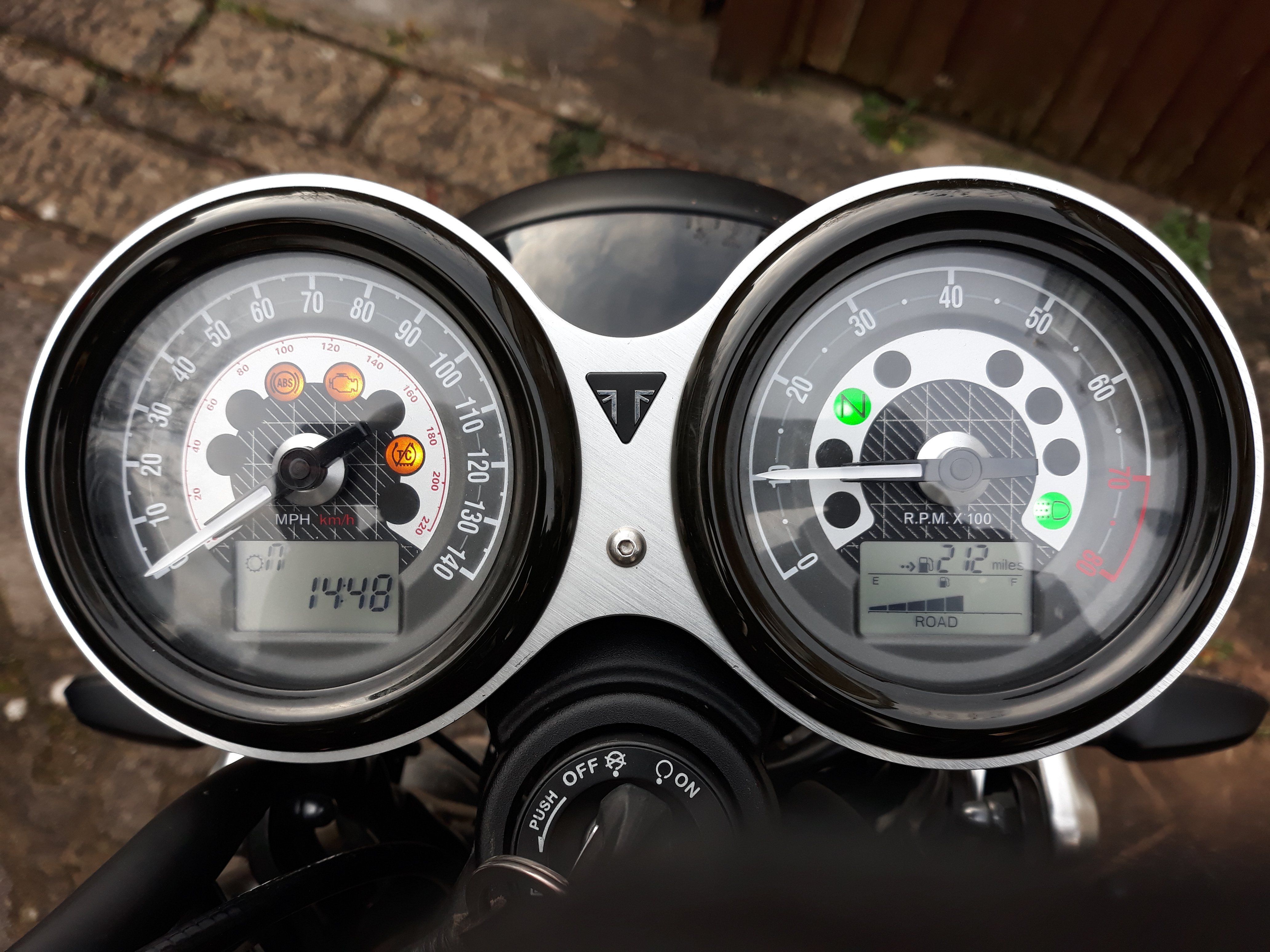

    Ok, so I'm riding my Speed Twin sensibly but every time I put just a little power the traction control kicks in, and I mean a little power, not giving it the beans just a gentle twist, then after 15 miles or so, dash lights up like a Christmas tree and service 'spanner' starts flashing. Then the distance remaining on the fuel meter gradually climbs to 212 miles when I've done 70. It's all gone a bit wrong.....
