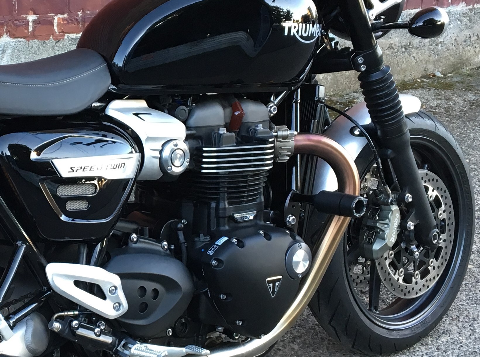

    Hi, Mops.
    Here's a couple of pics of the Sato Racing sliders on my Speed Twin. I also have a latest generation Bonneville with these same sliders.
    Frankly, they don't look as stout as the crash bar type that go over the header pipe. But I'm a sucker for the minimal look! :)
    Best
    Jet City

    What is Matt at Sato Racing smoking? Those same sliders fit on my 2018 Bonneville and 2019 Speed Twin EXACTLY the same way.
    The motor mounts for those two bikes and the Thruxton are the same. Where’s my eye roll emoji?
