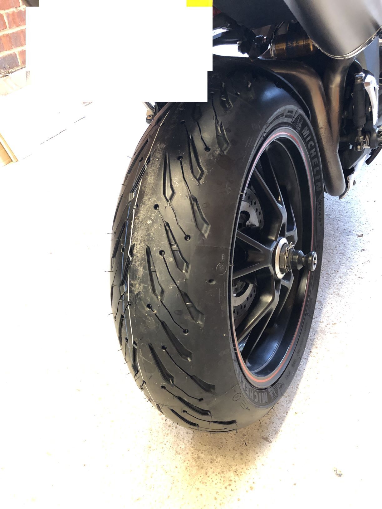

    Well this happened today, turned out the front tyre was just as worn so two new Michelin Road 5's for me. If my wife asks, I only spent £150 :cool:

    Is that front tyre on the right way?:confused:
  9. roginoz
    roginoz Member
    Jul 30, 2019
    Wichita, KS
    Yes.
  10. dilligaf
    I only ask as the apex of the tyre tread pattern usually points forward at the top of the tyre as can be seen on the rear tyre :)

    Yeah when I looked closer it didn’t look right. I’d have rather known if it was wrong so appreciate it you pointing it out :cool:
    Like you say, learn something new everyday :)

    I'm with @dilligaf here as normally the road surface water is channelled from the centre out towards the edges hence why yours looks incorrect.
    Glad it isnt to save you having to mess about but easily done when taking loose wheels in i.e. without the bike.
    I always wax crayon a direction arrow on the tread centre if not changing it myself before i drop the wheels out.

    Bloody hell the gaps in those tread blocks in the rear tyre are just looking for a foreign object to enter them
  17. Vulpes
    17,810
    What they actually do is pick up grit and tiny pebbles and then hurl them at following vehicles... I was following a bike with road 5's on Skye last year and was absolutely blasted by it.
    I actually have them on my Speed Triple now and love them.
  18. Vulpes
    17,810
    My front tyre is on the same way as @Mkelly21 's
