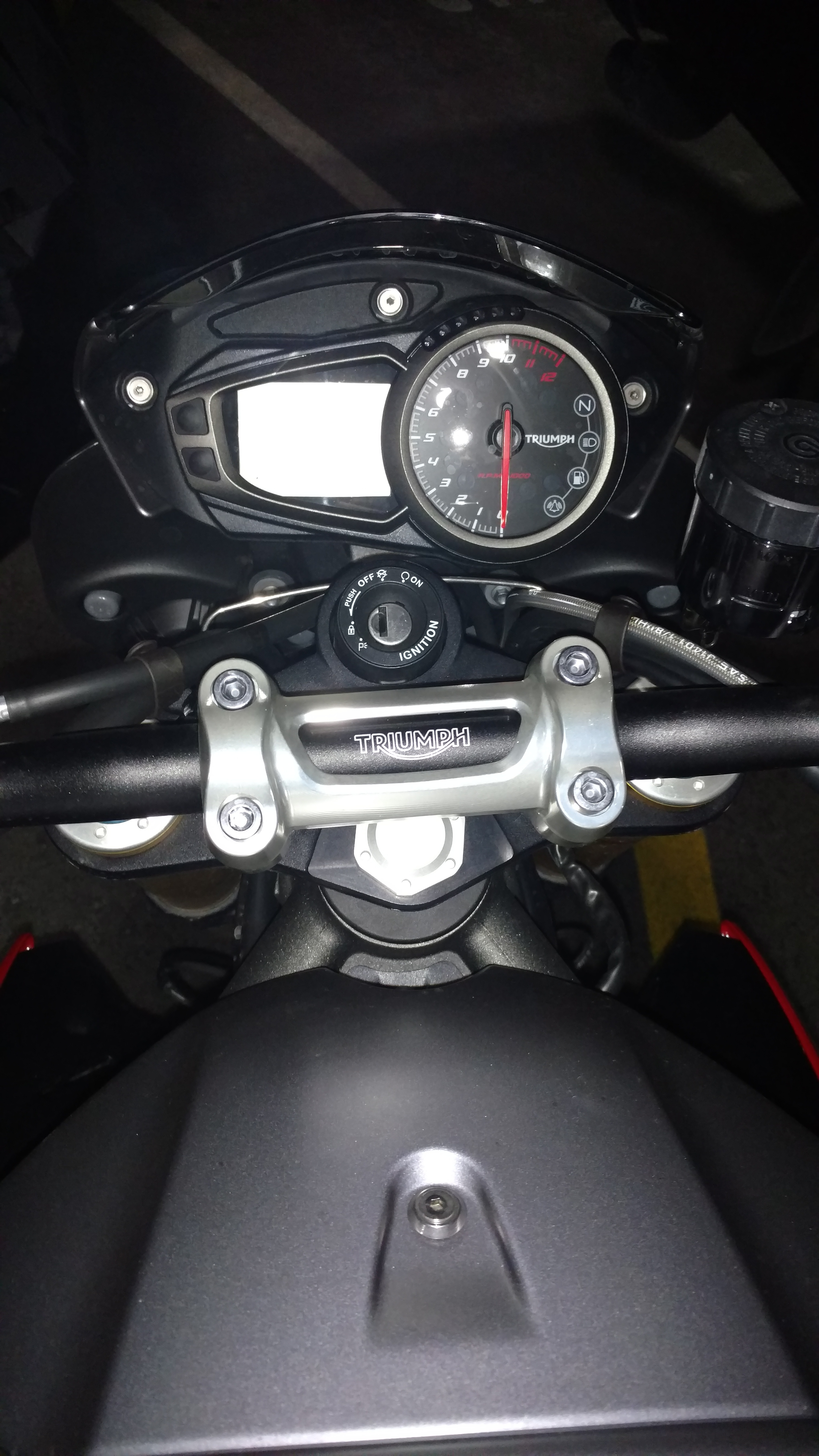

    I'm thinking of raising the handlebars slightly for a more comfortable riding position.
    All I'm planning to do is to rotate the bars in the clamps a few degrees however this will mean the Triumph motif on the bars would then not align with the cutout in the clamp. Looking at it, I reckon I can turn the clamp around 180° to realign it.
    Has anyone tried this?

    So I swapped the handlebar clamp around and rotated the bars a few degrees.
    This has raised the grips slightly, probably around 20mm.
    This feels a much more comfortable position for me but I've only taken her around the block. The proof will be on a longer trip, but as it stands I'm pleased with this quick and simple adjustment.

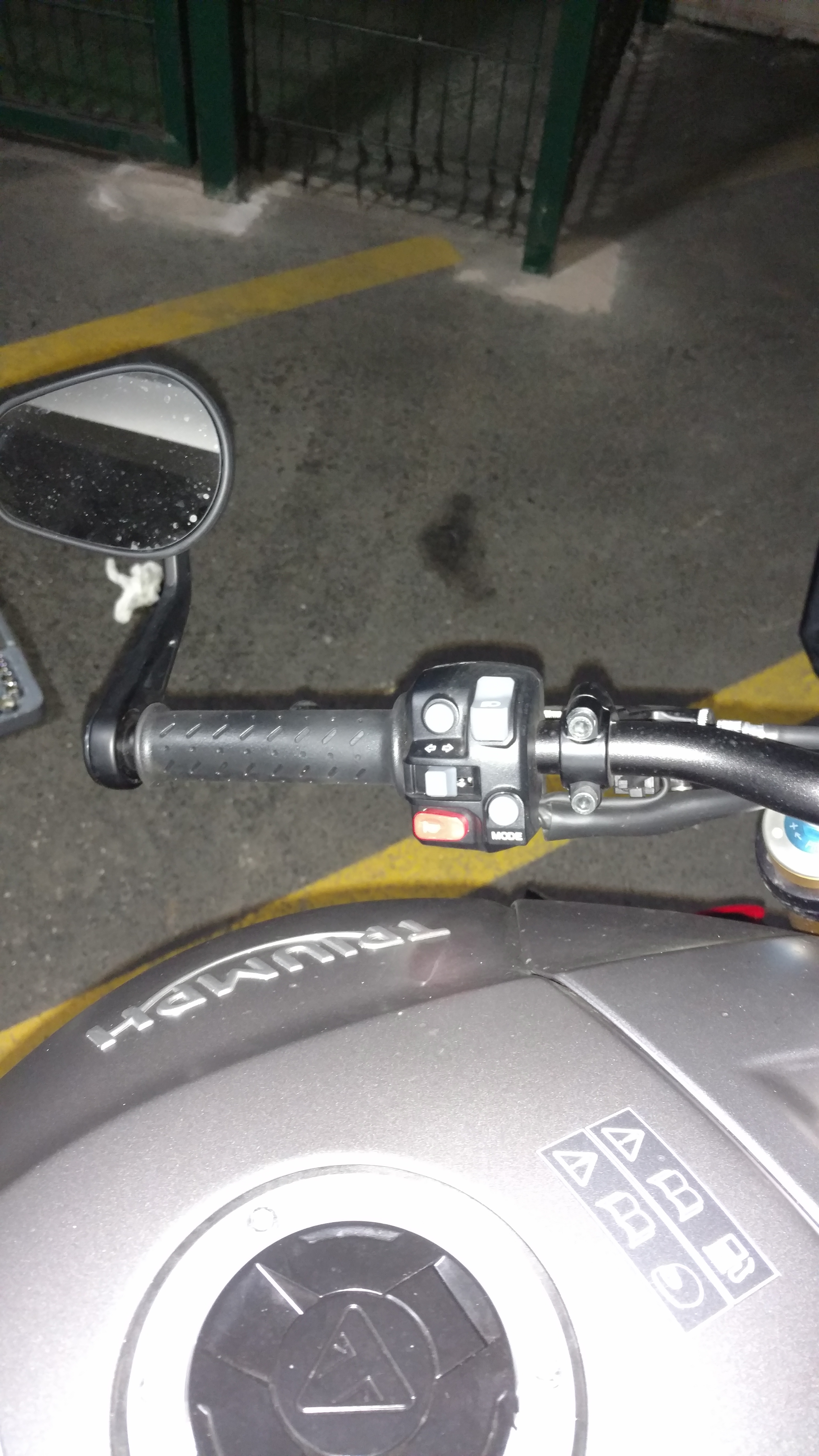

    Bar ends now sit slightly higher at the grips. Around 20mm at a guess.

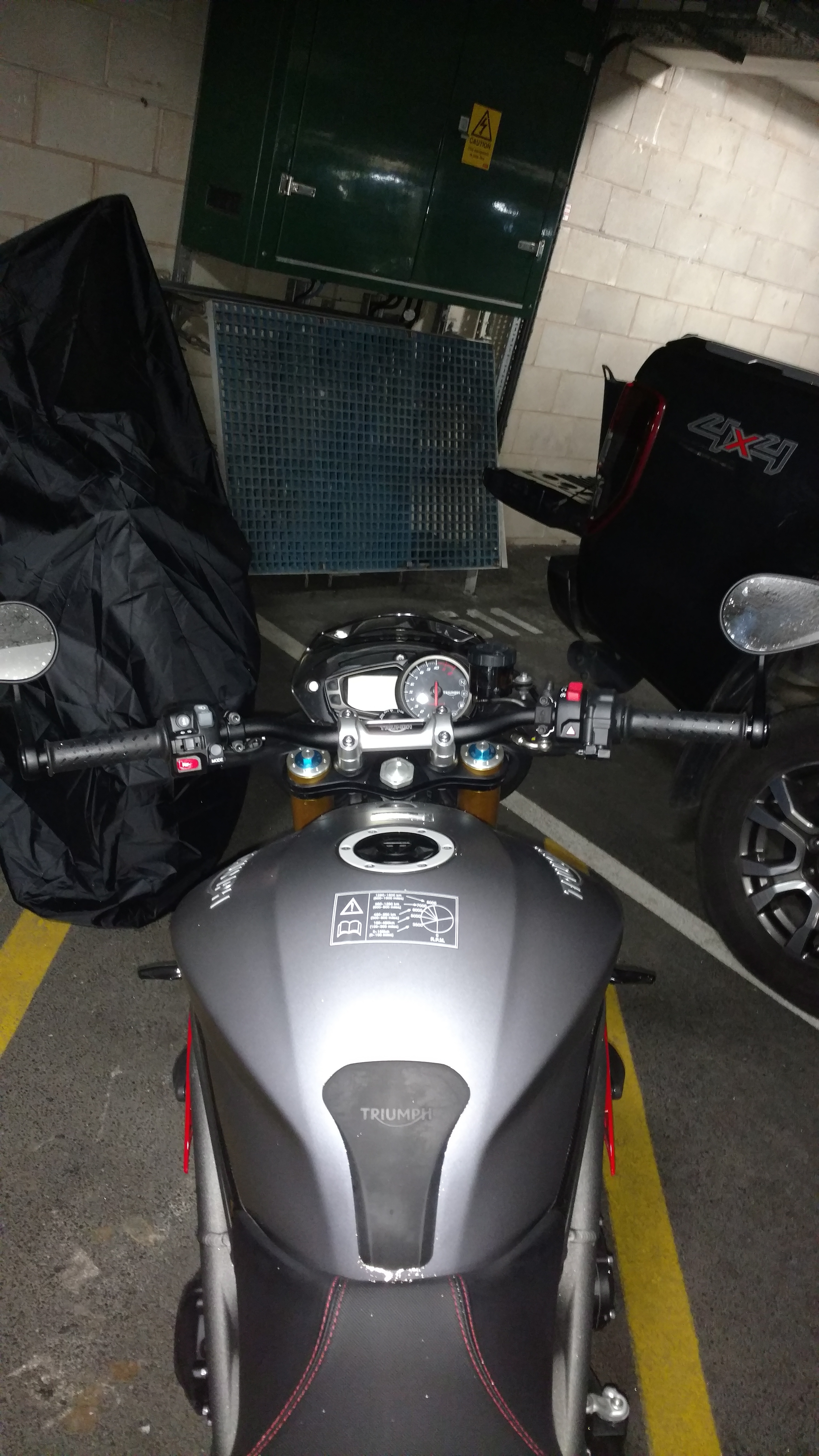

    Gap to the tank on full lock.
