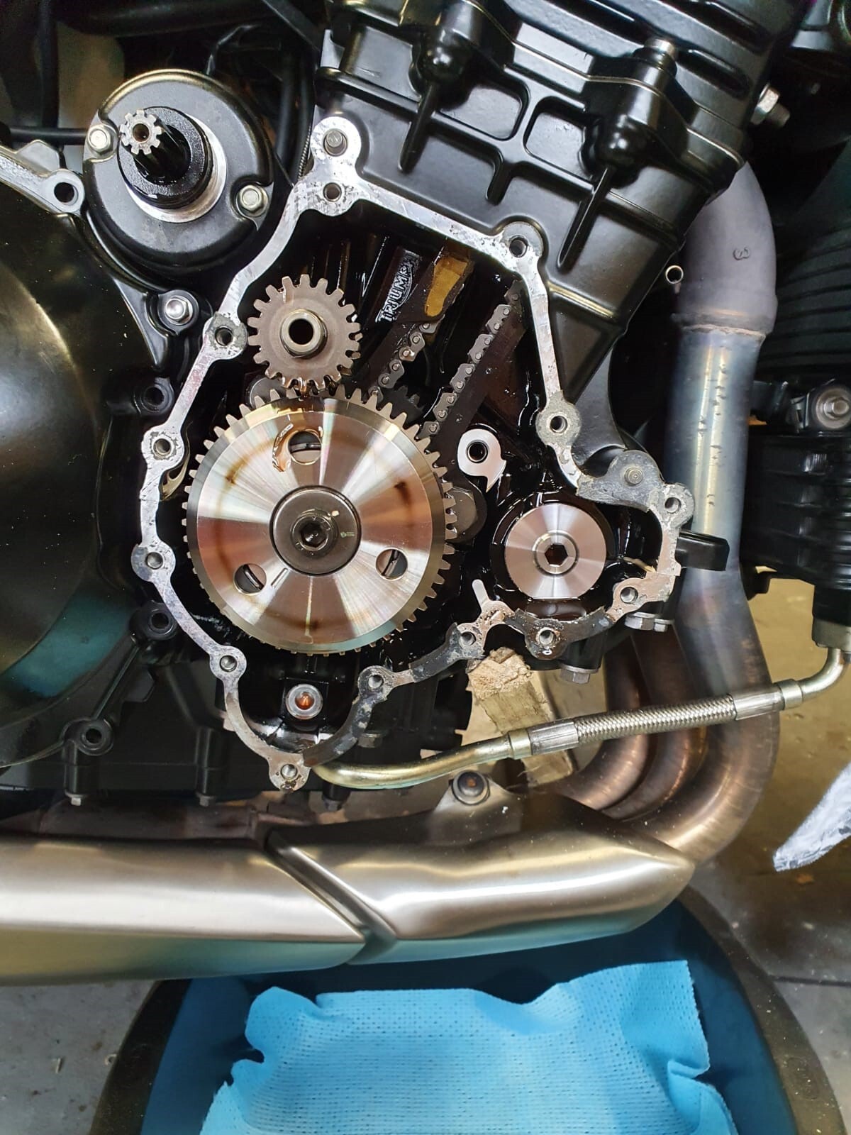

    Hi Davie, both the 2010 and 2011 had gearbox issues as did later year models as well, however not all machines are affected, as such it's a bit of a lottery if you have one that's good or has issues. The difference in spec is minimal, it comes down to aesthetics more than anything. I repaired a 2010 one not to long ago, I obtained a stronger modified spring from Germany and replaced the arm and bearing, some forum members have had the bearing become detached and thankfully it made it's was direct to the sump (it could have had disastrous consequences had it jammed in elsewhere). All this said they are a great machine, I went for the Street Triple 765rs instead as I find it a more entertaining ride, also there is little difference in performance, the speed triple has more low and mid range torque but the Street Triple if happy being revved and has plenty of grunt. I have posted some pictures that I took whilst fixing the problem. The beauty of buying from a dealer is the warranty, however make sure it is not a third party warranty, they are honestly not worth the paper it is written on despite what a dealer tries to tell you.
