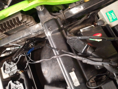

    I have an 04 Triumph Speed Four which has always, since purchase, had some minor issues with the alarm.(I think it's a Datatool S4). Recently however after the battery again discharged the alarm system has finally locked me out completely.
    In the morning after battery charging, bike started fine, that afternoon the alarm will not deactivate.The key fob led illuminates however Indicators don't flash and turning ignition on activates siren and key fob(s) will not silence or reset alarm. I noticed that the wire to the rear LED was corroded and broken but speaking to Datatool they assure me that this will not effect the alarm operation.
    As stated, I've read many posts relating to this, all seem to have the opinion of ripping the alarm out, a simple job requiring the linking of pins 1+2 and 3+5 on the multi-block connector... simple if you have a multi-block connector, which I don't appear to have. My datatool seems to be spliced into to main wiring loom with any colour coding tags removed. To complicate matters further I do not have a code for the alarm so resetting using that option is also not possible.
    I've attached a couple of pics, for what they're worth, showing the connection of the alarm (with the heatshrink removed). Any USEFUL help/advise or wiring schematic for the speed four would be appreciated.

    My son and I had a similar problem with a 600 Yamaha Fazer many years ago.
    A rather drastic solution but we found the simplest way to resolve the alarm problem once and for all was to replace the whole wiring loom with a secondhand one.
    Probably not what you wanted to hear but its a complete solution as when the data tool was originally fitted the wiring would have been extensively modified to make it difficult, if not practically impossible to remove.

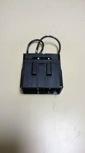

    Wherever the alarm fits into the main wiring loom, it should just unplug, and then you replace it with one of these, which you should be able to get from your Triumph dealer. I did this with my thunderbird, with no problem at all. They call it a blanking plug.

  5. Samsgrandad
    Samsgrandad Senior Member
    Dec 15, 2019
    602
    Somerset
    The blanking plug would be the simple solution if the bike had originally been fitted with a Triumph Datatool alarm. However in the OP's case it appears from the photos that the alarm fitted was wired into the loom rather than using the OBD port, (if the Speed 4 even had that port fitted)
    That means rather more drastic measures are required to remove the alarm in this instance.

  7. joe mc donald
    14,420
    @Blanketstacker You should be able to unwrap the wiring and remove the alarm that way. you may need a soldering iron to melt the solder on the wires. Then just tape up and do a reset.
