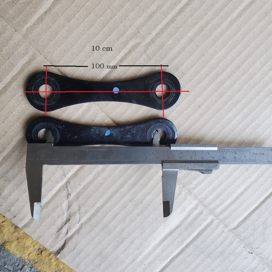

    I change mine on my 2023 900 RP several times and sizes, (Standard is 100mm) changed to 110, 120, even 135mm. The larger , the lower the bike. kept it at 110 with Suzuki "bones"... but suspension soft/hard did not change.
