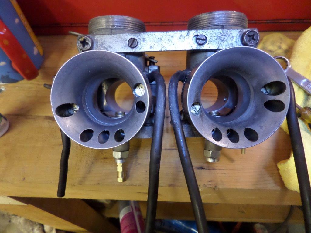

    Having pulled the carb's out last night, they are two differant age age of carb.. US spec so 200 main... but the needle is set on position 2 going up?.. Amal say 3 and I think I've seen 4 somewhere... so no wonder screwing the air screw out to 2 full turns helped things... Any idea what the std setting is?
    also the tube going into the main area where the slide is is differant.. One (the older one) is about 2mm proud where as the newer one is about 4-5mm.. will this make any odds?...

    Should be 2 and half standard setting

    Ok... And tubes the same length also now 2 hours with a Swiss file and all is well
