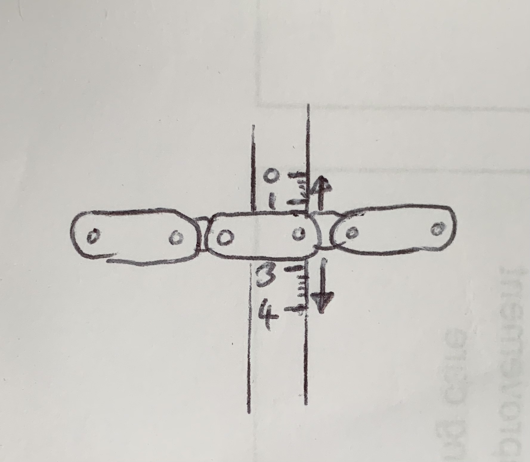

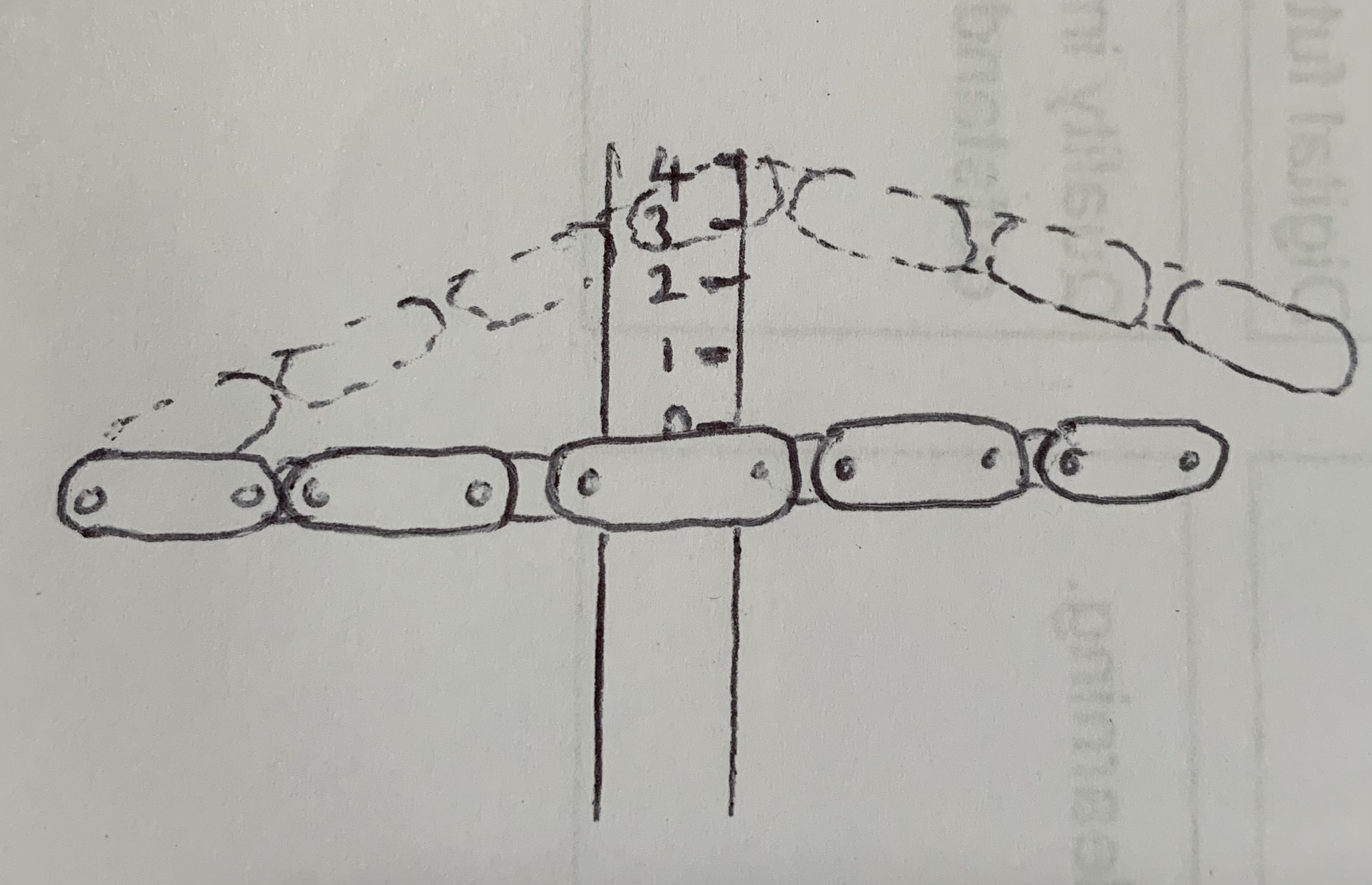

    When for example it says 4cm of free play, which of the below examples of measuring is correct?
    In image 1 the chain’s movement is through a 4cm ‘window,’ and in image 2 the chain’s upper edge is free to move upwards by 4cm.
    I hope you get what I mean?
  2. Yorkshireman
    3,399
    The bottom image, but reversed, if you get my meaning. You should measure mid way along the bottom run of the chain at its tightest point, ideally with you sat on the bike so the suspension is loaded as it would be when riding.

    If you are talking about the T120 I'm afraid Yorkshireman is wrong ,just checked my handbook which says to check the chain with no weight on the bike (section 1 page 100).Assume that means without anyone sitting on it.

    Chain slack specs are usually with the bike upright but unloaded, ie, no one sat on it. The spec allows for the chain tightening during riding and will (should) give a min and max chain slack figure. Don't know the measurements for your bike but an example would be between 20 and 30mm so 15mm will be too tight and 35mm too slack.

    I would have thought image 1 would be correct, being 4cm total travel from being pushed up to being pushed down
    This is how I have been doing it for 25 years since I was shown at what was my local bike shop
    I have not had any issues with the chain being too tight doing it this way, as always enough slack for when the rear suspension is under load and the chain would be at its tightest.
    Have I been adjusting it too tight for 25+ years!

    Neither image is quite right. Image 1 is closest, but is indicating the distance between highest position of the top of the link and lowest position of the bottom of the link. What should be measured is the range of movement of a single feature - either the top edge of the link or the bottom edge.

    I always use total deflection, not just one way.

    Yes, that's what I mean by 'range of movement'.

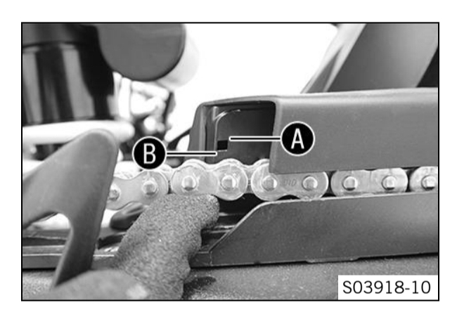

    KTM has a simple solution...
  17. Yorkshireman
    3,399
    So does BMW;)

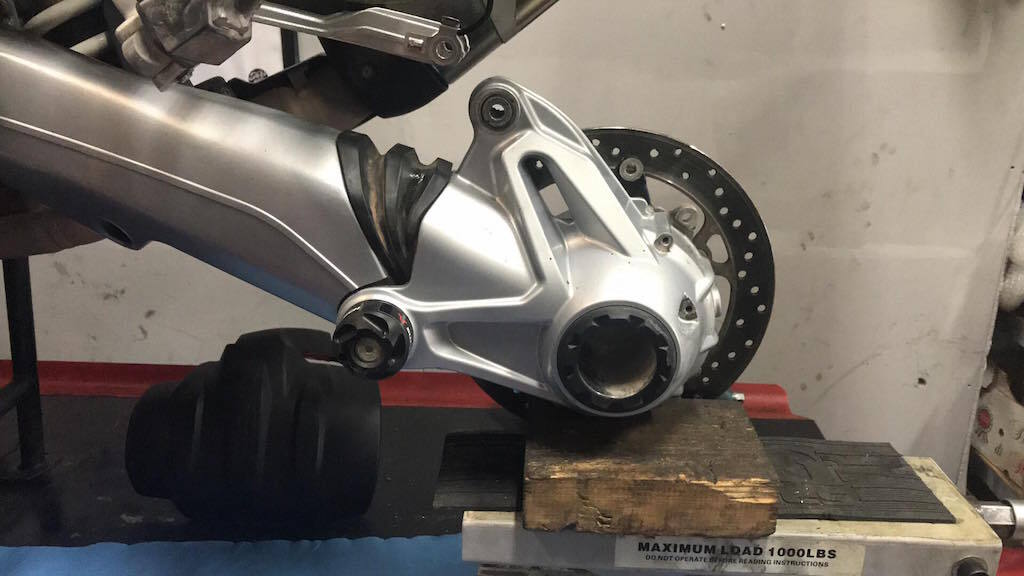

    I hope their Shaft drives are better aligned than their sprockets
