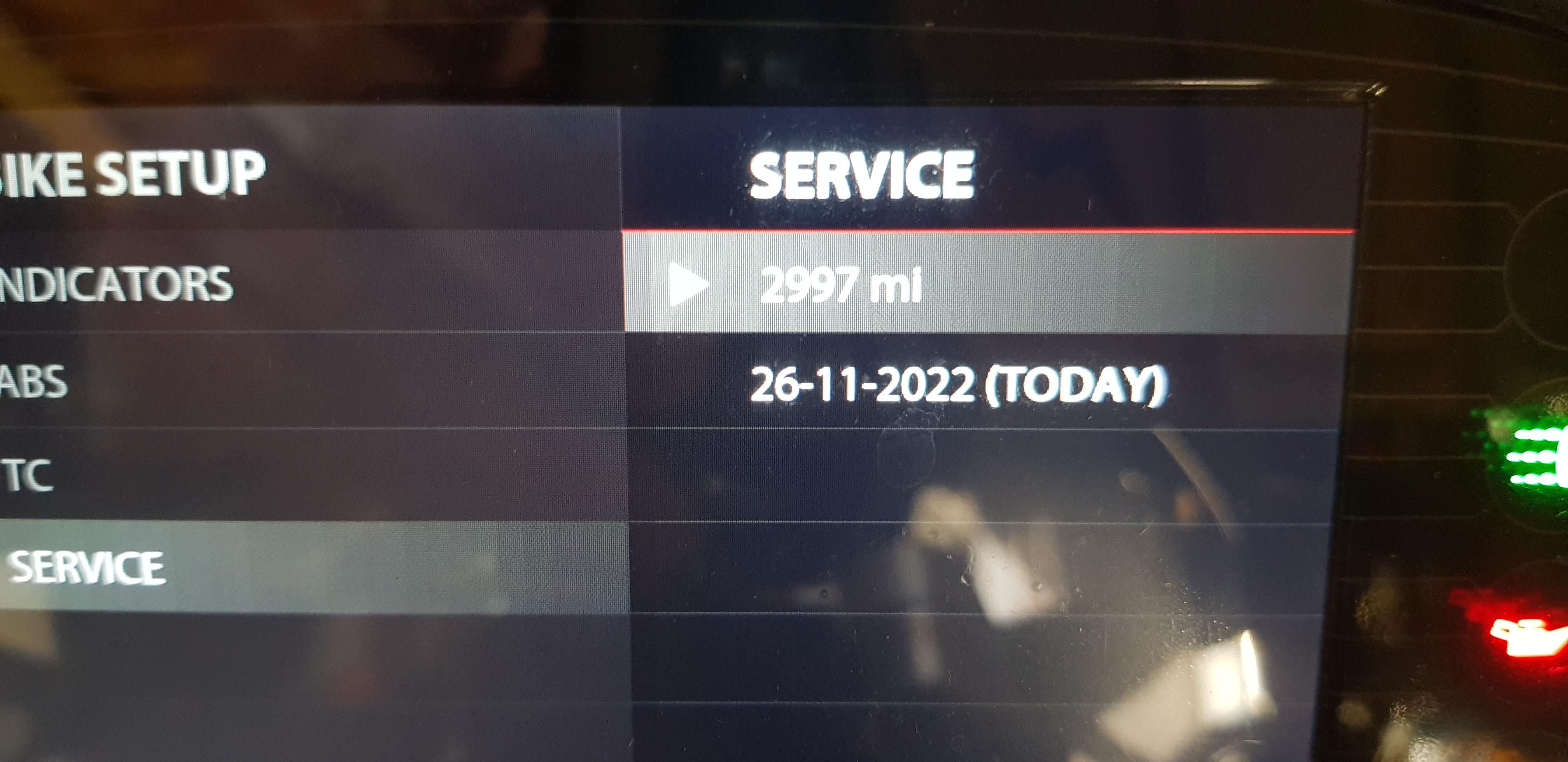

    I'm a bit of a Luddite when it comes to bike electronics so I'd be grateful if anyone can help me out with this issue:
    My bike is a 2017 RS. I've had it stored in my garage since the end of October and I decided to give it a run today. On start up, the dreaded orange service light illuminated and despite watching several You tube videos on how to reset it, I'm struggling to do so. When I get to the service menu on the dash, I don't appear to have a third 're set' option as shown on some of the You tube videos (see photo). Any suggestions as to how I can reset it myself without going to a dealership would be gratefully received. I do have an OBD fault reader, but I bought that for my car and don't want to f**k anything up by using the wrong application. I have tried changing the date on the bike itself, but that didn't make any difference.

    I use DealerTool to reset mine on my SpeedTriple. Assume you would need the same.

    It would seem that to get it sorted I would need to get Tune ECU, dealer tool or take it to a man who can. I don't mind spending on a specialist resetting tool, but as I have other bikes, it would be handy to buy something I can use on those too. Bearing that in mind what would be best to buy?

    The Dealer Tool would be the one I would recommend for Triumph motorcycles, it costs £60 and includes a single code for your machine, if like me you service and repair other models then you can purchase an additional code that covers all models. It uses Windows as the operating system, when downloading the software make sure you PDF the files, if it does not happen automatically, it is simple to operate and covers everything required for servicing your bike, including re setting the service light, checking and adjusting throttle bodies, ABS pump purge for bleeding brakes, ECU stored fault codes and clearing (even though no warning light has been placed on the dash) as well as a multitude of other functions. Some non-Triumph machines are easier to clear codes, Suzuki's for example can be re set by simply bridging terminals on the ECU plug (you do need to know the correct ones though), I made up a very simple bypass wire that I just clip in and allows re setting the service light, and a lot of other functions. Using the Dealer Tool does not alter or damage anything in the ECU, and it does not allow flashing the ECU, so you can't run the risk of inadvertently altering anything within the ECU.
