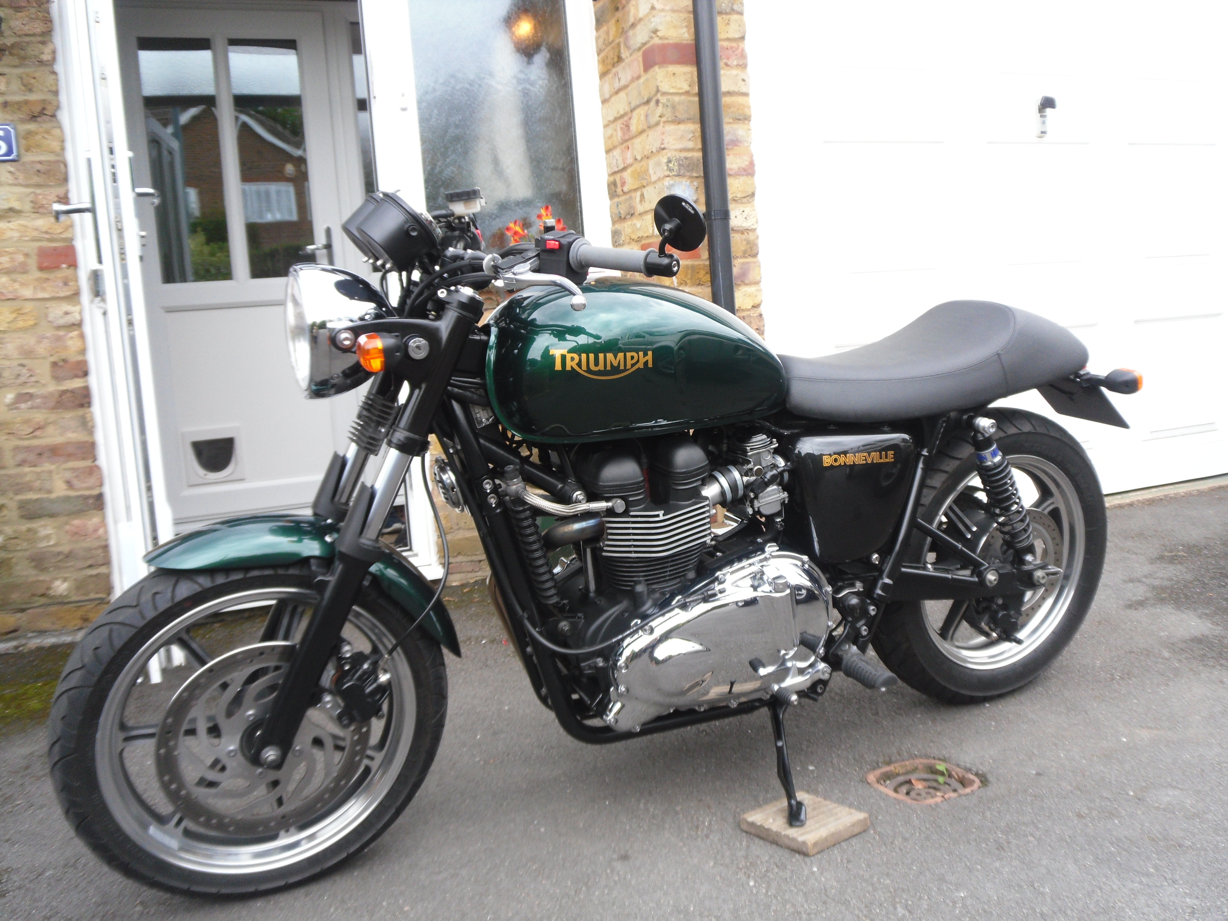

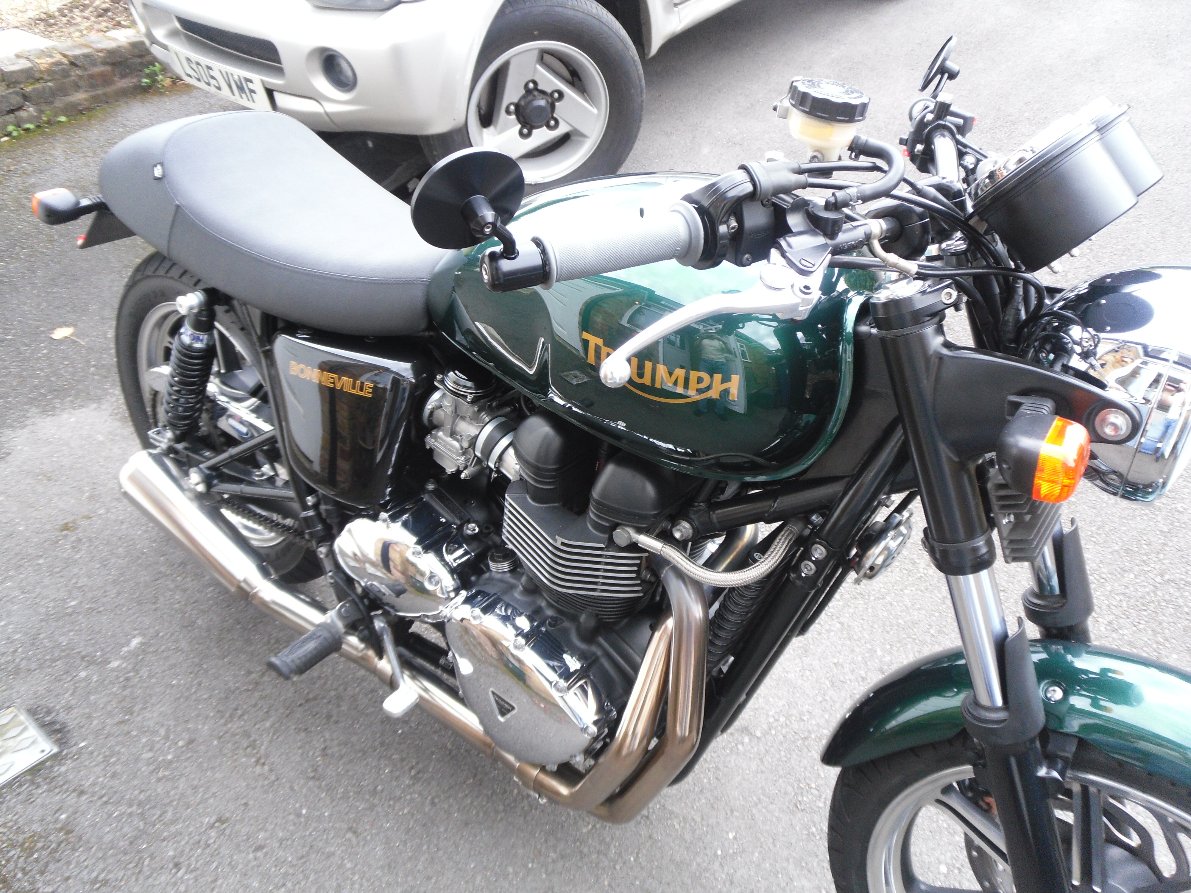

  4. TonyG
    TonyG Noble Member
    Dec 1, 2016
    822
