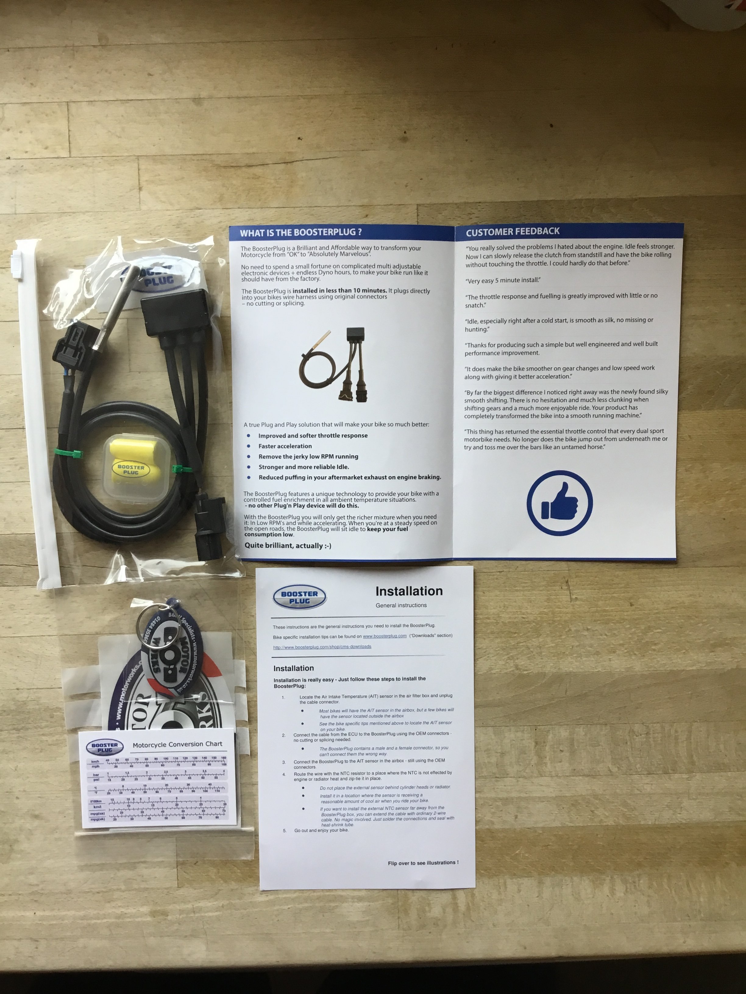

    Hi people,
    Really excited over new piece of kit for the scrambler, ( I know Sad bloke ). Looking at the plug, instructions and packaging it appears that these guys are a professional outfit supplying quality products.
    Nice touch including a few freebies .......the conversion table appeals to my anorak mentality.
    Will fit next week and test, ( a trip for urgent shopping required ).
    Downloaded the instructions specific to my bike. These guys have covered everything. I just hope that I am adding to the positive customer feedback soon.
    I have added a photo of the opened package as it arrived this morning.
    I will keep you updated following my ‘ shopping trip’.
    Mark
