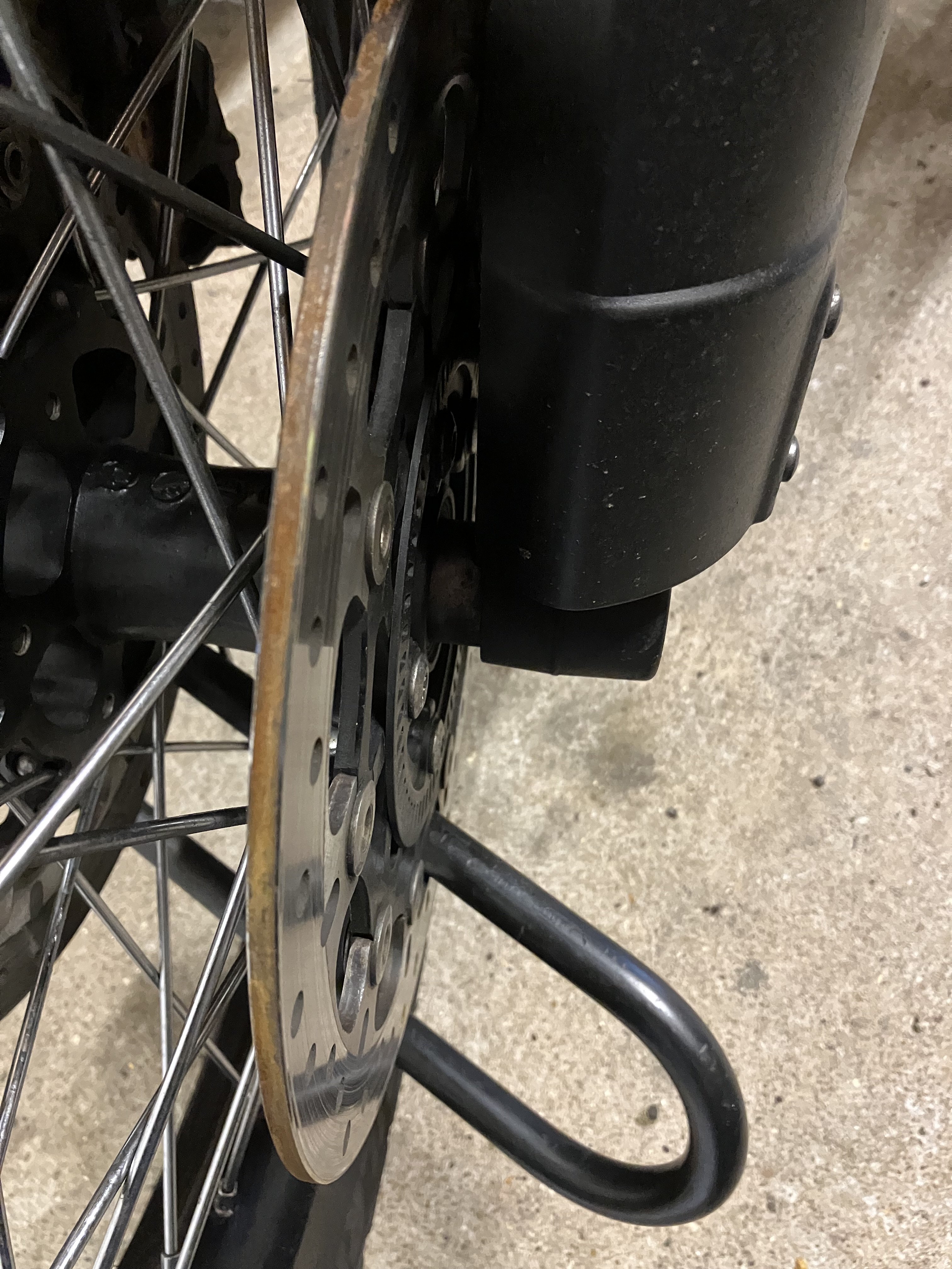

    Now after a few weeks riding, he's noticed that the edges of both front discs are rusting see pic, the rear disc (unworked on) is fine.
    Has anyone else experienced this?
    Are we correct in suspecting that some sort of protective coating has been rubbed off by whatever was incorrectly fitted in the callipers?
    Will carefully wiping a cure rust solution around the disc rims stop the corrosion and is it a good idea? He'd obviously ensure that nothing got on the braking surfaces.
    He doesn't have a lot of money and certainly doesn't want to replace the discs.

    @RevPaul They all do that eventually when wet. Just get a rough bit of wire wool and clean them yes treat if you want. But i just clean mine every now and then.

    The discs are stainless steel so no coating involved. Some grades of stainless are still prone to surface rusting especially when ridden in the winter after the gritters have been out. Clean the rust off the perimeter as Joe says. It's only surface rust so should be easy enough to remove.
