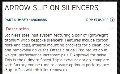

    Not particularly relevant to the original question posted (I'm sure Anthony's made his mind up by now :)) but found the article I mentioned that Triumph published about the Arrow slip-ons for the Speedy, might be of interest to SpeedIII owners with or thinking about getting them. About 5 years back they used to send out a magazine (a real one, on real paper!) to RAT members, so here it is, think it's just about readable (zoomed in).
    2016-03-06_10-53-58 (1840x1228).jpg 2016-03-06_10-54-52 (1228x1840).jpg 2016-03-06_10-57-16 (728x3400).jpg
    Not all advertising BS either, I've compared maps and surprised to see in some areas the Arrow fuel map is actually lower than standard to achieve the required air/fuel ratio (which is same as standard over majority of the throttle/rev range).
    So designed with the intention of removable the db killers (single screw with the tiniest of tack welds to gain E approval) and a map to suit if you want that extra 3PS.....or just like waking the neighbors. :cool::D
    Also any owners that have bought a Speedy minus the baffles (db killers) and want them a little quieter, it seems you can buy them separately (ref Triumph parts catalog).
