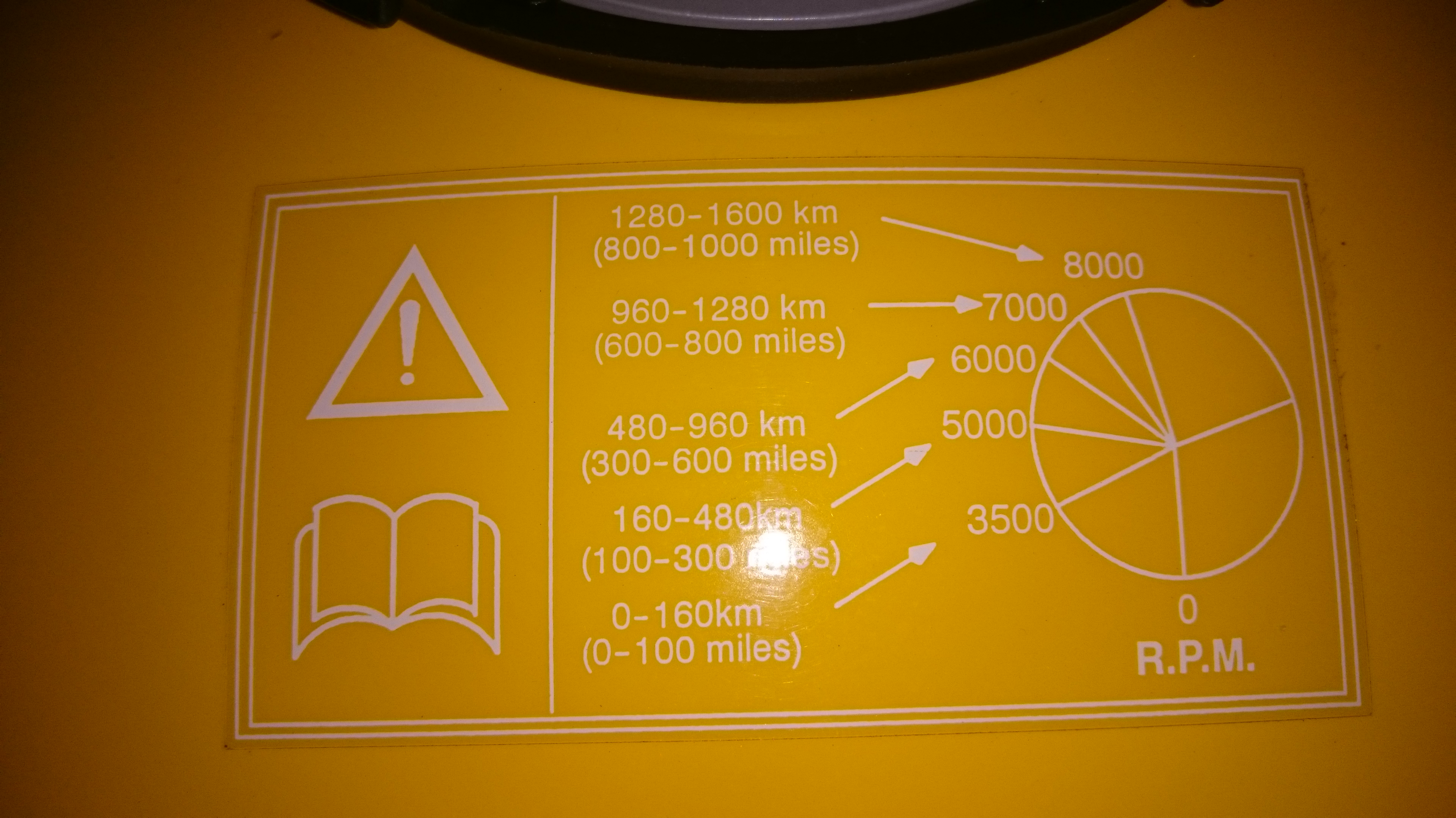

    I suspect Triumph will do the same on the Street as the Speed, so there will probably be a 'running in' sticker guide on the tank, which advises the revs permitted up to each mileage bracket. They will also state no full throttle and trying to keep the engine speeds varied as much as possible.
    From memory on my Speed its;
    3000 up to 300 miles
    5000 up to 600 miles
    6000 up to 1000 miles
    Then do as you see fit. Obviously the Street will be a bit different as I'm pretty sure it revs higher.
    I just set the shift lights at the limit and increased the setting at each mileage bracket.....used them as "Naughty Naughty, Change Gear lights" so to speak!
    I've just got over the 600 mile mark and slowly plodding towards full rev and throttle (not sure they'll be used a lot though). In all honesty with the Arrows on mine, the sounds of slowing down are much more fun than speeding up anyway so I don't see the running in as too much of an issue.....especially at this time of year!
    Obviously it's your bike for you to do as you wish, but I'd try an stick to the recommendations.....it'll be far too easy for them to be able to tell if you haven't and they could then easily invalidate your warrenty etc!
    As Alfie says, the mileage will soon pass by. Best to be careful at the outset in order to enjoy it longer once fully bedded in!

    Like I say, the tank will probably have a sticker akin to this; DSC_9798.JPG

    Perfect, thanks Dave.
