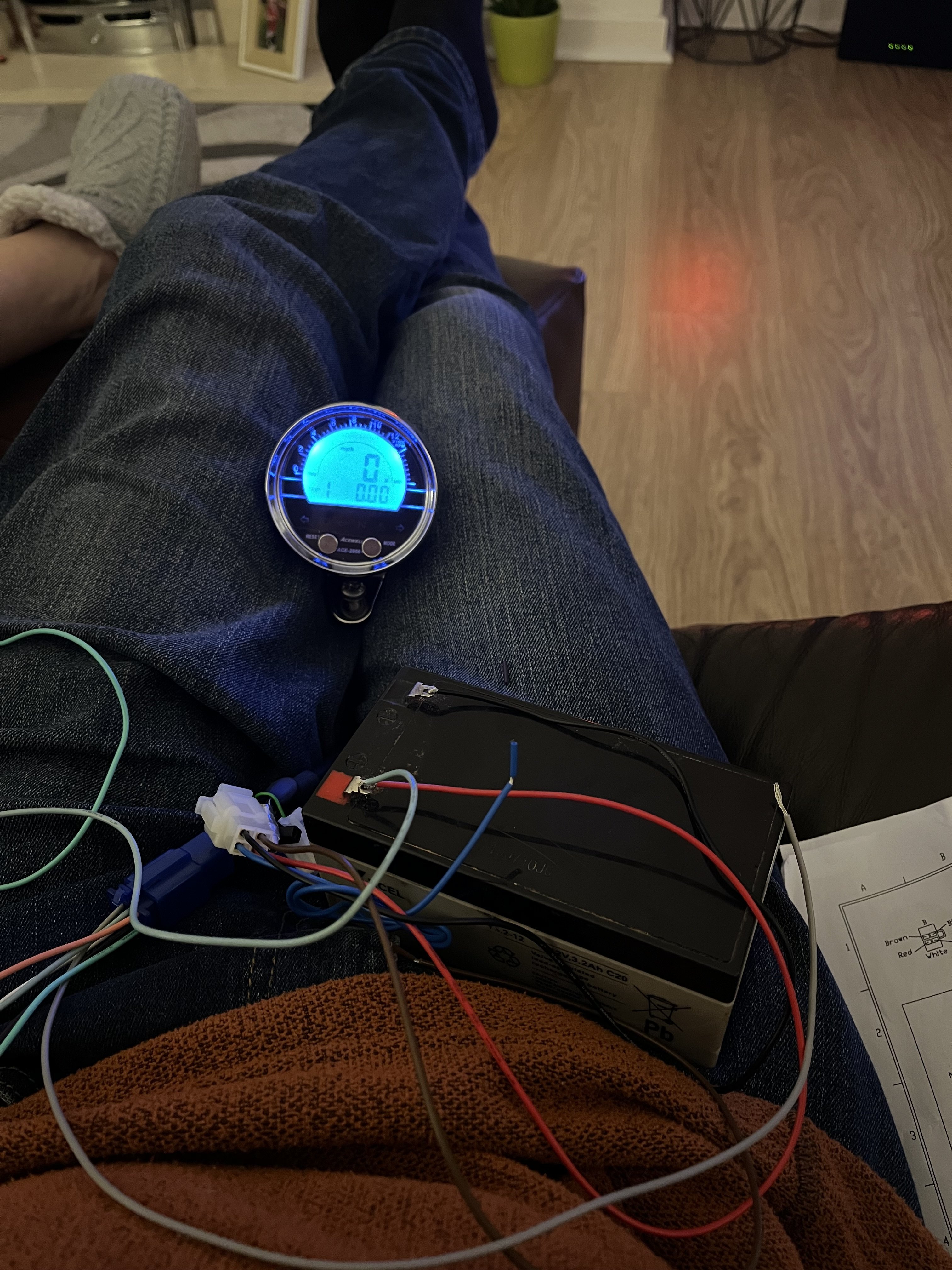

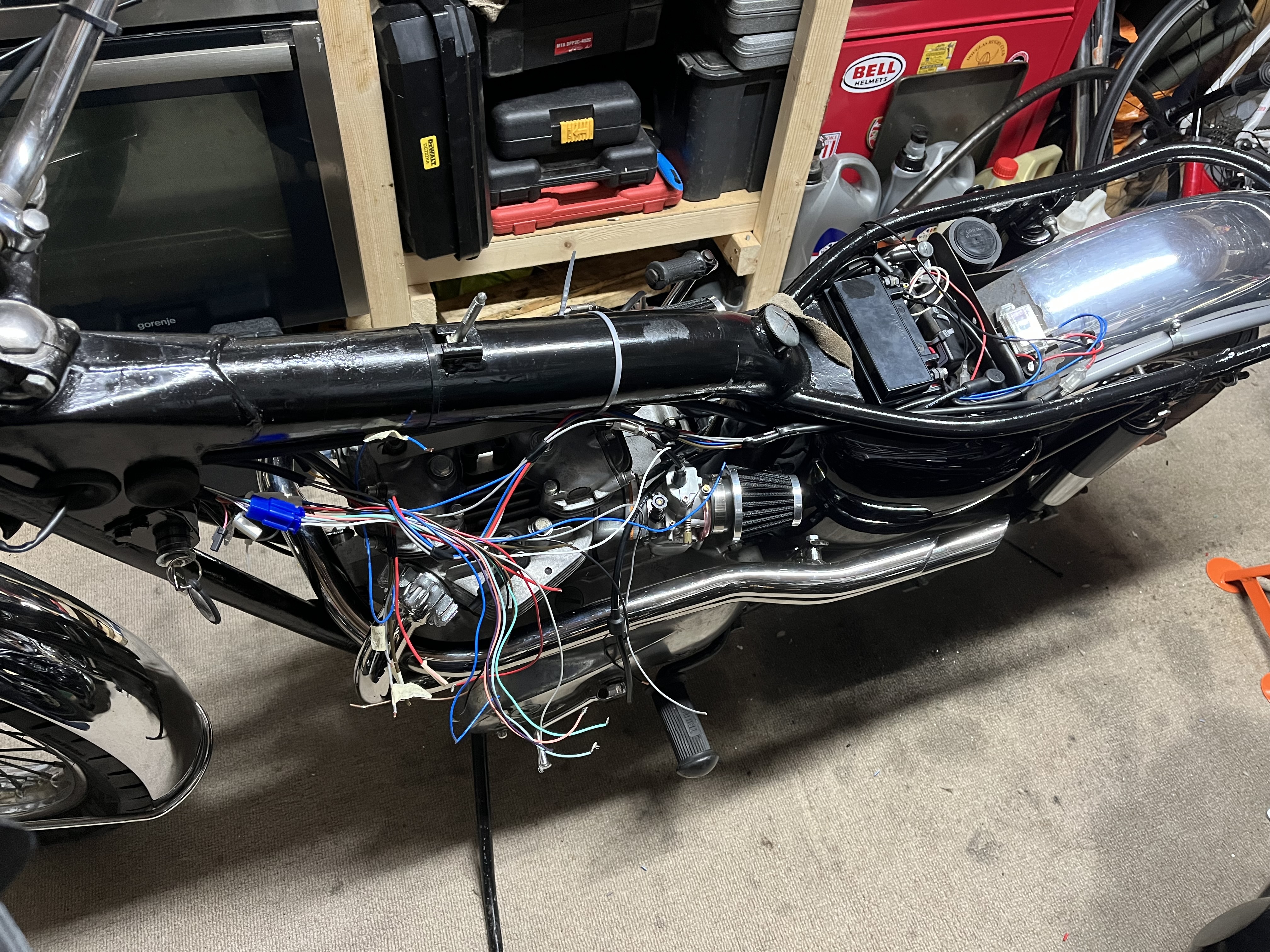

    I have just rewired my 1976 T140v and I decided to go negative earth because that’s what my tiny brain understands. It was pretty straightforward really, If you go to this page there is a layout for an A65 https://rupesrewires.com/classic-bike-24/
    which is pretty much what I used, although I kept the original two-wire alternator. I used an Acewell Speedo/tacho unit too which works well, but mine isn’t standard. Good luck!

    I actually quite enjoyed doing the rewire, which surprised me as I’m more of a spanner and hammer type of guy
