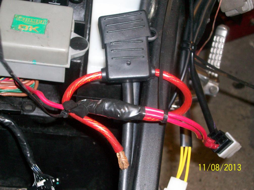

    Hi All
    have an electrical issue that need some input, purchased a 955 2004 and have noticed burnt wiring coming out of the rectifier ( see photos) I have looked at replacing the unit but when looking at the replacement the wiring looks different, the one on the bike has 2 earth wires on it which don't show on the replacement, also it looks like someone has put a wiring adapter of some sort ( see photos) straight to the fuse box, I have not a clue about wiring and don't want to continue. If you can check out the photos and see if this looks normal
    Regards
    Tony

  2. A.Larkin
    A.Larkin New Member
    Aug 9, 2013
    is there no one on here who wants to hazard a guess at what this guy has done to this rectifier, looks like he has run a feed straight from the rectifier to the battery, why he would do this I don't know?

  6. pizzaman
    pizzaman New Member
    Sep 13, 2013
    Hi There
    It looks like someone has tried to do the rectifier mod as recommended/suggested for the rubbish Triumph rectifier - I've had mine melt on me - over at the Triumphrat.net site.
    Charging System Diagnostics - Rectifier/Regulator Upgrade - Triumph Forum: Triumph Rat Motorcycle Forums
    Hope that helps?
  7. fraser
    fraser Active Member
    Apr 12, 2013
    105
    Bishopbriggs
    check out tigertriple.com and search for regulator mod by sasquatch should be helpful
  8. A.Larkin
    A.Larkin New Member
    Aug 9, 2013
    Thanks for the replies guys, have chopped out all the wiring mod this idiot did and have gone back to the original setup via the fuse box, am now getting 14.3v at the battery which I believe is the correct voltage to have.
