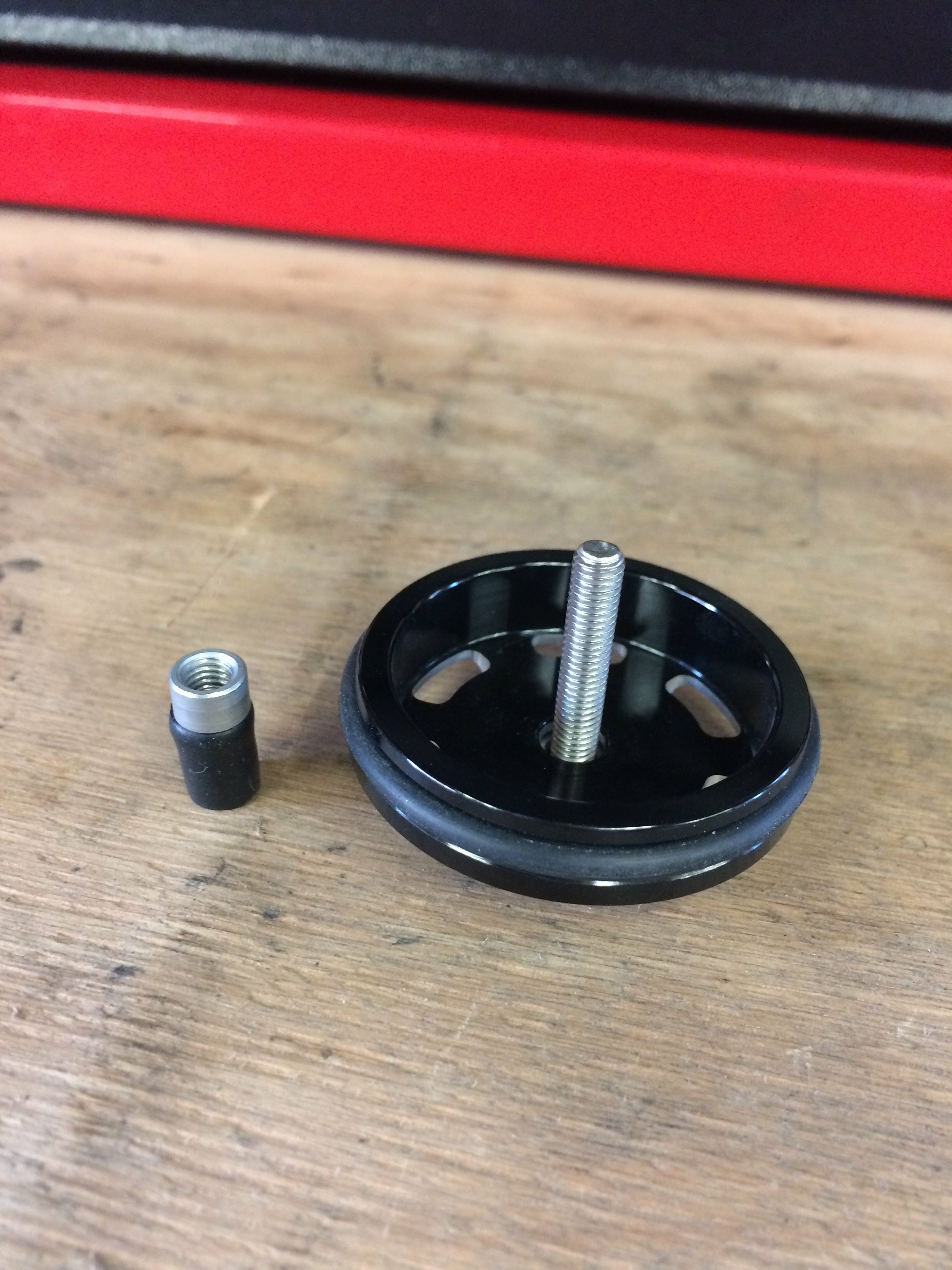

    Can't seem to screw one of them in. I then needed to fish out throttle silver threaded piece with wire. .I question is should the silver threaded piece be located inside the hollow rubber tube?

    Northwich
