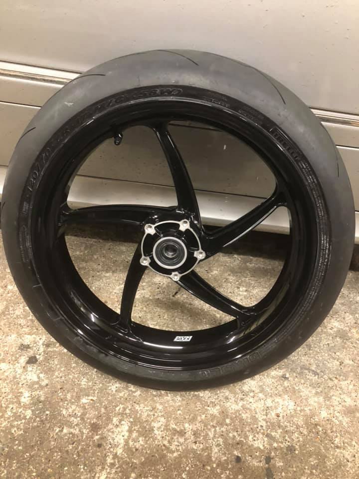

    Hi Guys,
    Just wondering if anyone else has done this yet or if I am going to be the first?
    Im pretty determined so watch this space!!

    Thanks Gents.
    None of these are however the RS.
    There are a number of differences for the front wheel which, once I have worked out the way around it, I will share with the group.

    The RS front wheel has almost everything in common with a standard 2012 model wheel. Spindle,spacers,circlip,bearings ect, are all the same.
    Thant being said.
    The only common part to the R spec PVM wheel setup, is the spindle, you will need everything else.
  10. Burny_13
    Burny_13 Active Member
    Jun 16, 2019
    67
    Reading
    The spacers are the same ID and length, only the OD is different, so I have bought some seals to suit. (£2.99 each vs £14 each from triumph)
    I did the same with the bearings, I have bought Koyo items based on the right size. (£3.99 each rather than £25 each from triumph)
    The ABS ring is also different too, thats a mine field but im pretty sure I have resolved that. Just waiting on my new disks to arrive for a final test fit to confirm that one.
    My spacers and circlip came with the wheel (so did bearings and seals but I always fit new on second hand parts)

    by way of an update. It fits! and the ABS works too.
  14. Burny_13
    Jun 16, 2019
    67
    Reading
    So its all done, and the numbers are in too...
    Front wheel is 640g lighter than stock.
    Rear wheel is 1050g lighter than stock.
    Looks great too...

    The standard RS discs are still sunstars.... I now have brembo series oro. They are the ones to suit the 2012 R and fit the PVM's. The only difference is the offset, everything else is the same.
