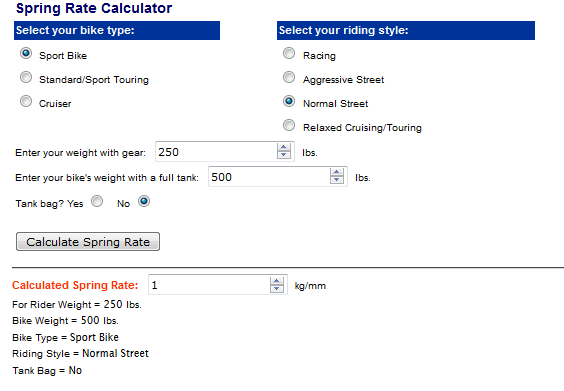

    I am 16st (all muscle o_O) and in full leathers the suspension at the front is too soft - I have a zip tie on the front and it bottoms out each ride on the road with preload almost at maximum
    The front springs are 9 N/mm and using an online calculator for my weight and bike weight I should have 10 N/mm fitted
    http://sonicsprings.com/catalog/calculate_spring_rate.php
    Weight with gear value = me plus leathers, helmet etc
    Bike weight is dry weight plus an estimate for oil, coolant, and fuel etc.- plus any baggage
    1 kg/mm = 10 N/mm
