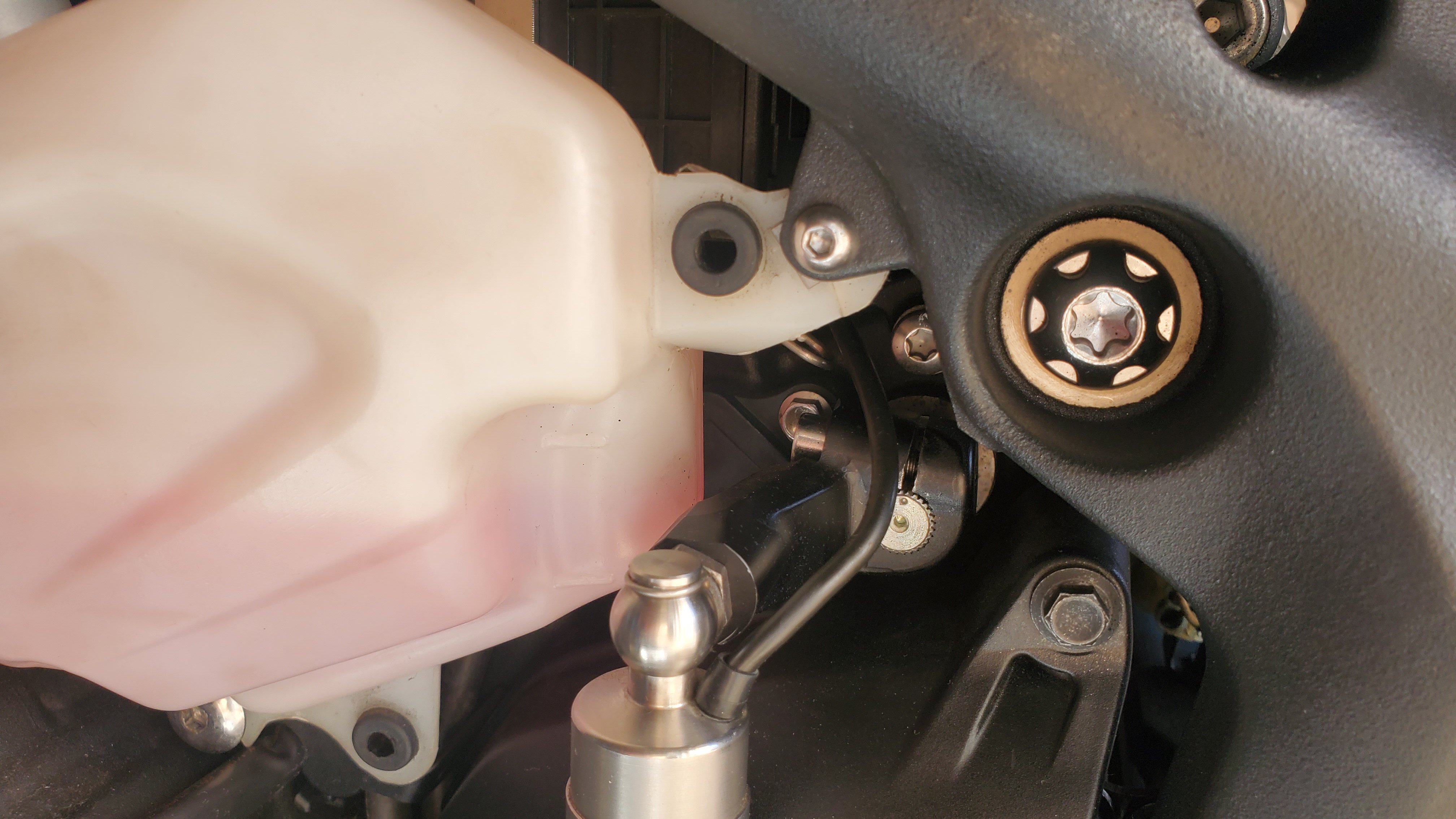

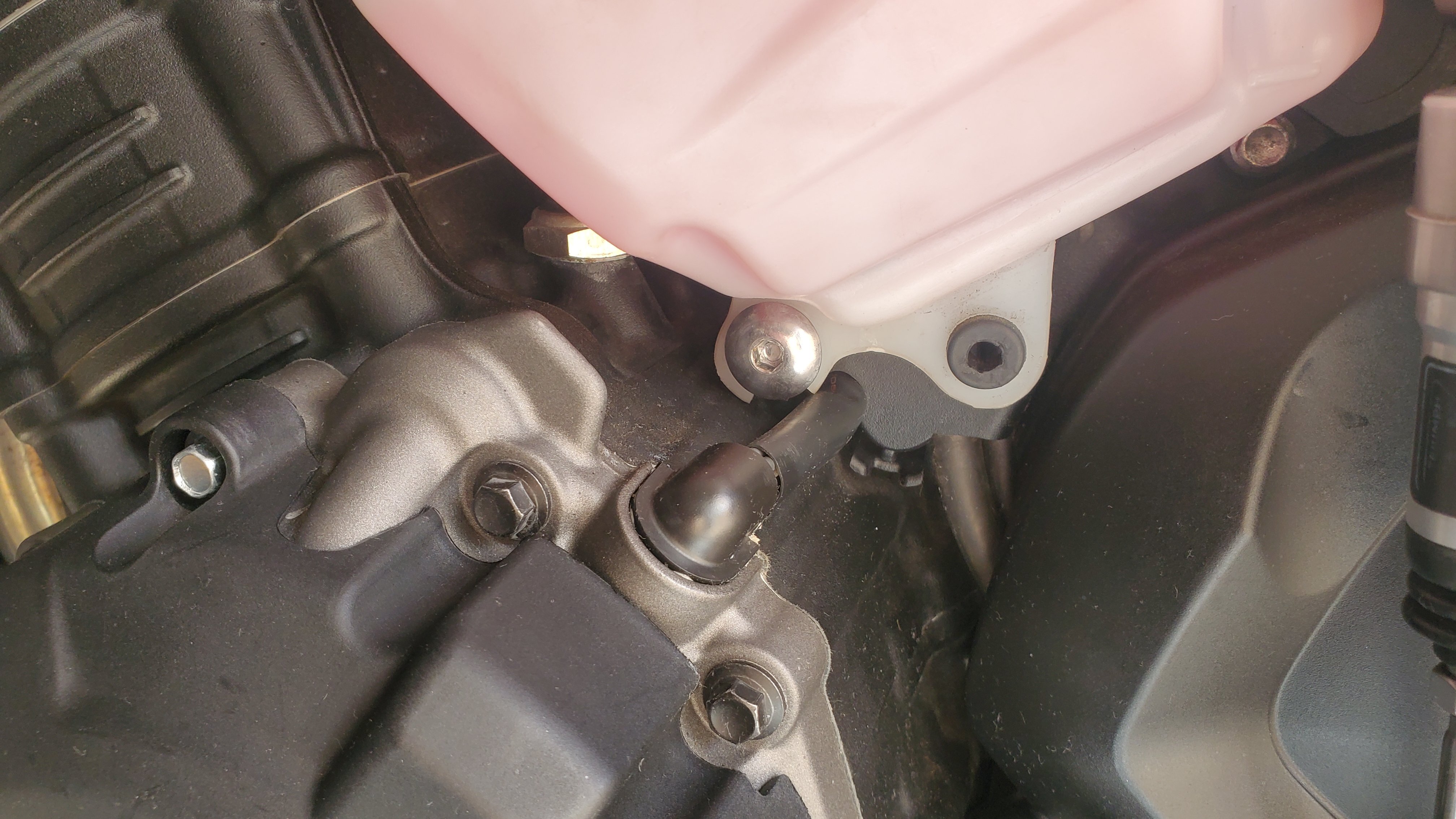

    BINGO! I removed the expansion tank cap, unscrewed 2 expansion tank bolts and saw the problem. The quickshifter wire and quickshifter connector were lying behind the wires and were pressed against the engine. The connector itself was without external insulation, the wires were partially without black electrical tape.
    I disconnected the connector and re-routed the wire to the outside of the engine. I treated the connector with alcohol and pressed the contacts with a toothpick. After that, I wrapped the wires and connector with black electrical tape. The old electrical tape was hard and had traces of overheating. Reassembly in reverse order. I suspect that high temperature, kinking of the wire, overheating of the connector itself and vibration could have led to loss of contact. The three contacts themselves are very thin and there is room for deformation inside the connector contact itself.
    I am writing all this because for the second day now I have had no errors and the quickshifter works without failures.
