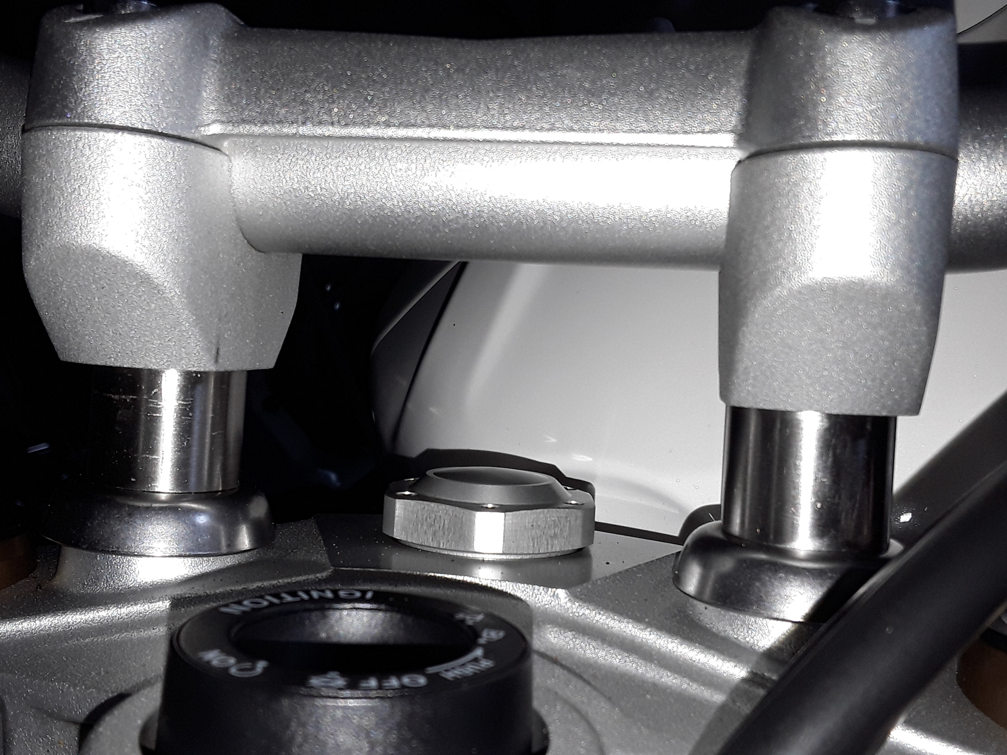

    I have Done this to my Speed Triple last year. I saw this on this forum .
    25 mm that's what I went for.
    Stopped the numb fingers i was getting on the dual carriageway to work.
    Easy fix
    Dave

    not any different from whats there apart from the longer spacers

    best part of £100 quid for 2 spacers + longer bolts
  7. Davie_M
    Davie_M Active Member
    Jan 24, 2017
    128
    Hamilton
    2011 Speed triple
    https://www.fowlersparts.co.uk/part...461332-to-vin-735437/high-handlebars-switches
    just a matter of fitting the spacers between parts 23 and 24 plus a longer bolts part 4 to allow for the spacer
    exactly the same as the commercial kits available perfectly safe

    Yes it works i bought some for my 12 plate, 25 mm is about all you'll get without changing the cables mate but it Worked a treat. :laughing:

    All the bits cost about a £10, just make sure you get a hand holding the bars, it take minutes to do.

    Looks good, although I think the diameter needs to be larger. These look a little thin.

    25 mm that's the diameter of my ones any bigger would be sticking out the sides.

    Yup, fits well. Looking good.

    As per stroods pic, front view looks completely different that mine "side on", I was going to sleeve the spaces with 32mm plastic but triumph released the speed rs so just traded it instead :joy:

    I've got some 30mm stainless bar, might turn some up and get some high tensile bolts from allfix.
