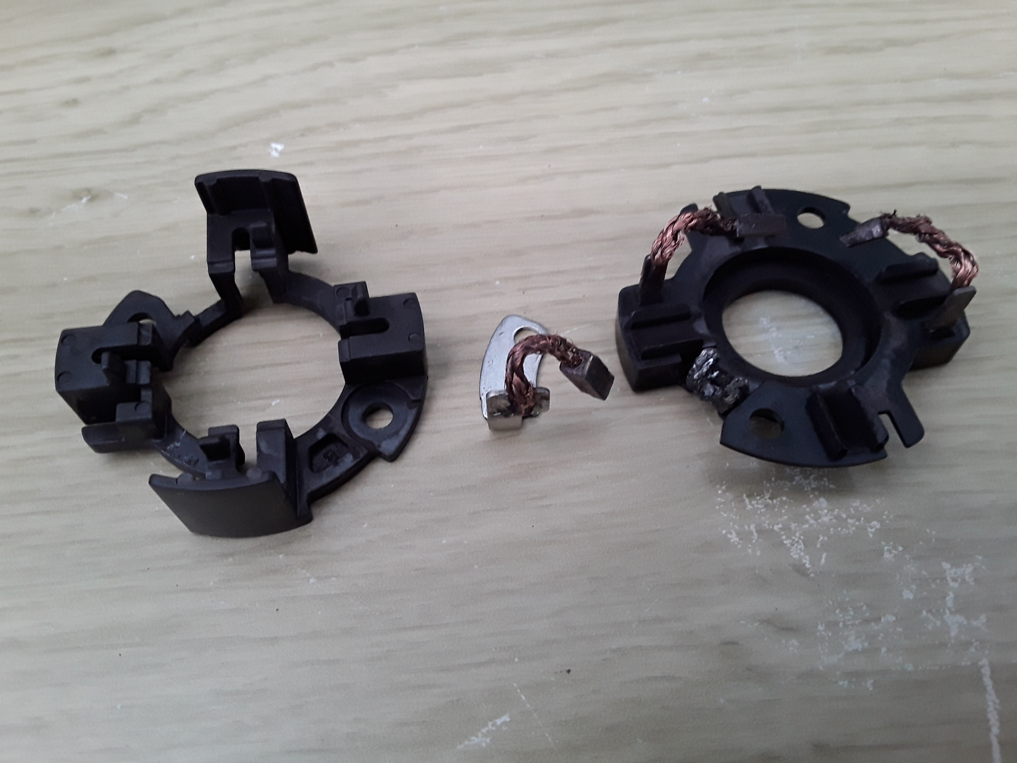

  6. Chris Ryder
    Chris Ryder Member
    May 10, 2019
    19
    Blackpool
    ,starter motor brushes and brush holder and an insulator thingy . All worn causing starting problems .
