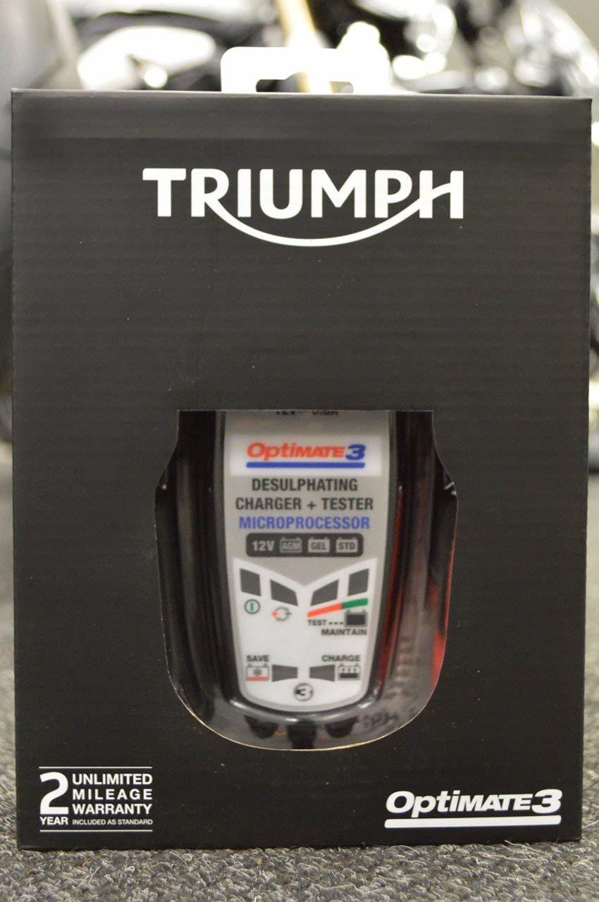

  1. David Cooper
    I've been advised to keep my battery tethered to an optimate 3 charger, is this good advice, and should it be left on all the time the bikes not been used.

    Today's bikes with immobilized ignition and alarms - drain battery real quick if not used. Optimate keeps the battery at it's peak.

    I understand you... my hand also always goes quicker to the wallet than my brain process the buy.... But I have the 4 and it is an excellent product. While using my T100 (daily) I keep it charging my Honda 400 SW scooter (poor thing it never rode again since i got the Triumph) while on vacations or long weekends apart from the T100 (lonely weekends for my poor T100) I plug it on the T100. Great buy

    A lot depends on your battery and what you've got fitted to your bike. As others have said, alarms and gadgets will drain a battery. If there's nothing draining juice then it's down to the battery. As an example the battery on my 1250 Bandit has never had an Optimate or any other "battery optimiser" connected to it, yet if you leave it for three months in the dead of winter it will then start at the touch of a button. If you have a battery that's come with a new Triumph bike like most of us on here, it's going to be dead in a few weeks. By the way, the battery on my Bandit is at least four years old.

    I use something similar..... a $30 4-step, 12v, 750mA Battery Tender brand charger that monitors and keeps battery fully charged when the bike is not in use. Keeping the battery fully charged when not in use helps prevent sulfating and subsequent battery degradation.

    As others have said, yes and yes.

    Just plug the bloody thing into the battery when you are not using it & then forget about it .
