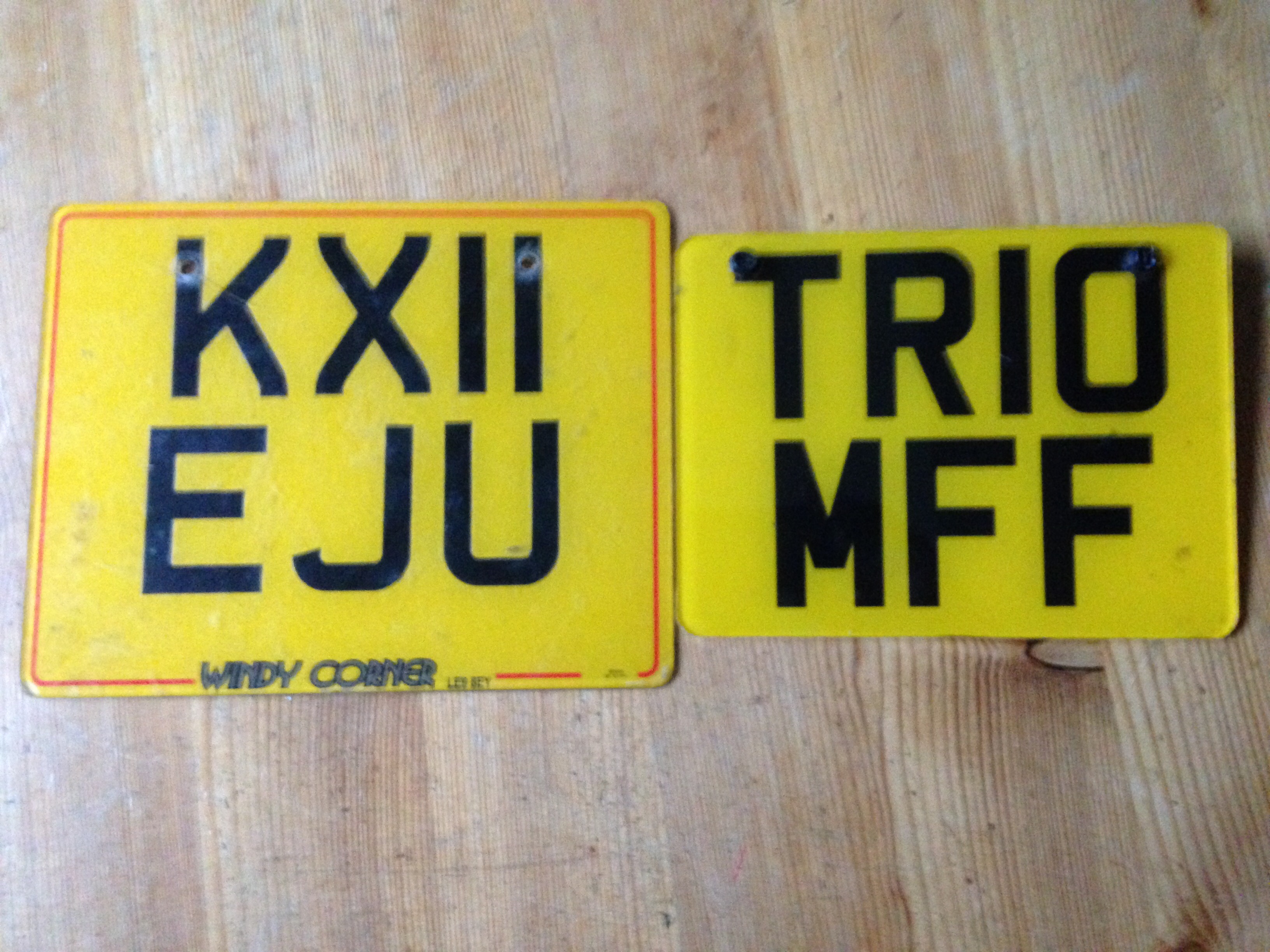

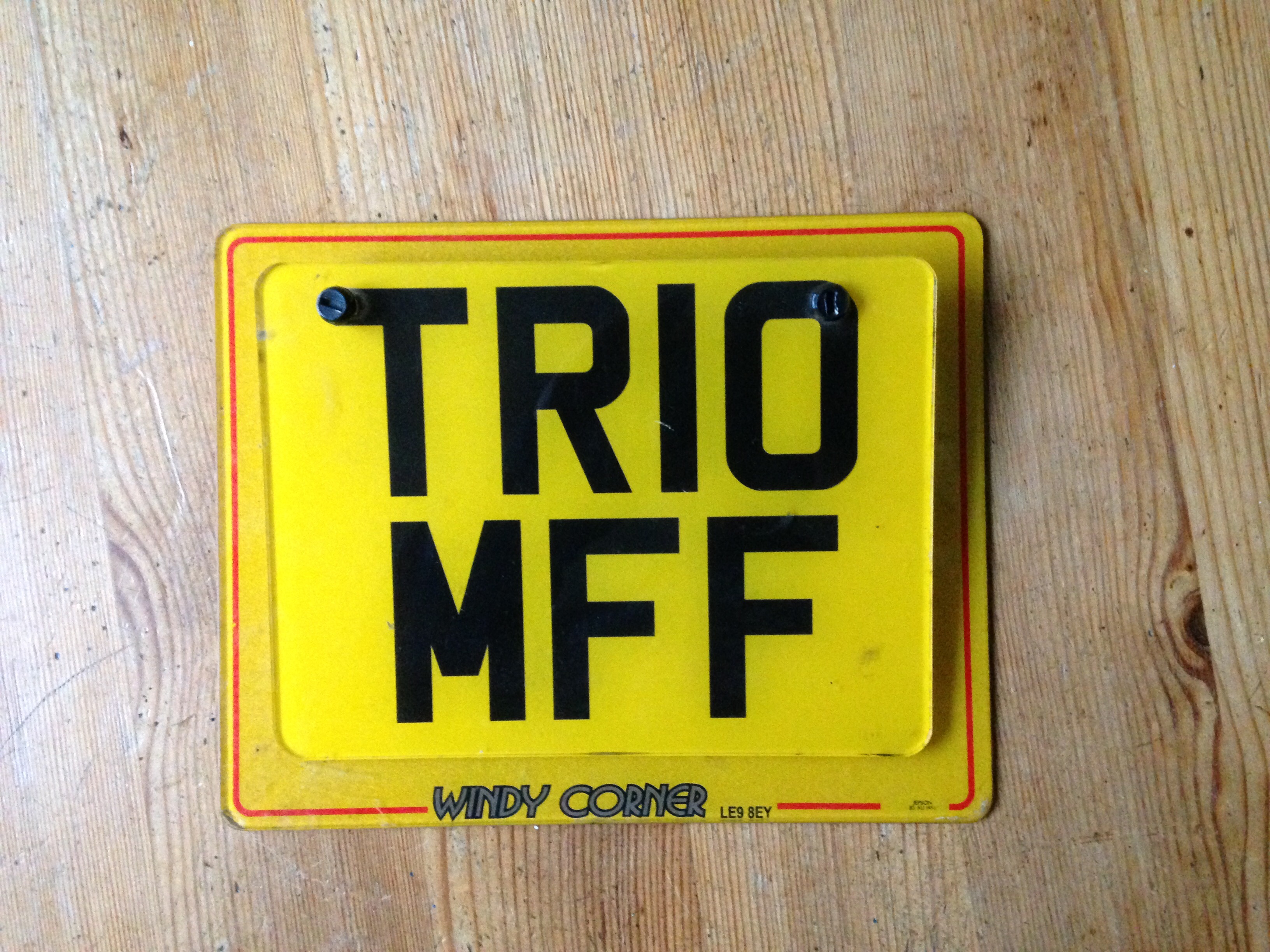

    heres a comparison for you the large plate(legal) is 8.5 x 9.5 the smaller one (cough cough) is 6 x 8 the letters are the same 2.5 inches high
    The larger size looks stupid if you have a tail tidy on

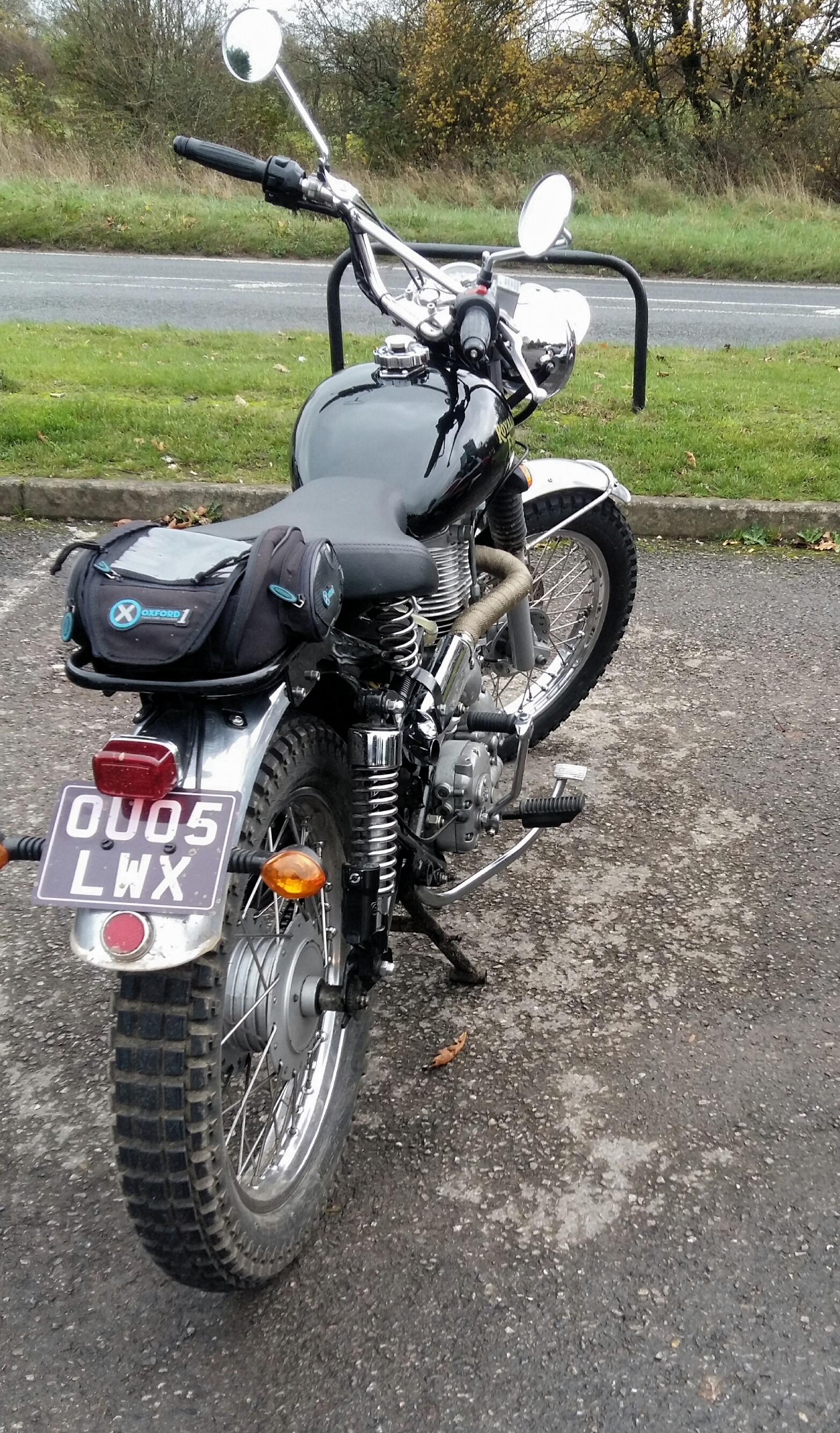

    I've even been getting away with a cheeky black and silver one! 2015-11-12 16.54.15.jpg

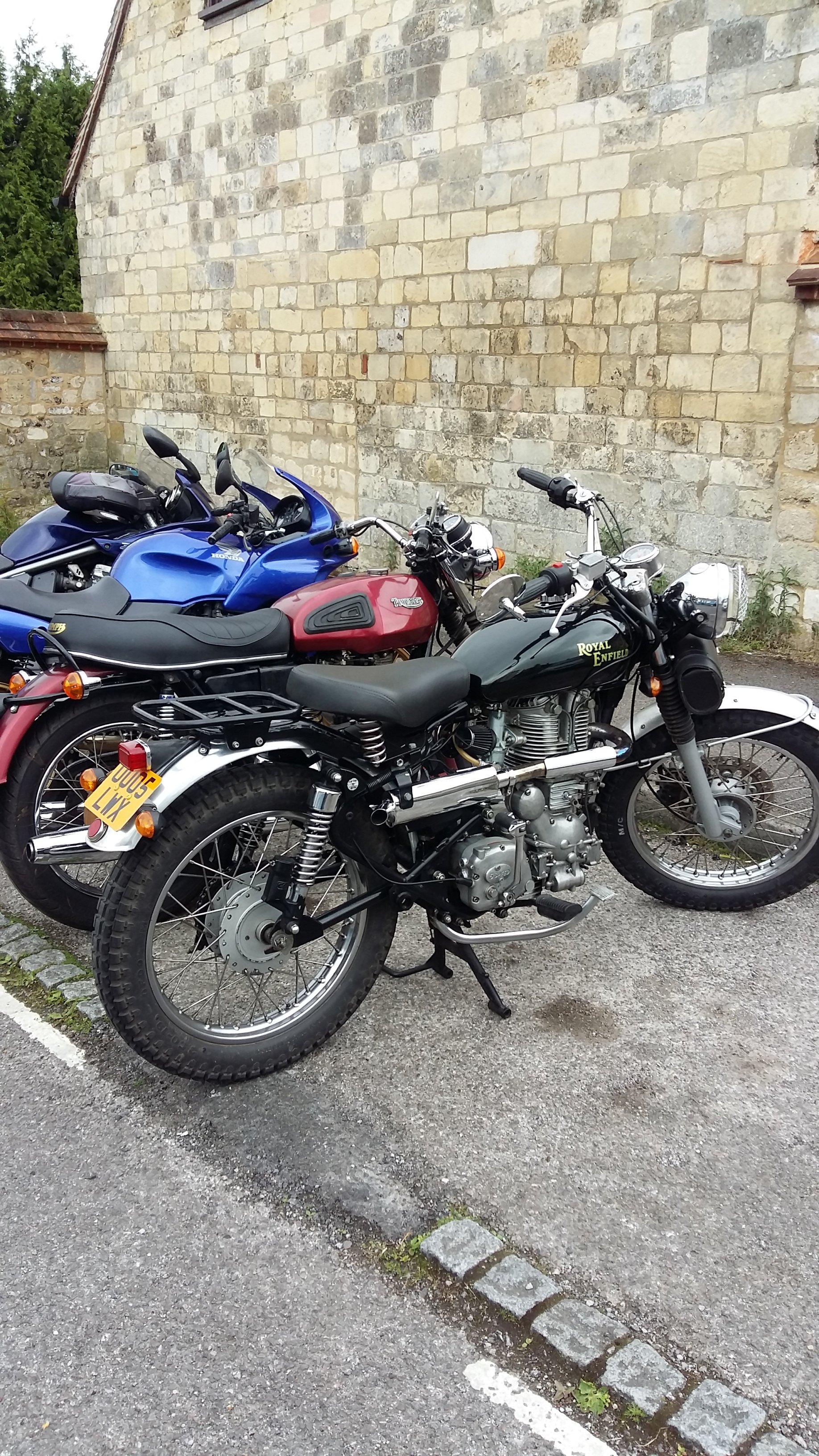

    Although I removed the black and silver plate for the MOT today - the Enfield passed with it's 7 x 5 yellow plate and virtually un- 2016-06-02 12.36.45.jpg silenced exhaust.

    Nice ride your Enfield.
  19. steve lovatt
    9,217
    It's going to be a Scrambler when it grows up!
