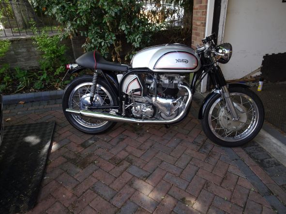

    Oh dear I think that I am going to be hated even more, sorry and apologies to administration but this is a N****n o_O
