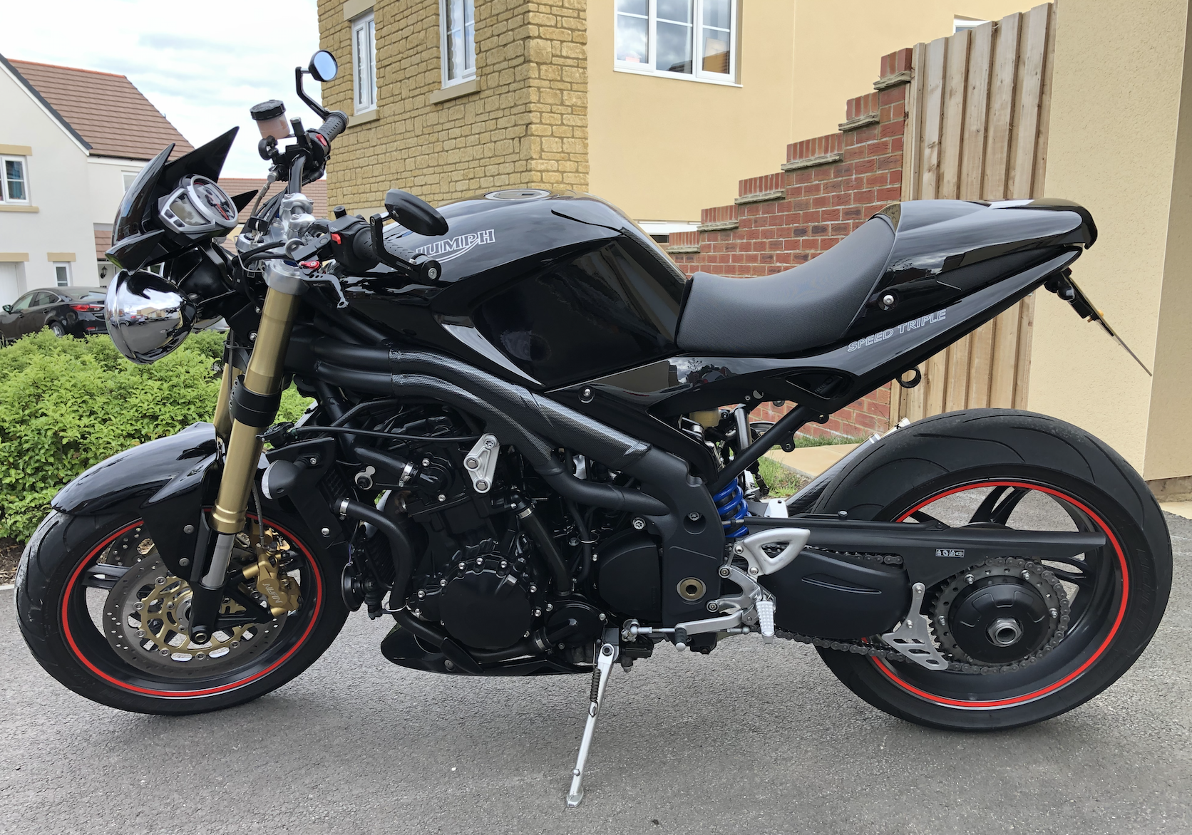

    Hi all, I'm new to naked bikes but love my Speed Triple. It's in such good knick I forget it's a 14 year old bike. I therefore may need some tips to keep it in good shape.

    Hi matey and welcome in. My speedie is older than yours but love it to pieces. Pics are compulsory or it isn't yours. Lol
  6. Tim Gates

    There you go...

    Hi and welcome. Excellent vintage!

    Hi, welcome, she looks incredible for her age, happy riding :)

    Wow, she is a fine specimen. Oh and welcome.

    Welcome aboard Tim, hope you enjoy the forum, cracking looking Speedy you have there, enjoy.

    Looks pristine for 14 years old !
