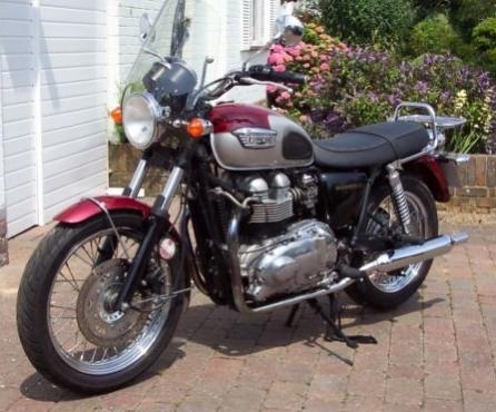

    Hi Everyone, and thanks to all those who helped me decide what to get.
    In the end I got a 2001 Bonnie, and so far I'm kinda loving it. I haven't done all that many miles on it yet, and I'm mainly crawling round London a couple of times a week. But this weekend I will give it a good blast to Dorset and back.
    Picture attached - I think, if I've done it right...
    However I have a possible problem right now. This morning, I found it difficult to start. It did start fine in the end, but it required 6 or 7 attempts. The choke was fully out (I have read this is normally required even in good weather), but I did try half-out once or twice as well. In the past couple of weeks, it's generally started OK but often not first time. My concern is that the weather is currently glorious so I am thinking how bad is this going to get when it turns cold?
    I was on the reserve tank to begin with this morning, but it was nowhere near dry (only just dipped into reserve at end of last ride). I keep the bike outside under a cover - I have no garage.
    Can you tell me if my experience is normal, and if it will get harder in cold weather? Should I take it for a service? It seems to have been well maintained by the last owner who had several classics he was working on. If I take it for a service, what sort of things can they do to make it a good starter?
    Thanks all!
