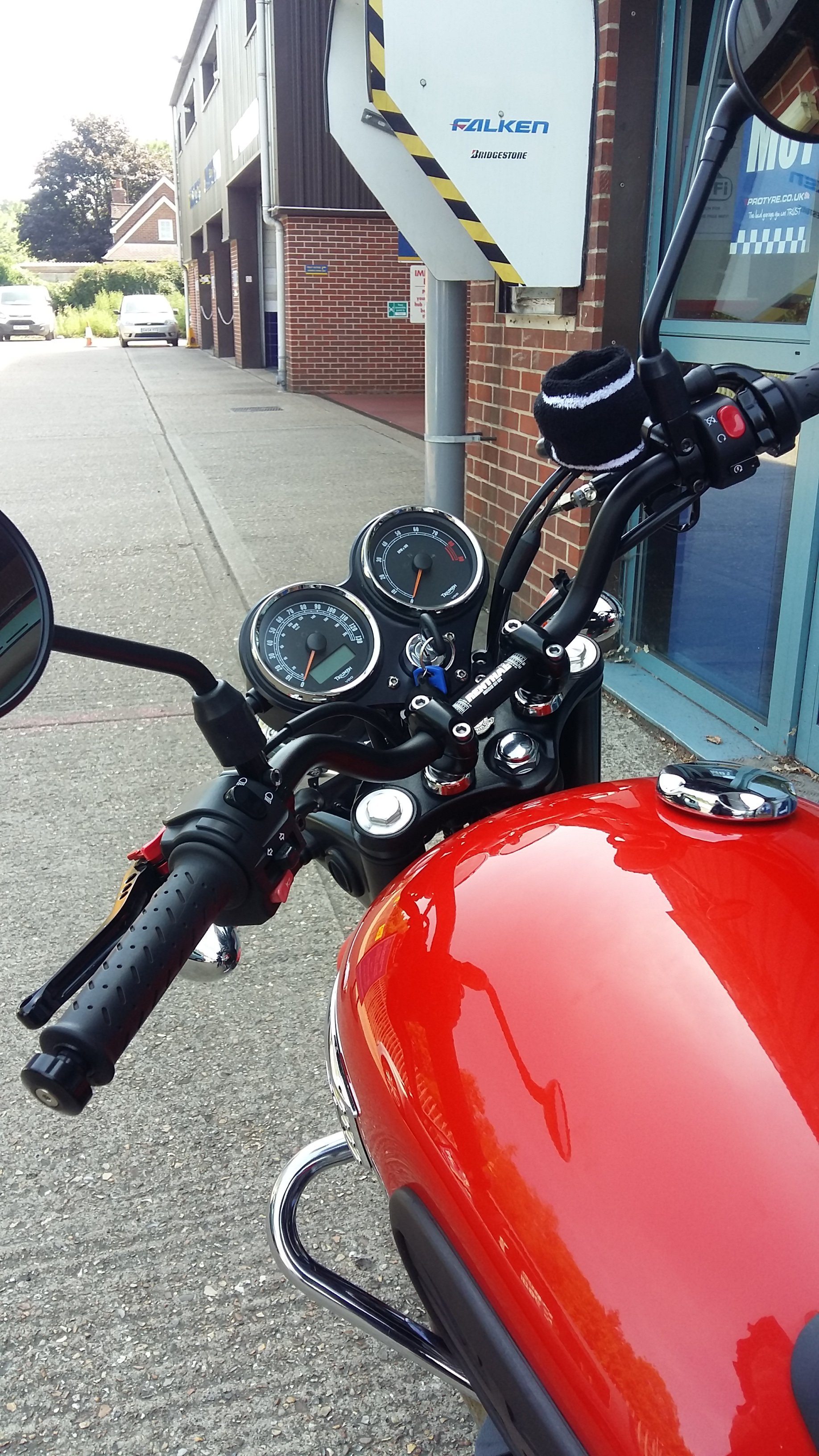

  2. steve lovatt
    9,216
    This is where it should be I think - hence the modification on my Bonneville.
